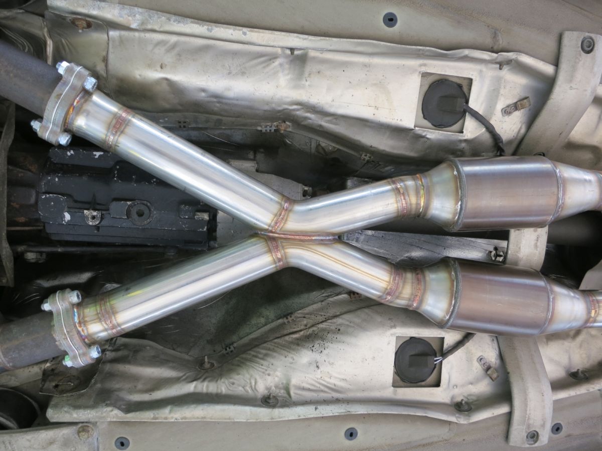

Thanks Goran. Who did the work for You in these pictures? The welding looks top quality.

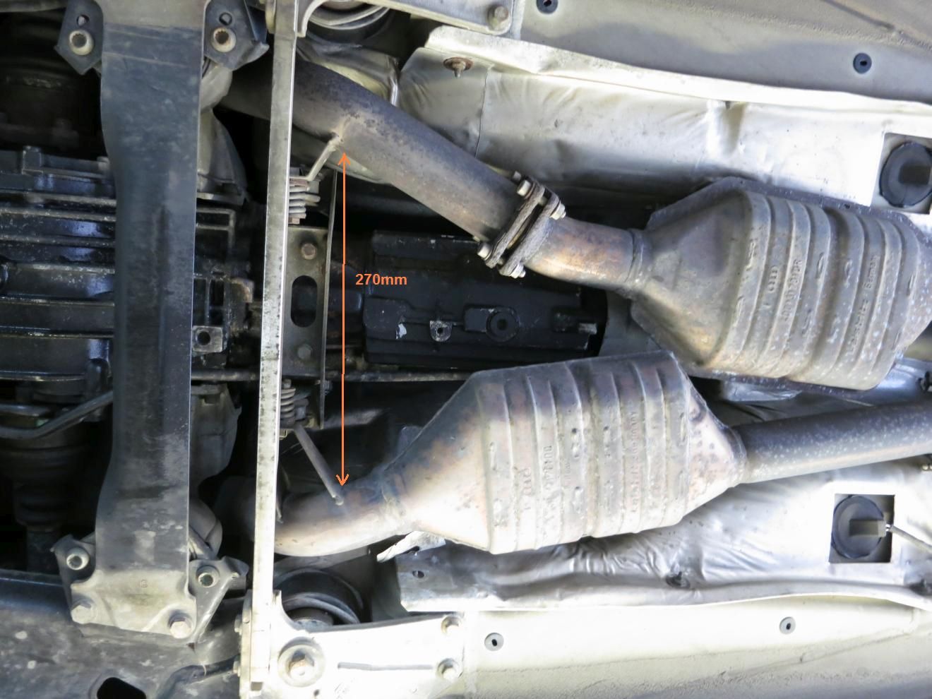

This is how stock cats look on a LHD S8, the RHD is almost identical.
These are the HJS cats, this is the better with both brackets easily accessed from underneath no need to remove the downpipe and front lambda.
Mossy
It was Mike Edwards of Edwards Motorsport. He has moved to Wisbech now and has a proper workshop with 4-post lifts etc. And a mandrel bender of course!
Can't recommend him highly enough. He mostly does motorsport exhaust so he knows his stuff. He is very friendly and will work with you even if you are very particular about how you want it done (ie, like me )
He used to work for BTB Exhausts who have quite a reputation apparently. I did approach them first but they wanted between £3000 to £4500 to do my exhaust!
http://www.btbexhausts.co.uk/
So when I searched a bit on Pistonheads and other forums I found loads of recommendations for Mike and that he used to work at BTB, so I thought I may as well get the same high skills for a 1/4 of the price.

Ok great! So how much was the whole job parts and labour in the end?

The whole exhaust without cats was £1300, but that's because I wanted the same diameter pipes as stock which had to be ordered from the USA, and also because I was a bit nitpicky about the exhaust tips which required extra man hours to get how I want them. I think his original quote was £800 that was with slightly larger piping he could get from the UK.
Of course add to that the price of HJS cats or cats of your choice.
