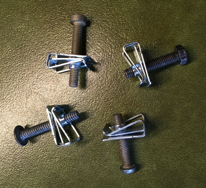

Chimney nuts have more of a thread i think, spire clips have a couple of "tags" for self tapping type screws. Have a look for rivnuts too.

One of these should do the job (maybe with a washer) when I get the new trim from our sponsors:

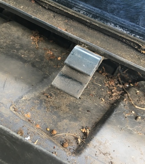

There are two C-shape holders that attach scuttle trim to aluminium lugs of the body.
Yes, I've got those on both my original and replacement panels.
They clip onto these lugs, one of mine was bent down (sorted now) so not connected and the other wasn't engaged properly either:
