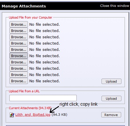

Add them all as attachments in the advanced editor. When you have uploaded them, copy the link by right clicking it, then paste it in [img] [/img] tags like this:
[img]http://forum.a8parts.co.uk/attachment.php?attachmentid=27282&stc=1&d=16341312 18[\img]
(note I've use / in the close tag so it doesn't work. Proper syntax is /img)
which then shows like this:
ID:	27282   Click image for larger version

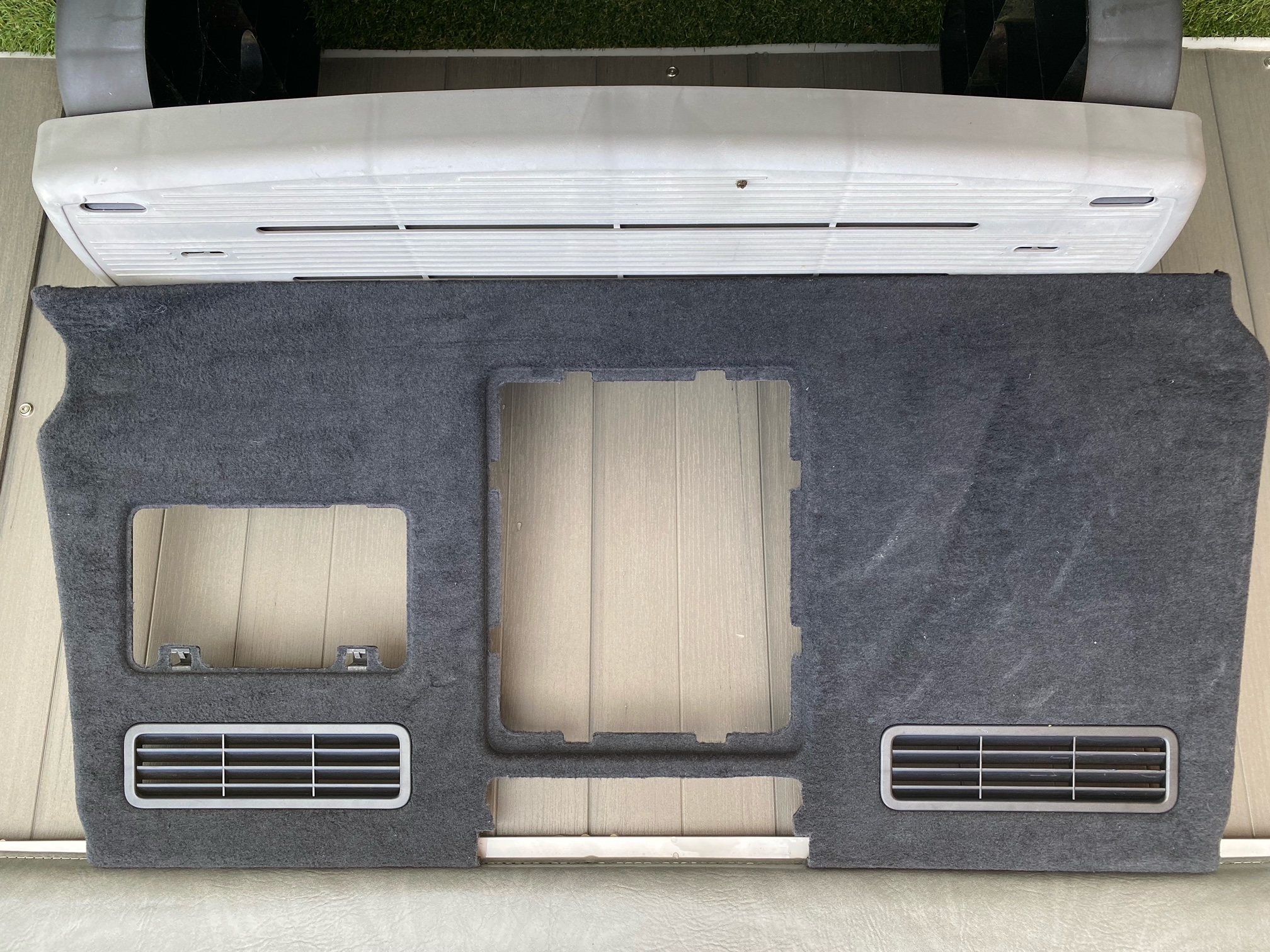

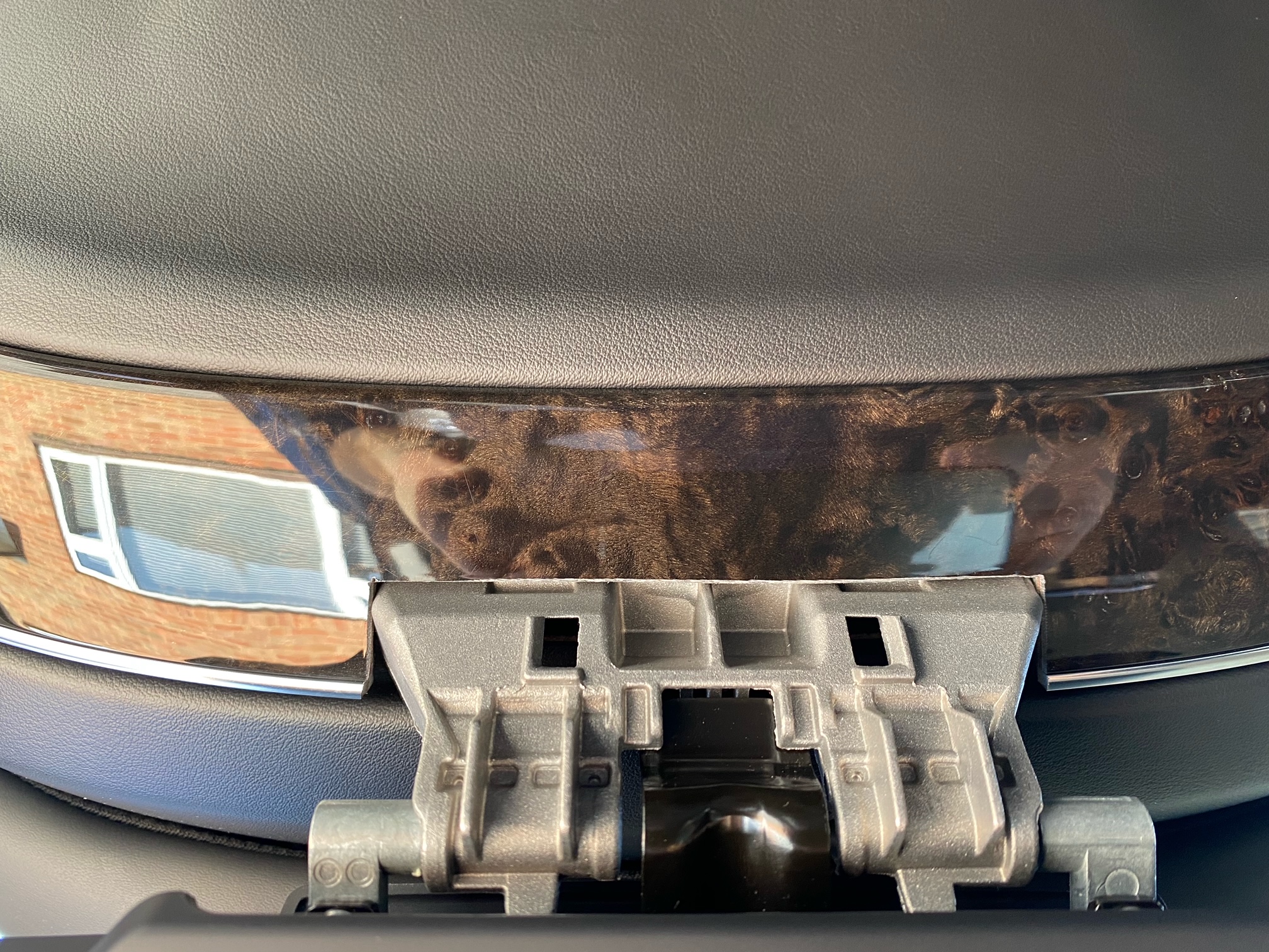

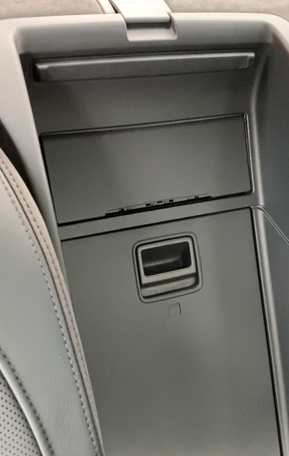

OK...thanks for the tips. Here goes. First up in chronological order of works - fitting the 7F as that should be the easiest part.
When I purchased the RSE bundle from eBay UK unusually it came with a plastic sleeve that the 7F unit slides into and the whole top trim that sits above the ski hatch.
Removing that trim is easy...just tuck your fingers into where the back of the trim sits into the parcel shelf and pull forward to disengage the two plastic legs from the metal speedclips and then pull it up and out of the way.
The replacement which has the roller shutter door can then be fitted in its place and the plastic sleeve with the 7F is slid into the opening and secured with 4 small screws.
Now you see me...
Now you don't...
Unfortunately the chrome trim strip is missing from the bottom of the roller shutter door but no great loss. I will keep my eye open for a replacement at some point though.

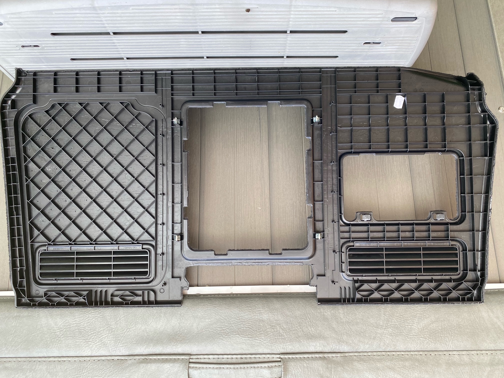

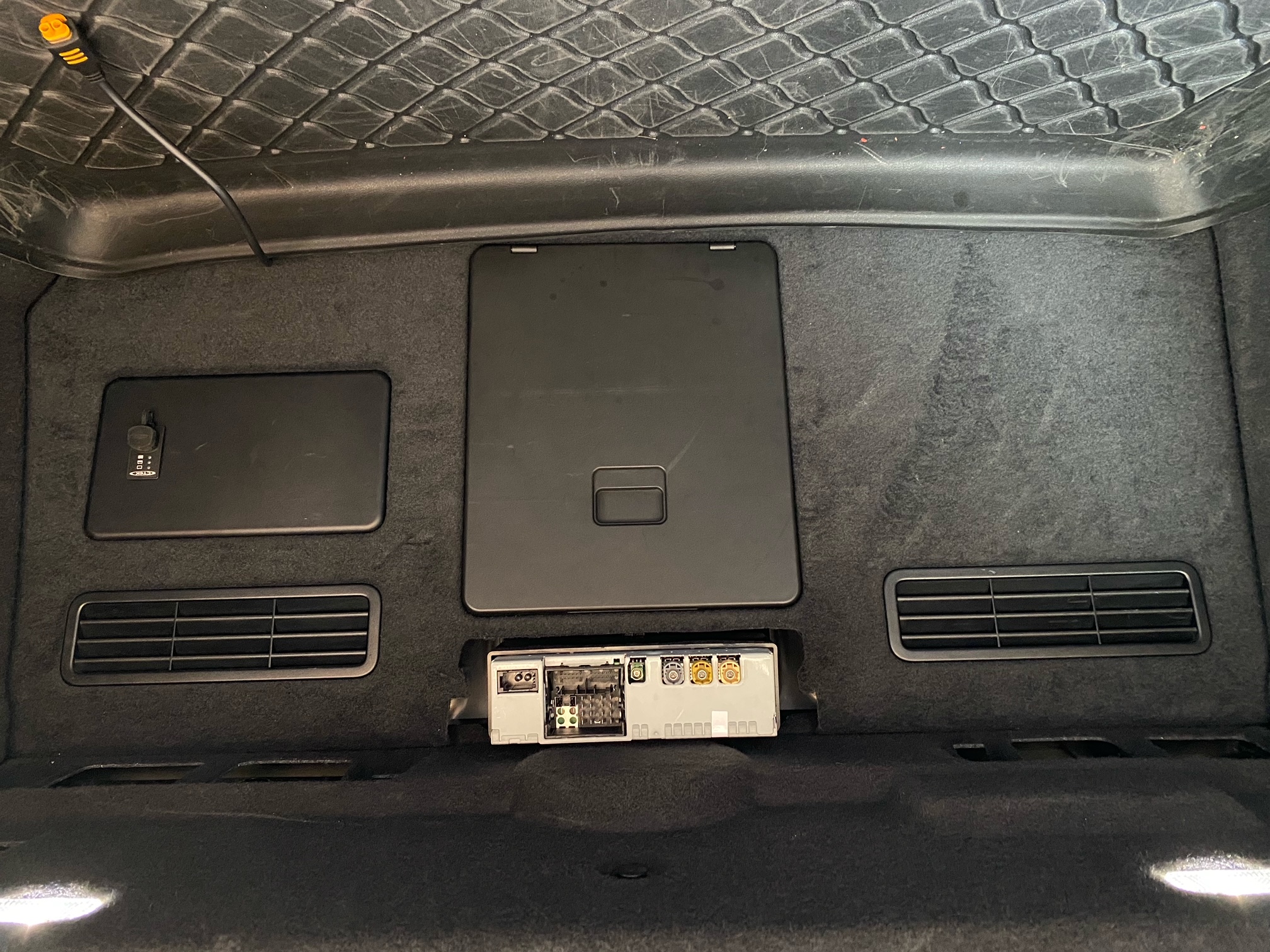

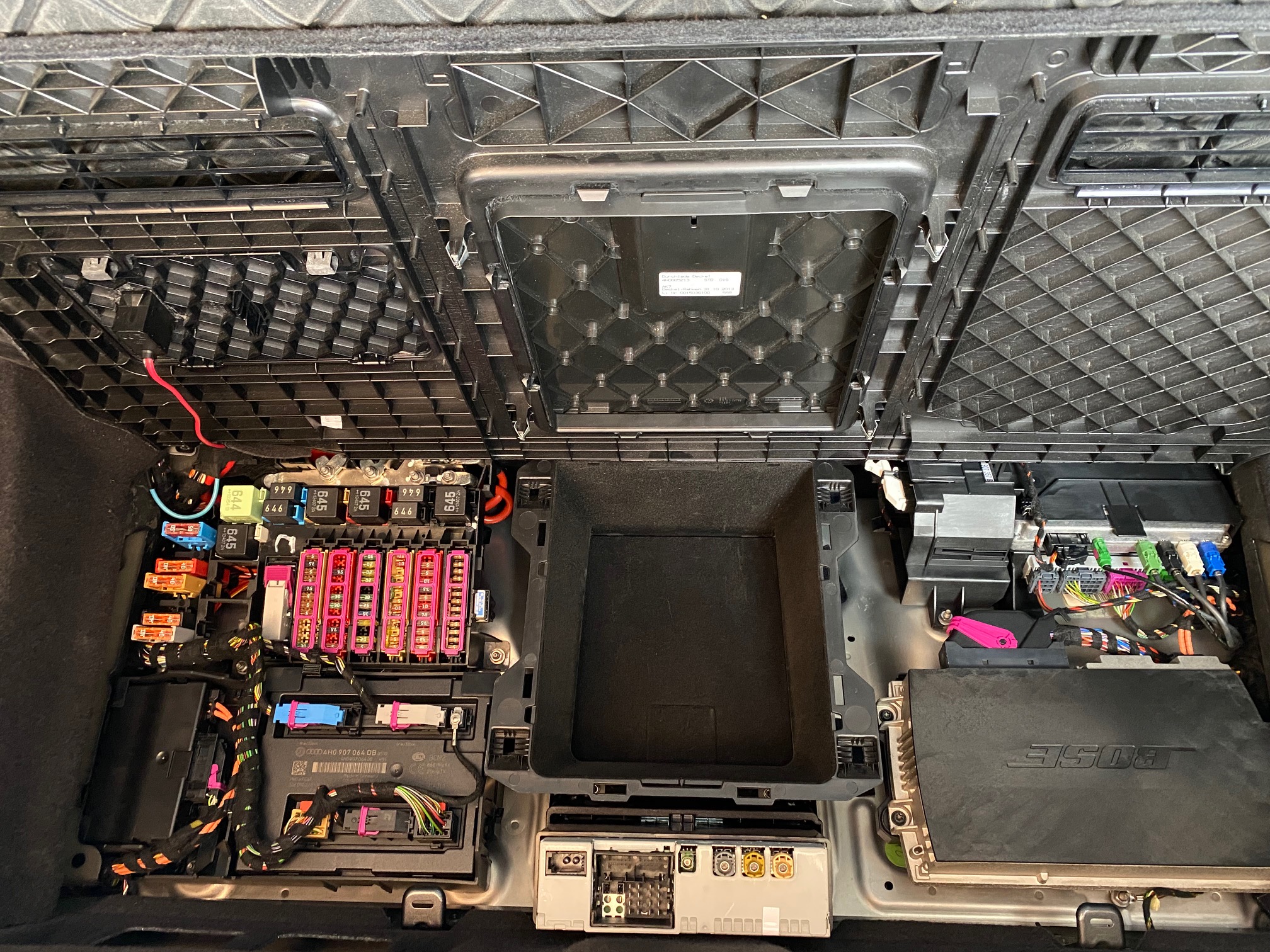

Now the 7F is in place the view from the boot looks like this;
Inside the back panel there is an outline trace of where a cut needs to be made (see above photo) so the plastic cover can be clipped and fitted into place to cover the arse end of the 7F including the wiring which when cut looks like this;
From the back - not the greatest cut in the world and I hope when it comes to cutting the wooden trim I can & will do better
From the front
And fitted in place. The £20 plastic cover is on its way from Latvia to keep things nice and tidy

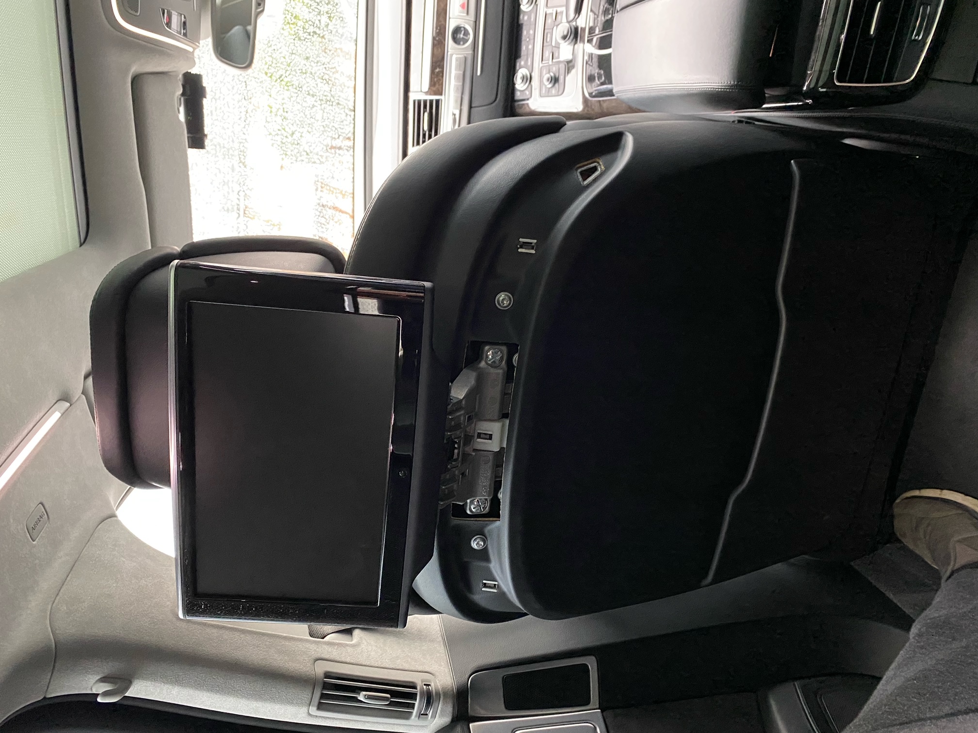

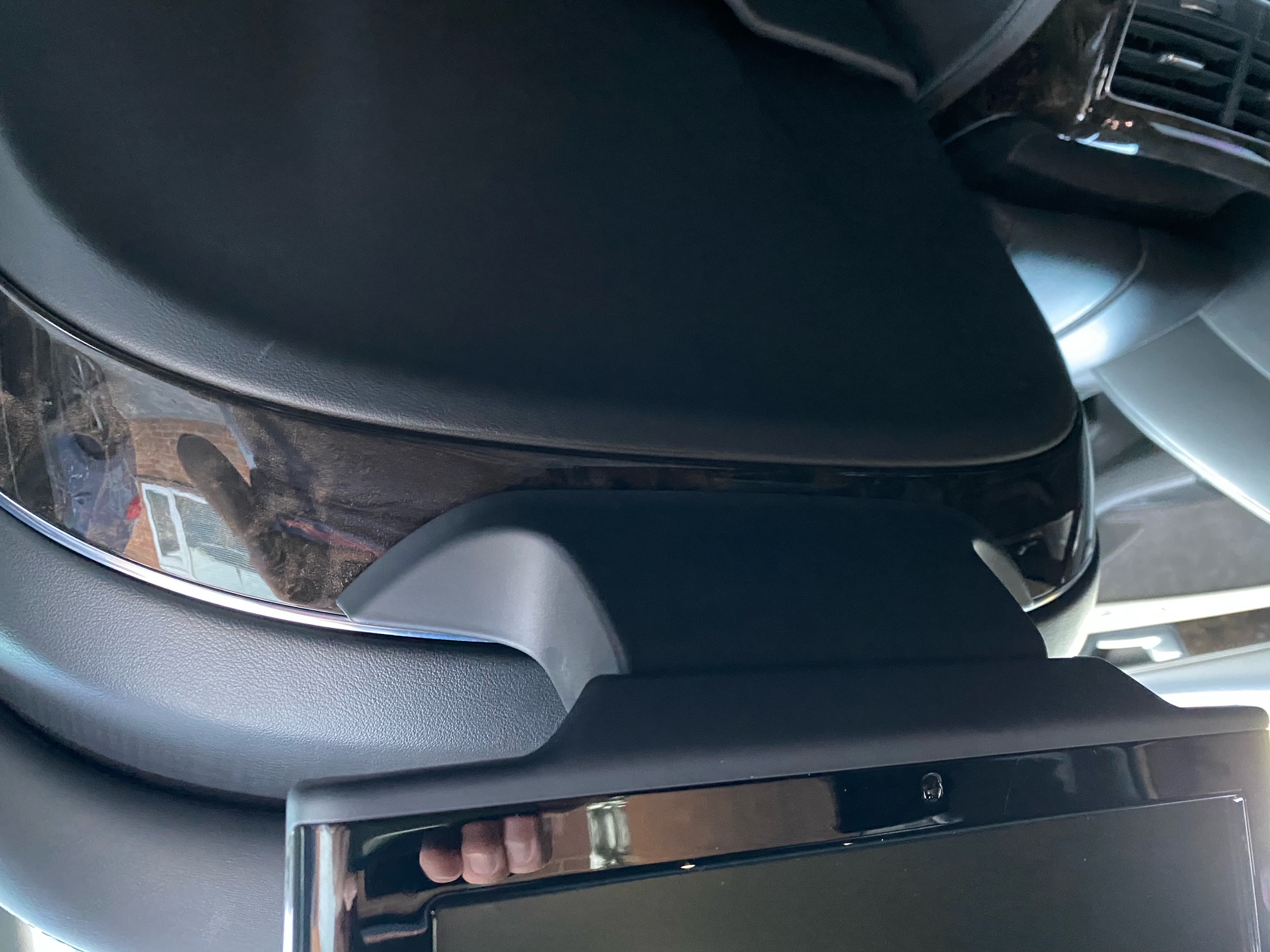

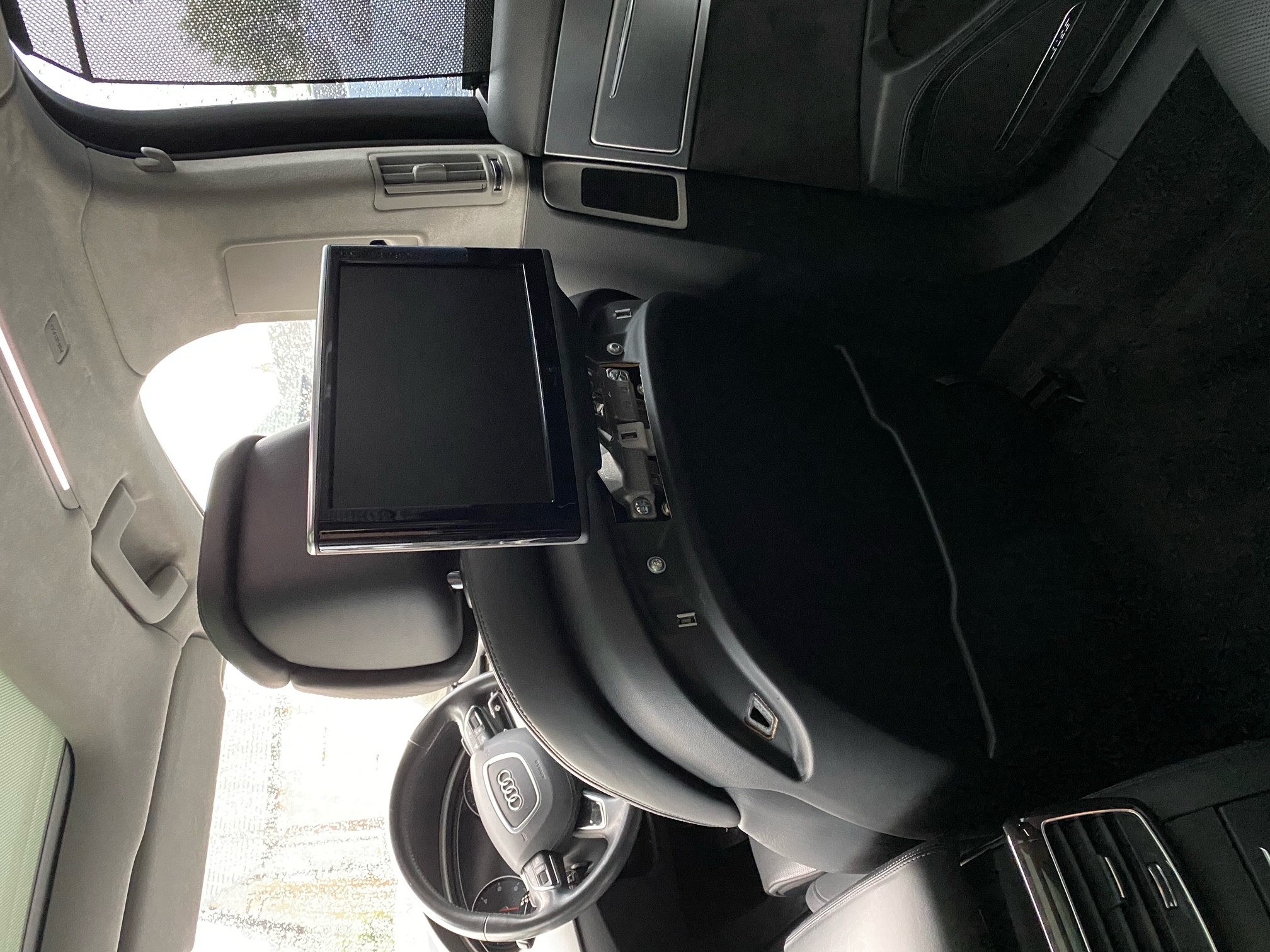

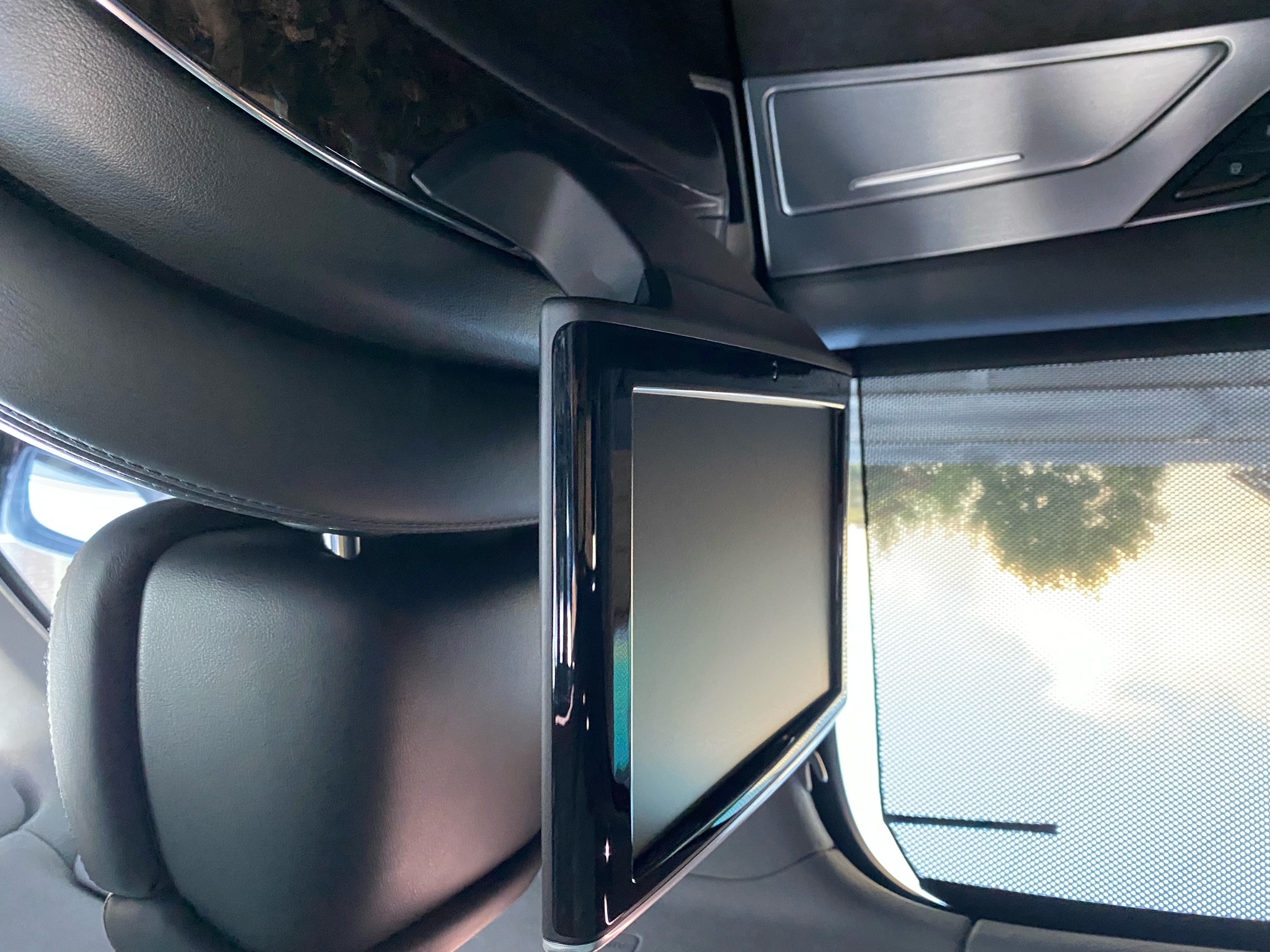

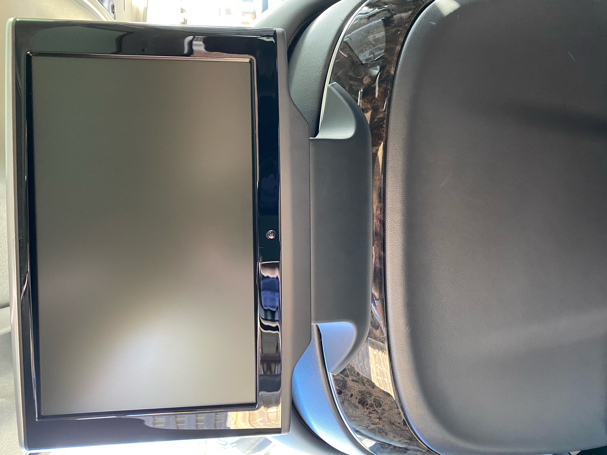

Up next was the monitors as I figured even if I progress no further it will at least look like I have RSE fitted to the untrained eye!

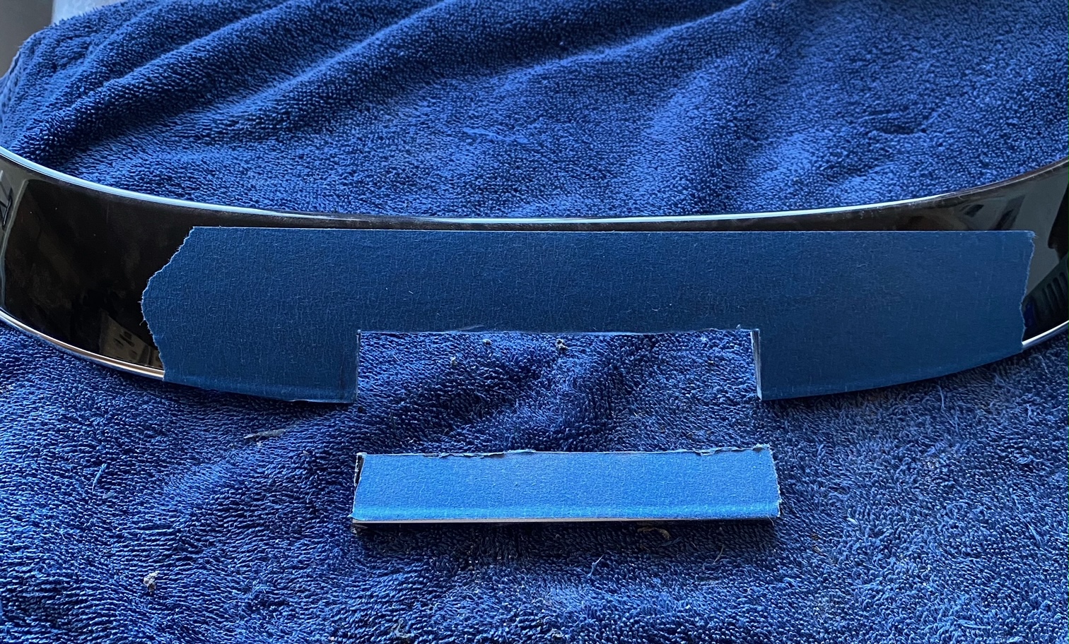

My car has Audi Exclusive Poplar Brown Silver wood trim which might prove impossible to get hold of used pre-cut for the monitors and/or elusive & expensive if purchasing new. Looking around I have seen prices of £500 per piece banded about on the Internet so I figured I have nothing to lose by hacking at it myself as a first attempt. If I mess it up then I will have to buy the trim but if I don't then I just might have saved myself @£1000
Working in my favour is the cut doesn't have to be exact nor neat as it will be completely covered by the lower front plastic trim although my OCD would punish me relentlessly if it was a poor cut

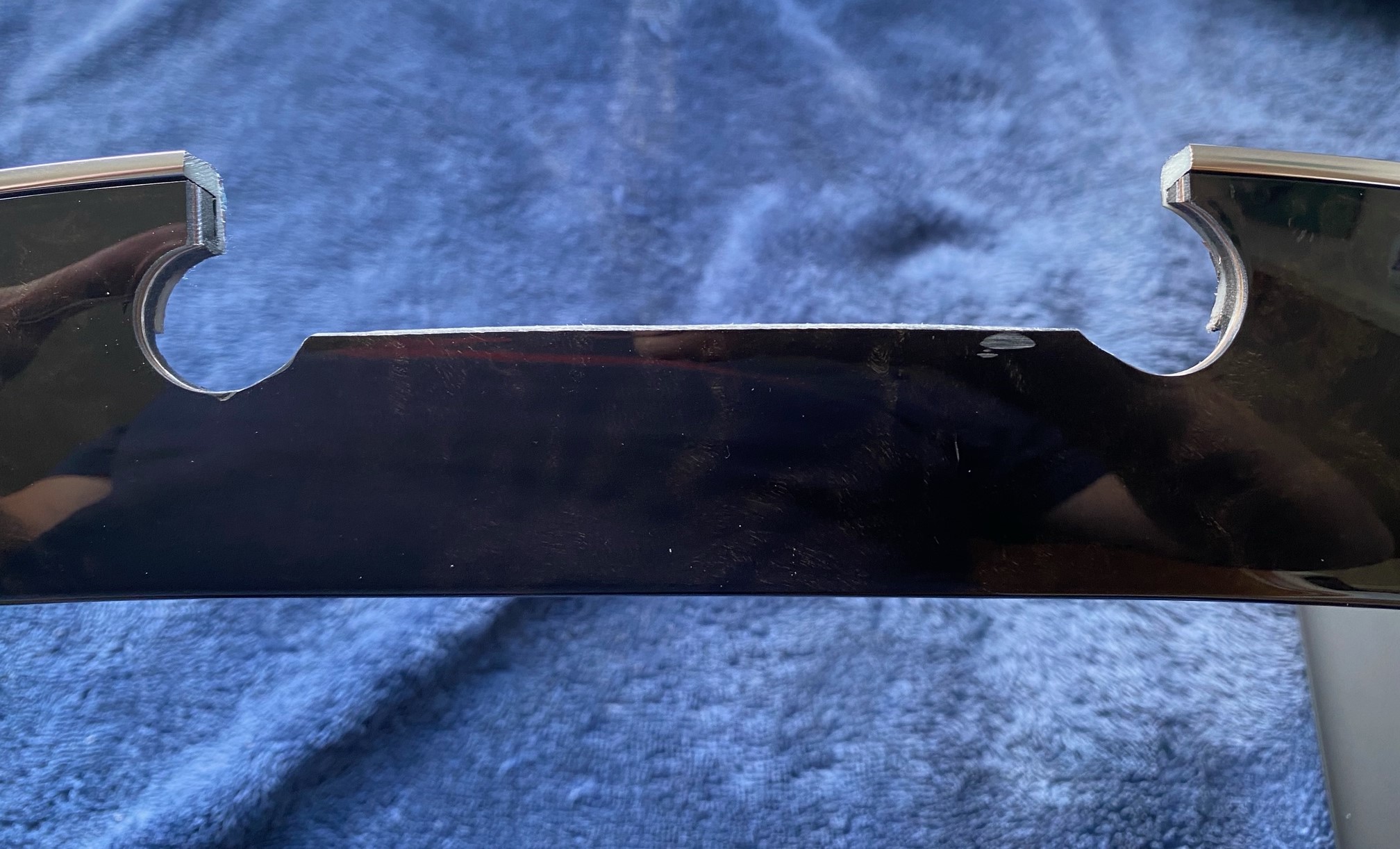

So looking at the bracket on the bottom of the monitor I figured a simple rectangular slot would suffice instead of the intricate shape shown on this photo of an original RSE seat trim from eBay;
I was more concerned at this stage of making a straight & level cut but needn't have worried as I just followed the inside edge of the plastic chrome trim on the long cut with a Dremel which was just the right depth. I found it easier to use a junior hacksaw to cut the two small uprights;
Finished cut...or so I thought
Turns out I didn't need the two 4H0 885 153 monitor brackets supplied with the kit as the aluminium monitor bracket already fitted to the monitors is designed to fit into the existing bracket in the seat back. It nicely slots in place and will hold its own weight even before you put the two 6mm bolts in to secure it which gives added strength because I do worry that unruly rear seat passengers might grab hold of the monitor to help extract themselves from the back of the car!
And if anyone wonders what the inside of the seat looks like if you undo those two T30 Torx screws and lift the back up & away then brace yourselves;
Next on with the wooden trim;

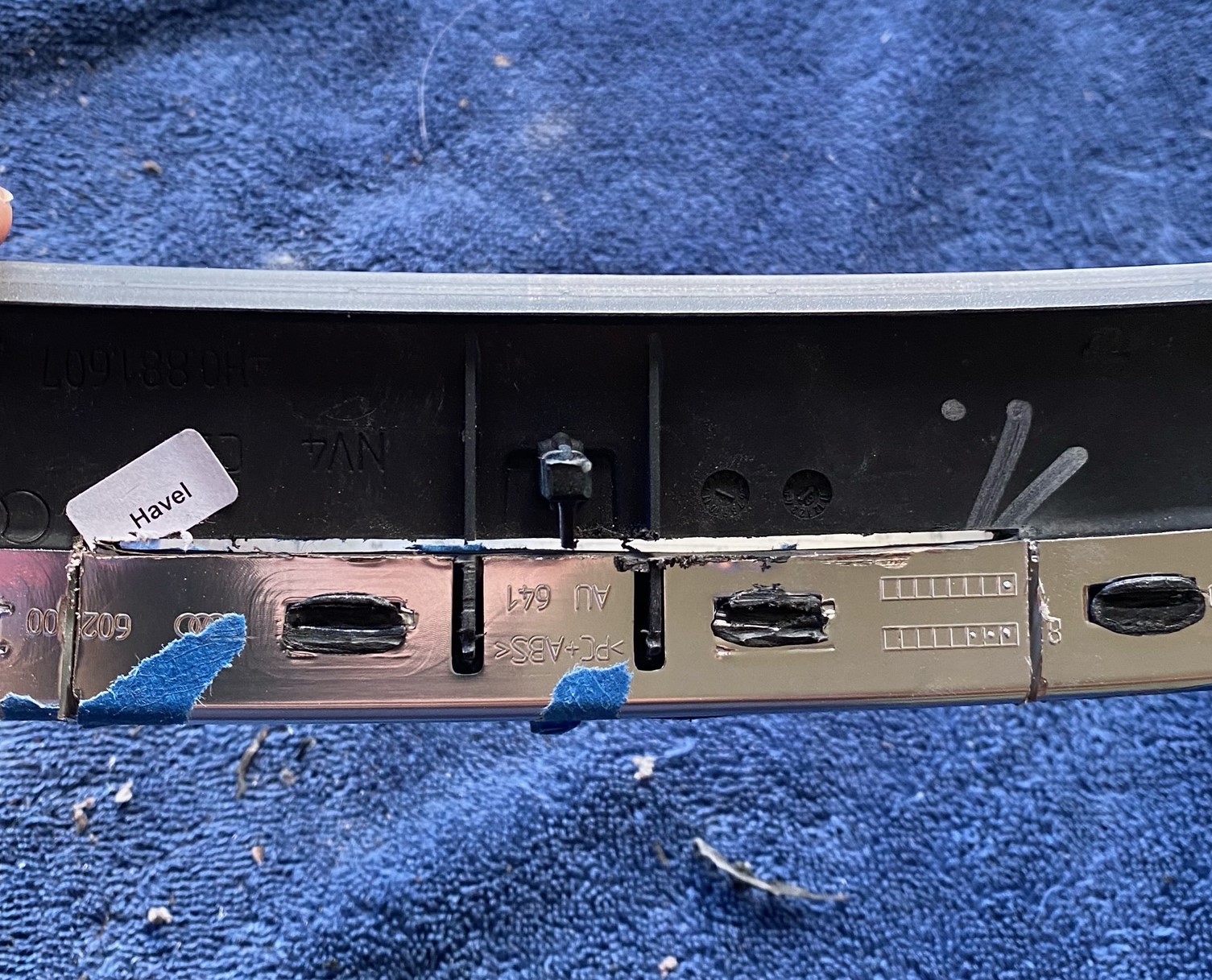

Jobs a good 'un I thought and then went to fit the plastic monitor trim to cover up my carefully cut slot but the lower trim wouldn't fit into place no matter what I tried.
On closer inspection it was found that the two plastic legs on the bottom of the trim were impacting on it preventing it fitting down into place.
Now I realise why the eBay photo has those rounded holes opened up in the corners. Bugger...ah well off with the wood trim again awaiting another visit from Mr. Dremel;
Now I should have a finished cut
Close up showing the legs on the trim now allowing the trim to sit low enough to clip into position. I have to say the thought of taking the easy way out and just cut the legs off did cross my mind
Looking good so far...to be continued
