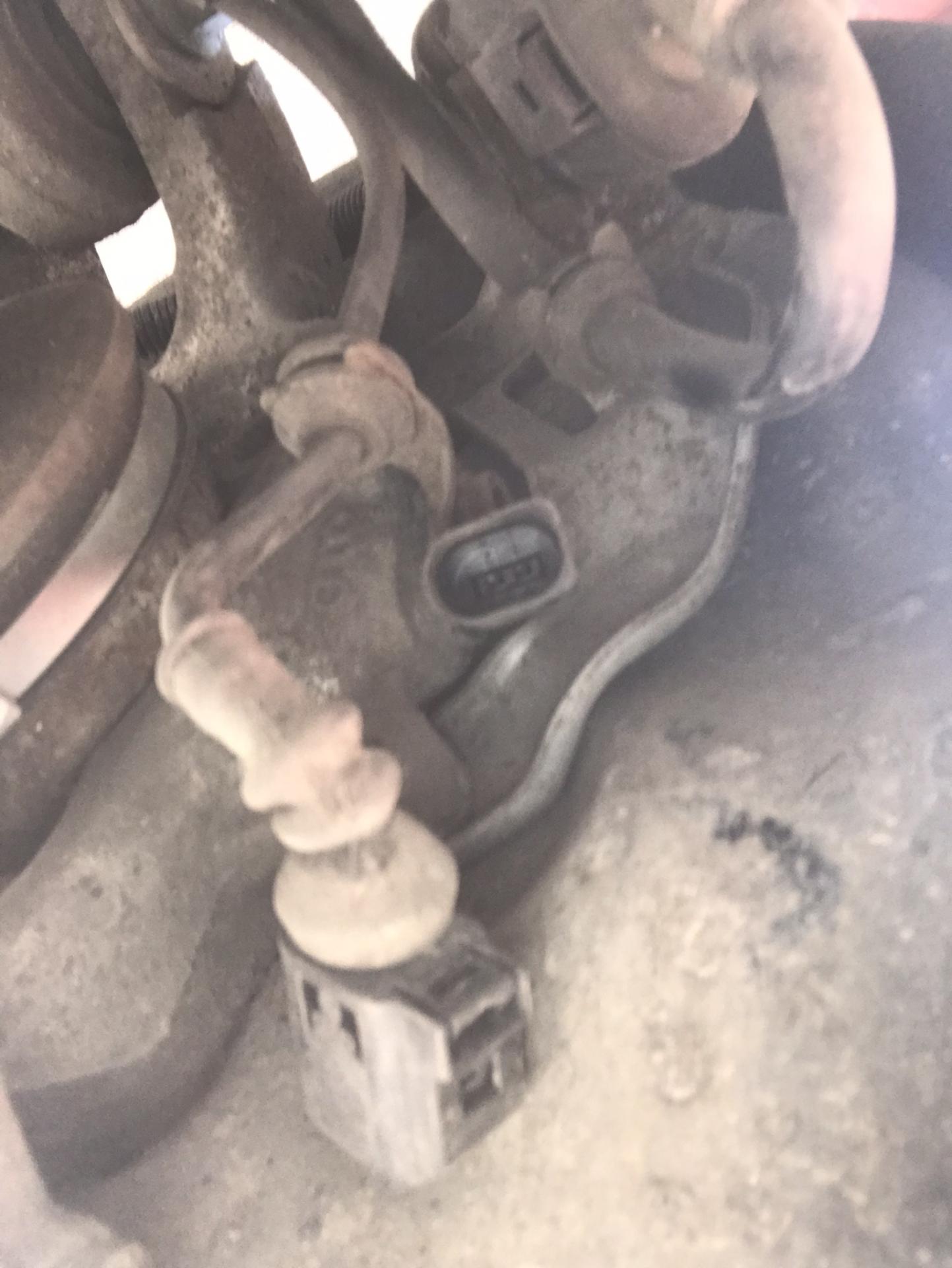

Well as I am now unemployed, I took advantage of the time to remove the rear wheel and investigate the wheel speed sensor.
After disconnecting the wiring to the sensor, there was no apparent issues with either the car wiring connectors or the sensor itself.
I disconnected and reconnected the connector a few times and then clicked it back into place and went for a drive.
The drive was fine, but whilst sat in the car outside my house doing zero mph the fault recurred and has recurred again since.
I am assuming I checked the correct wheel (UK passenger side, rear).

The attached picture is taken looking up at the sensor with the wiring disconnected, no sign of water ingress at this end.
