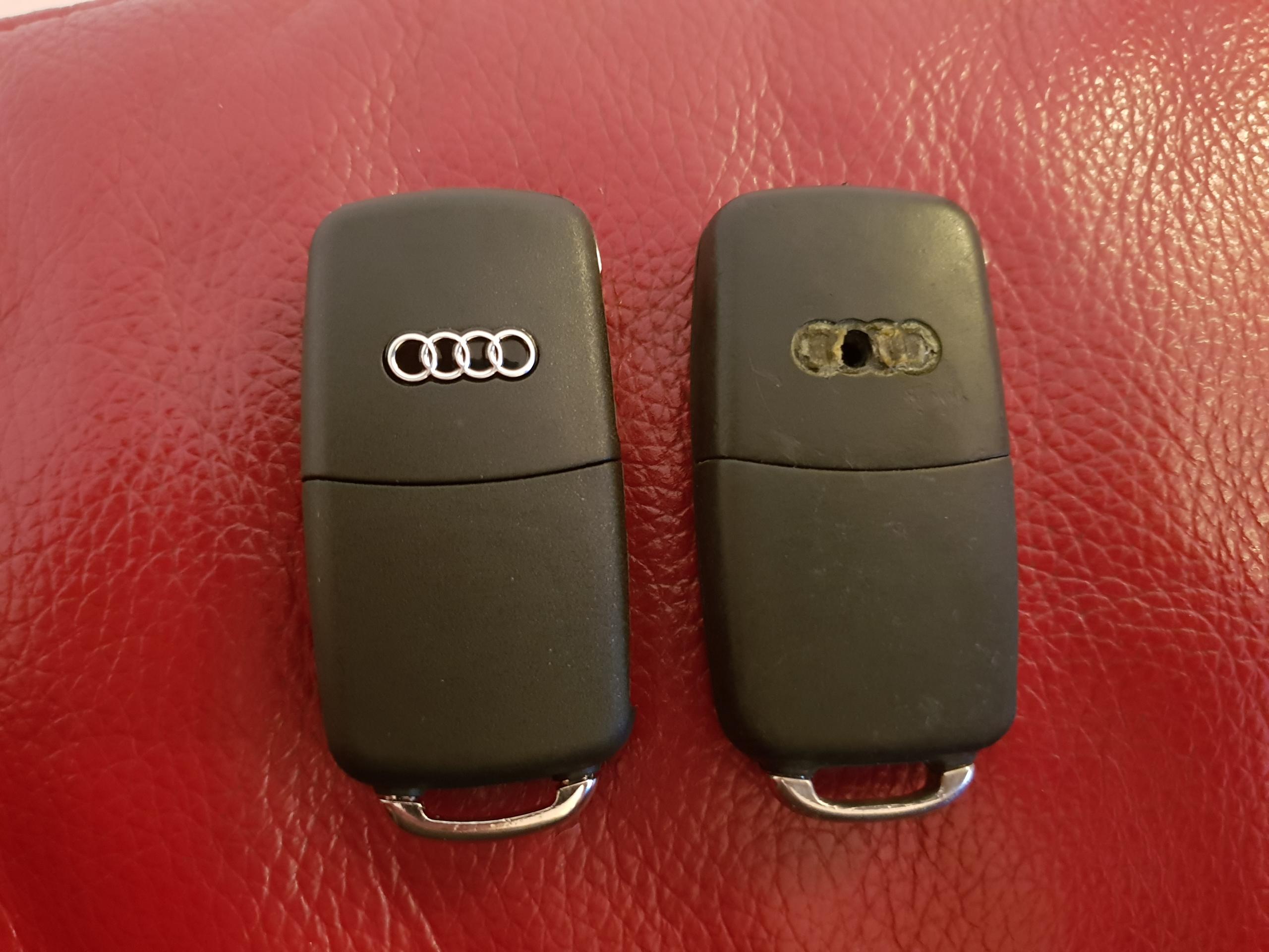

Finally replaced my key fob case - total cost for new case with gaskets, battery and screws plus little audi badge on front - £9 delivered. The key doesn't feel cheap as I thought and actually looks oem.
Really easy to do, take the badge off, unscrew the screw then pull apart. There are 2 little screws at the bottom which need to be removed to get access to the circuit board. Put the new battery in and put back together.
I used my old key with the new spring and button so still looks new.
Pressed unlock and worked perfectly. Car sensed keyless features too. I put it in the ignition and turned on and off just to be sure.

I never thought of doing that but it really is as straight forward as -
Take Audi badge off key using thin screwdriver or knife
Unscrew the screw that is behind the badge
Pull two pieces apart
Undo two screws at bottom of circuit board half
Pry out the circuit board
Then do the same with the new key fob case and transfer the circuit board and battery over. Everything fits as it did with old case so can't go wrong really.
Only thing I would add is I didn't need to screw the two screws at the bottom on new case. They are provided but I found it wouldn't clip together with them in. Not sure why.
