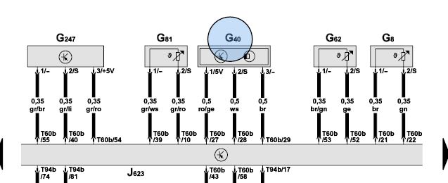

G40 wiring here:
Interesting that the V8 tdi only has one, compared to two on the V8 petrol engine. Without it, the ECU knows the engine is turning, but not what state it's in which would explain why it won't start.

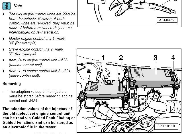

This might also be useful if you're going to check the wiring:
I'm not sure if the reference to adaption values applies if you simply unplug the ecu and plug it back in later but worth noting anyway.

Thanks for the diagram,. I'm not sure I understand which pins I need to look for though. Do I just look for 27 through to 29? It's the t60/b hats throwing me. I get the j623.
I read the bit at the bottom, actually read through the whole document but didn't twig there might be adaptations to do afterwards. Definitely something else to read up on to make sure I don't bollox it up!

There is a 60-pin connector and a 94-pin connector on the ECU so T60b is the smaller of the two. G40 is on pins 27 (5V, red/yellow), 28 (signal, white) & 29 (ground, brown). At the G40 sensor connector, with the ignition on, you should see 5V across pins 1 and 3. You'd need an oscilloscope to see the output from it when the engine is spinning.
If you get 5V at the connector then a continuity check back to the ecu on pin 2 to T60b/28 should prove out the wiring.
