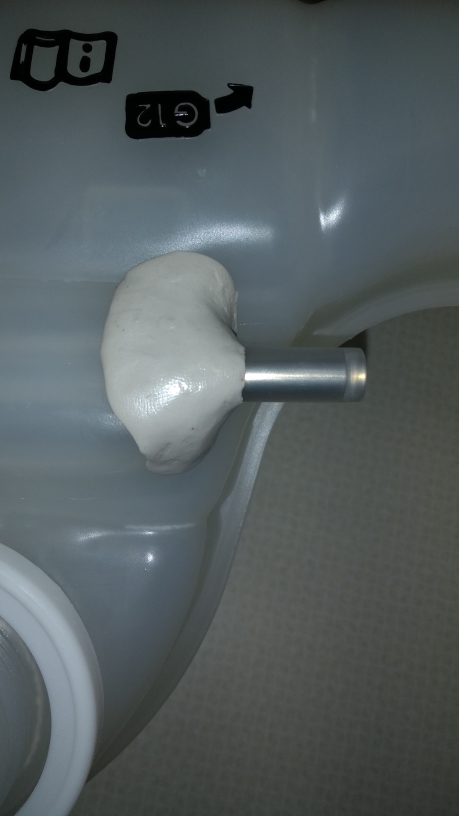

I had a number of slow leaks on S8 over the time. The one that keeps coming back is the small pipe on the expansion tank breaking, I think I have already replaced tank 3 times and it's broken again.
New Meyle tank arrived this morning and this time i put some epoxy putty around it to reinforce and relive some of the stress. Also used primer/activator/adhesion promoter from loctite palstic super glue kit as epoxy does not normally stick too well to plastic on it's own and I have used this primer with epoxy before and achieved good resuls. http://www.loctite-consumer.co.uk/en...-plastics.html

Honestly, using chewing gum..
