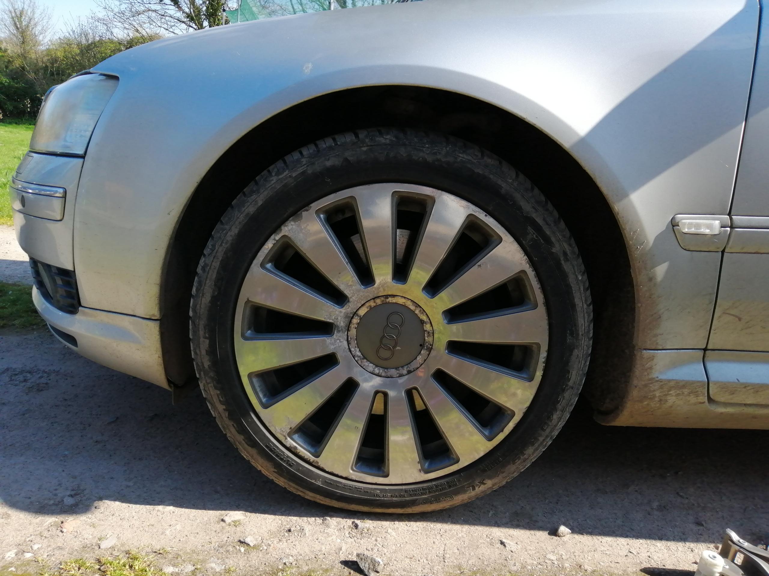

Here are the pictures.
I guess I'll need a drivers side front strut, as cheap as possible and to find someone very locally to fit it.
Possibly a compressor in the near future. I wonder if the reason for seeing 7 bar is that some of the air is escaping from the front drivers strut.
I am still only doing a minimum wage job, so need to keep costs as small as possible.
Why, when I've had no trouble with this car for 5 1/2 years do things start going wrong when you are trying to sell it and nobody is biting despite being for sale since July last year.

Ive put 3 different replacement struts onto 3 corners of my A8L D3 so far, and a new compressor.
I think youd need to replace both the compressor (or fix it) and the air jack because the jack leaking is one issue and then the compressor putting out 7 bar is never going to keep the system fed with enough air even when fixed or you may still get orange fault light where the compressor times out due to overheat.
When I changed my compressor it pumped so much more pressure the car then levelled before i had even changed my front leaking strut but if you dont change the strut then the new compressor will just get worn out much more quickly through over-use eventually as it will be on for much more of the time to constantly top up the leaking jack. That said, a new compressor may give you some time to wait and pay for a new air jack.

My problem is very similar - if I watch VCDS and operate to lift mode the compressor starts and it lifts, but the front right lags. When the compressor stops, the front right sinks and I can see the deviation in VCDS change around 1mm a second. The Compressor runs for a couple of mins and gets to 80 degrees C. It never goes above 7.5BAR presumably because there is a leak.

It does not go really low like a low rider, more like just to the dynamic ride height on one wheel and similar to your photos.
