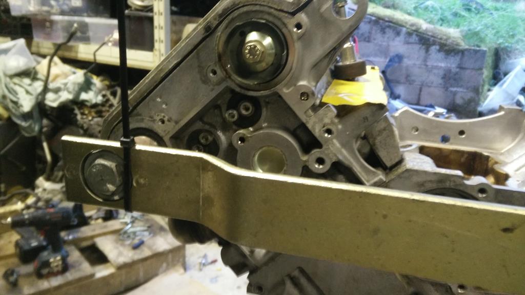

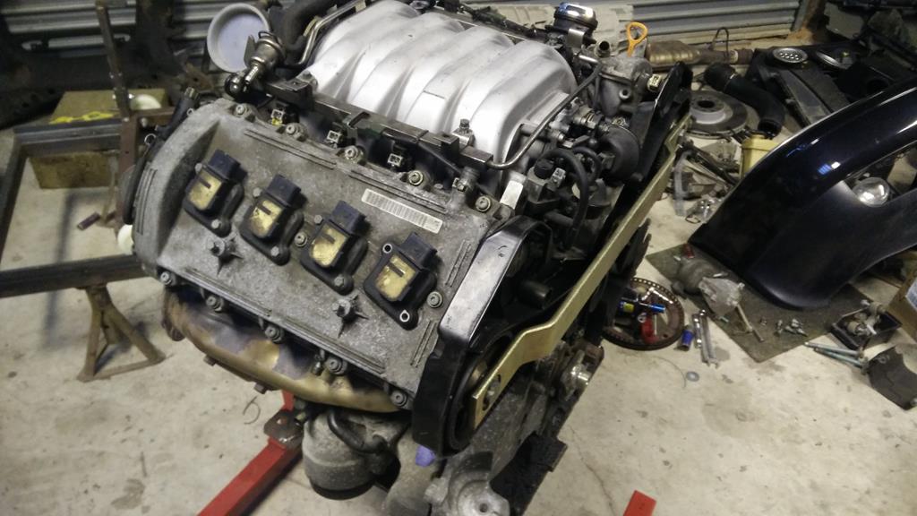

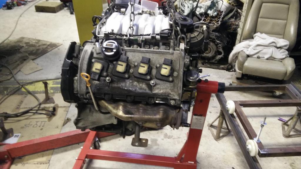

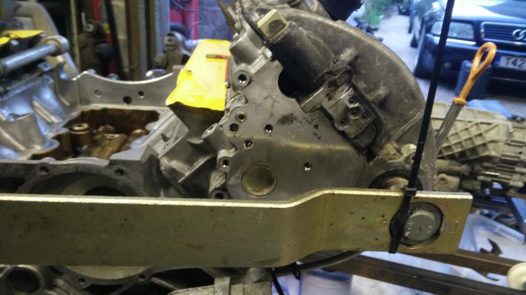

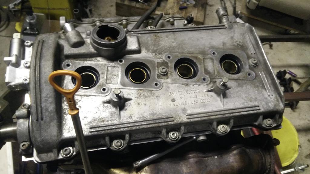

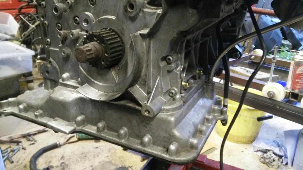

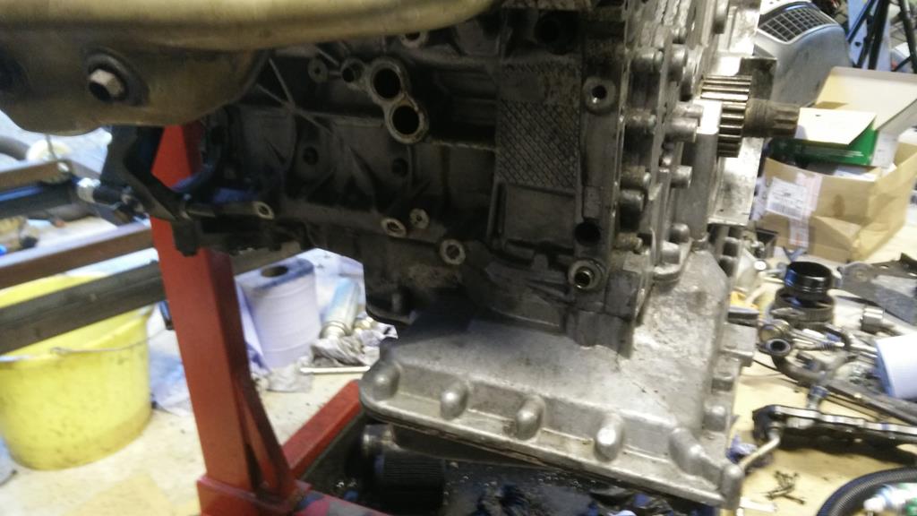

This afternoon was spent removing engine parts and prepping it for cleaning
I think this is where most of the gunge on the lower half of the engine came from
Attached to the bracket for the engine stand
On the stand

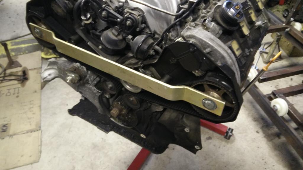

Locking tools in

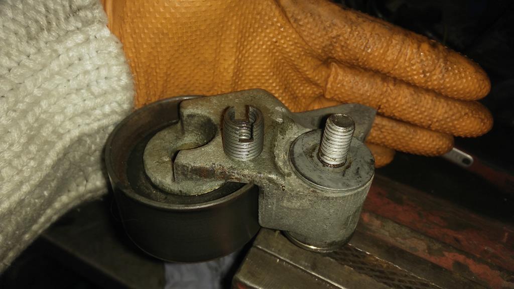

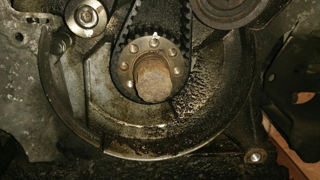

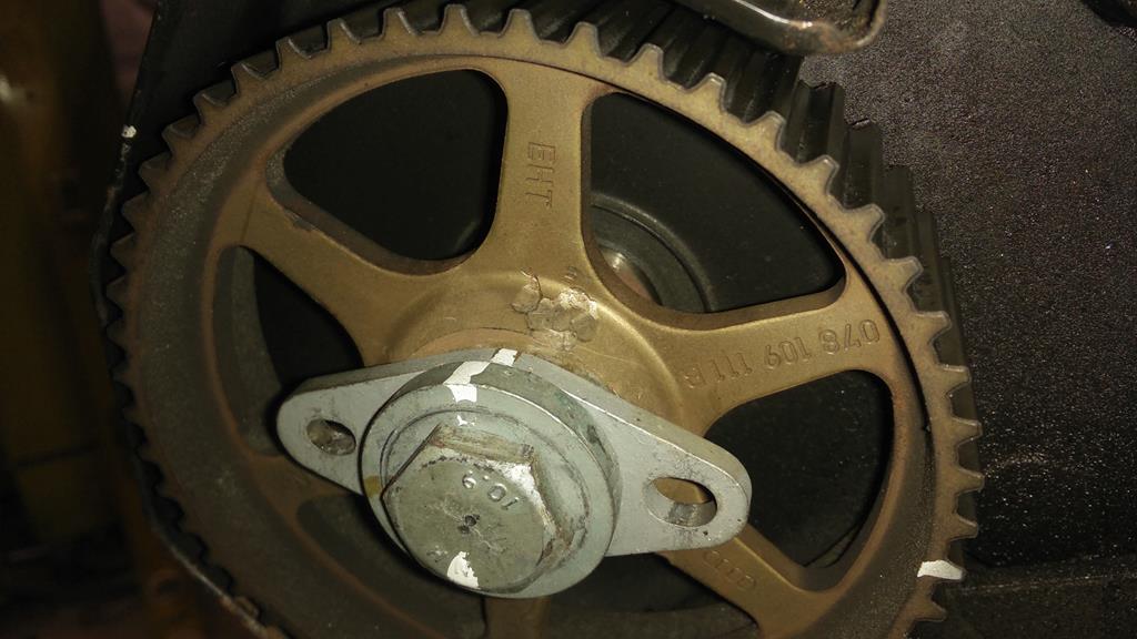

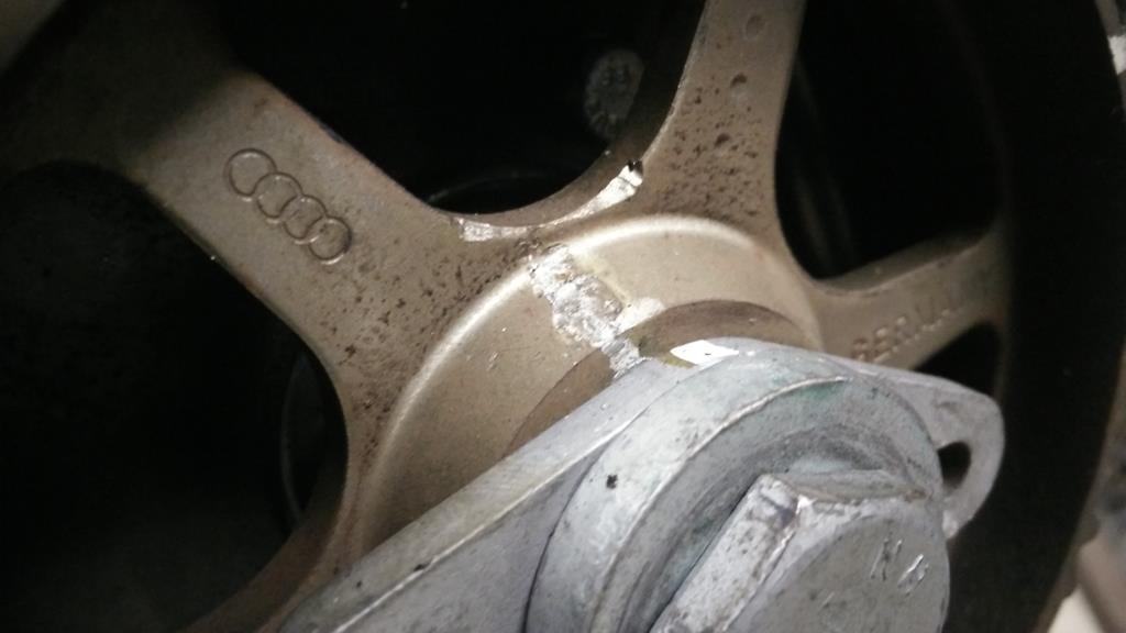

Started taking the timing gear off. This is a new one This is the tensioner roller and you can just see that there is a threaded insert stuck on the bolt. The threaded insert should have stayed in the engine but it appears the thread of the bolt is a bit mashed so it took the insert out with it. This is going to be 'interesting' to repair...
Whoever gorrilla'd the tensioner bolt apparently attacked the cam sprockets with a lump hammer too

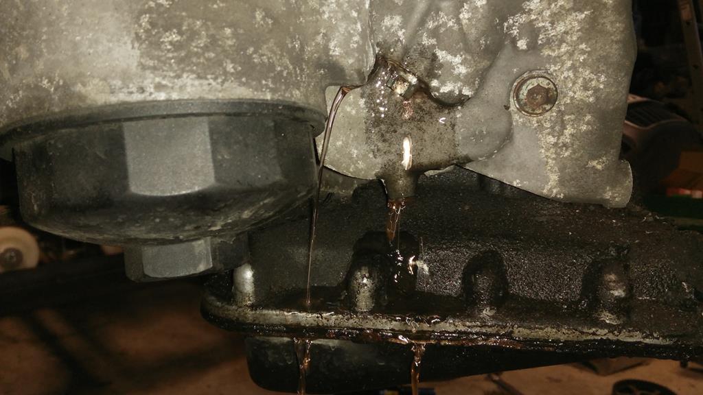

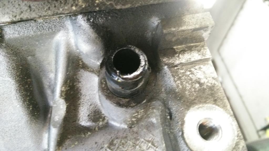

Drained the remaining coolant from the block. Its a good sign that both drains are clear. Oil cooler drain first
passenger side drain - this drain is almost always blocked, but on this engine it runs free
The vac hoses are completely perished so I'll replace those

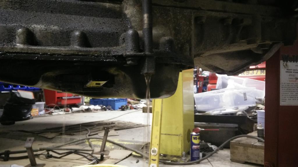

I left the oil draining overnight, ready for tomorrow

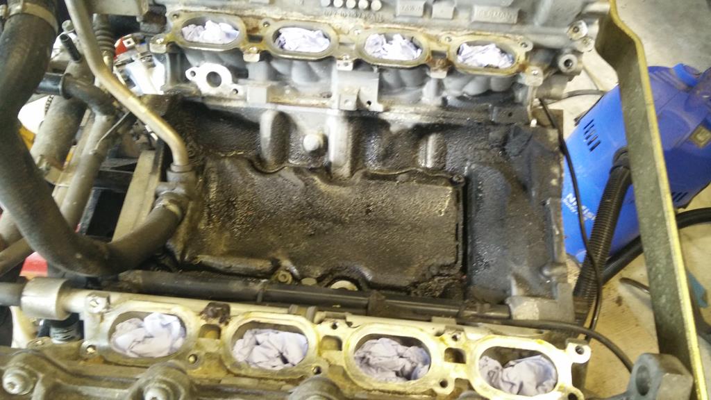

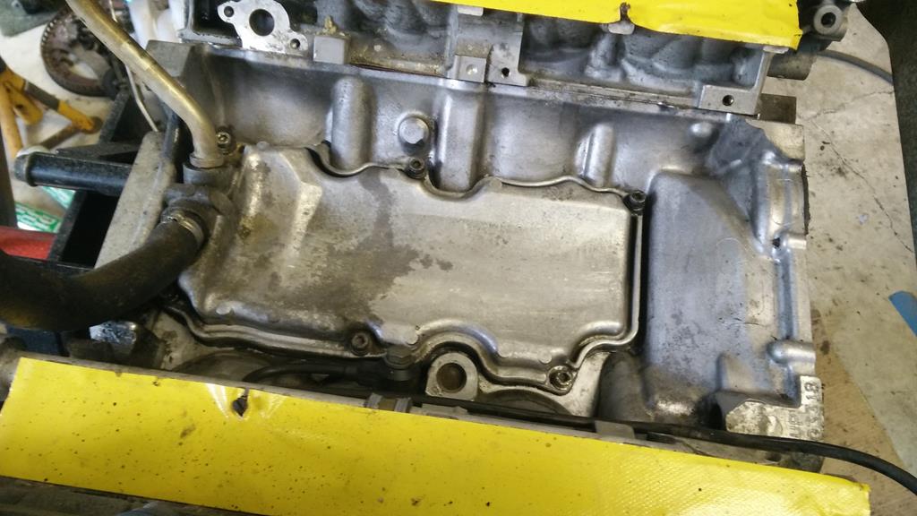

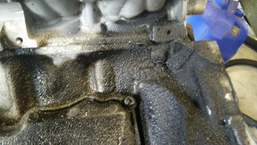

4 hours of cleaning...

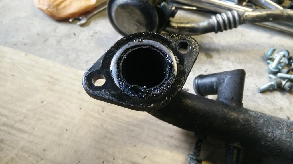

I pulled the oil cooler housing off. The plastic pipe had already cracked. That's getting replaced with an aluminium one.
Yeuch

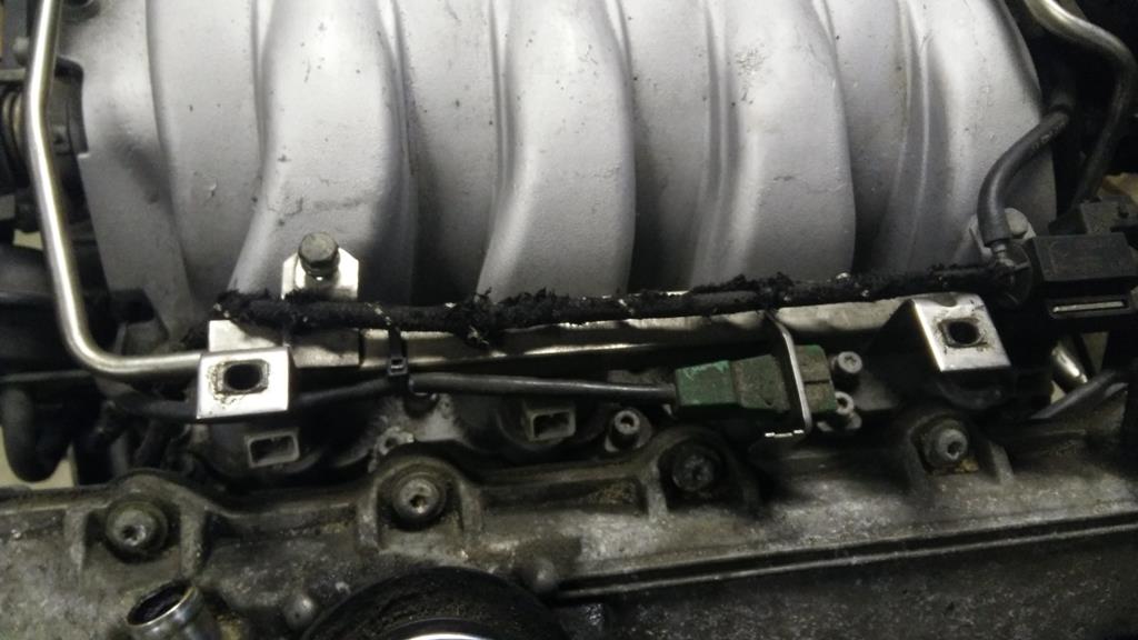

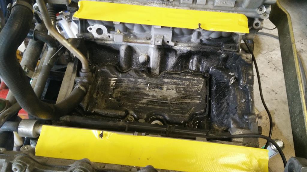

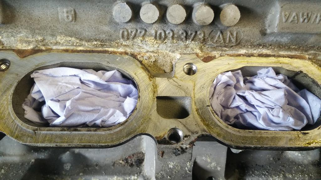

I really don't know why these engines collect sand between the inlet manifold and the head. They all have it, and one has to be extremely careful when taking the manifold off to not get any down the inlet ports
Flange cleaned up and the inlet ports protected

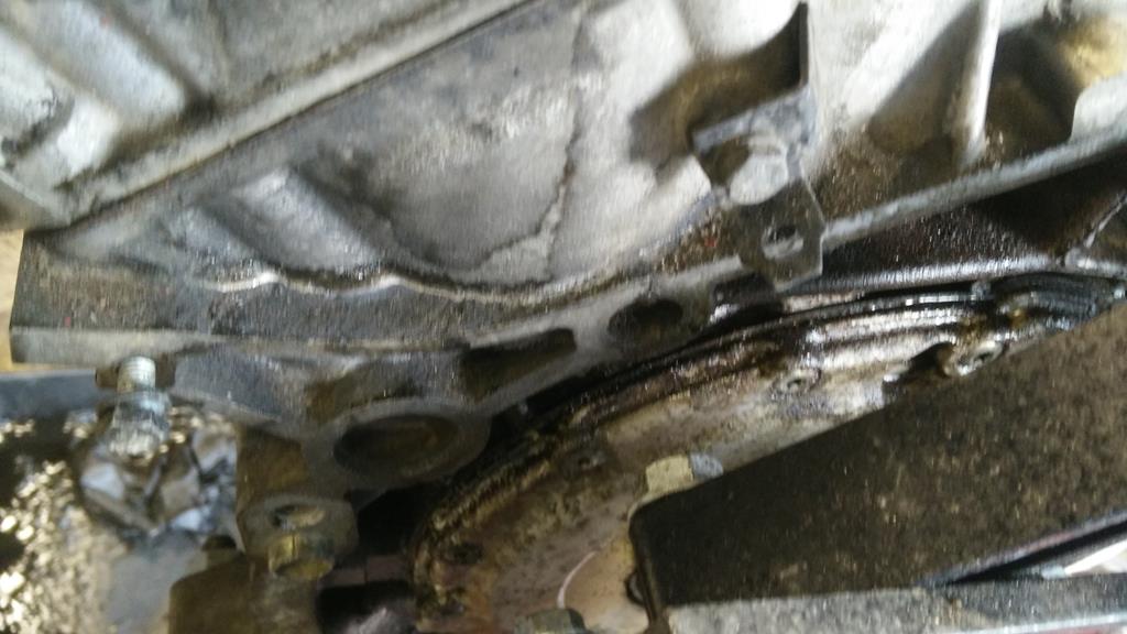

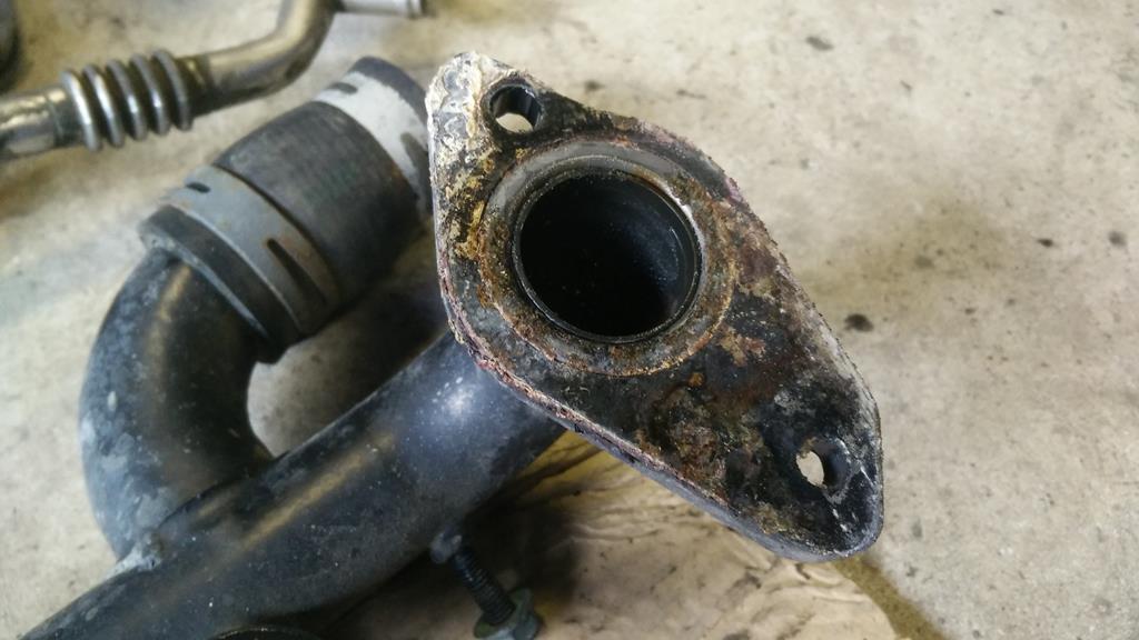

There was evidence of coolant leakage down the back of the block so I pulled the water pipes off the back of the heads. Just as well I did since one o-ring had turned to fluff and the other was already leaking.

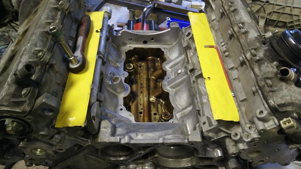

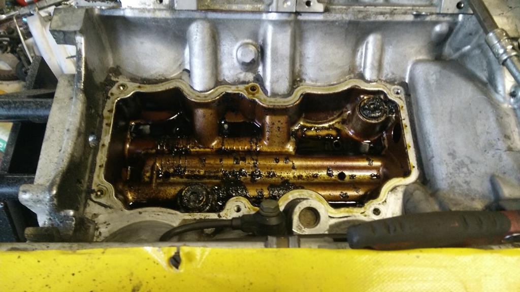

Cleaned up the valley

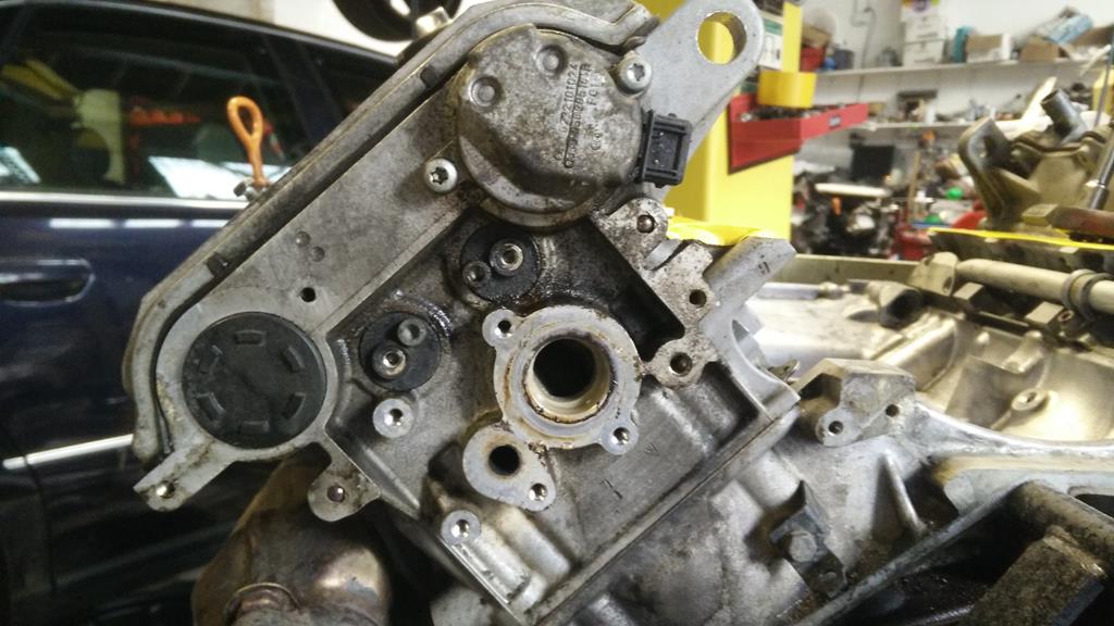

Breather cover removed - the gasket on this is the source of all the gunge in the valley and also all the oil down the back of the block. There's a little drain hole on the left of the pic where everything that leaks from here escapes down in to the bellhousing
More grub
2 gallons of degreaser later...

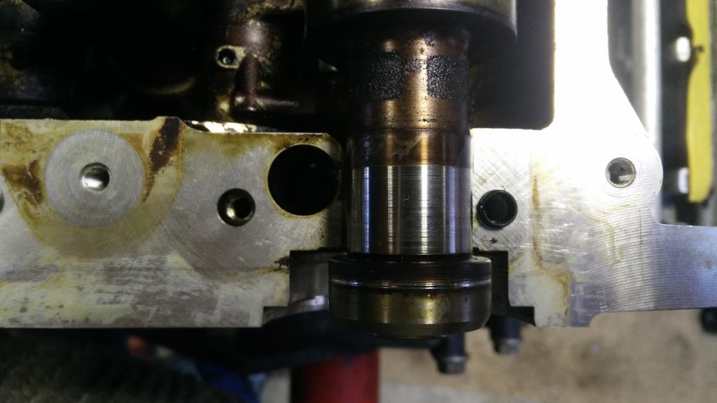

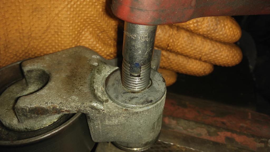

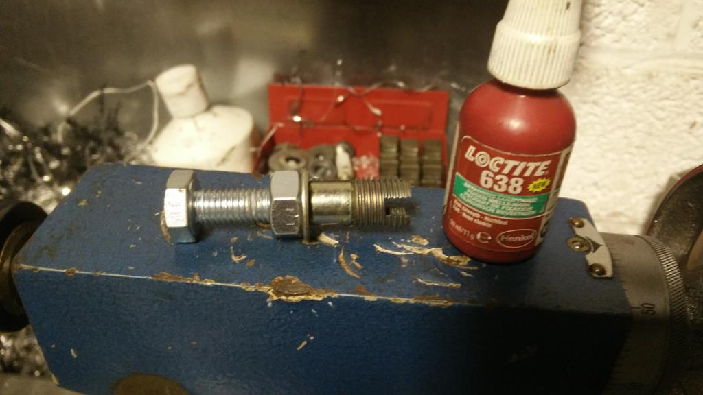

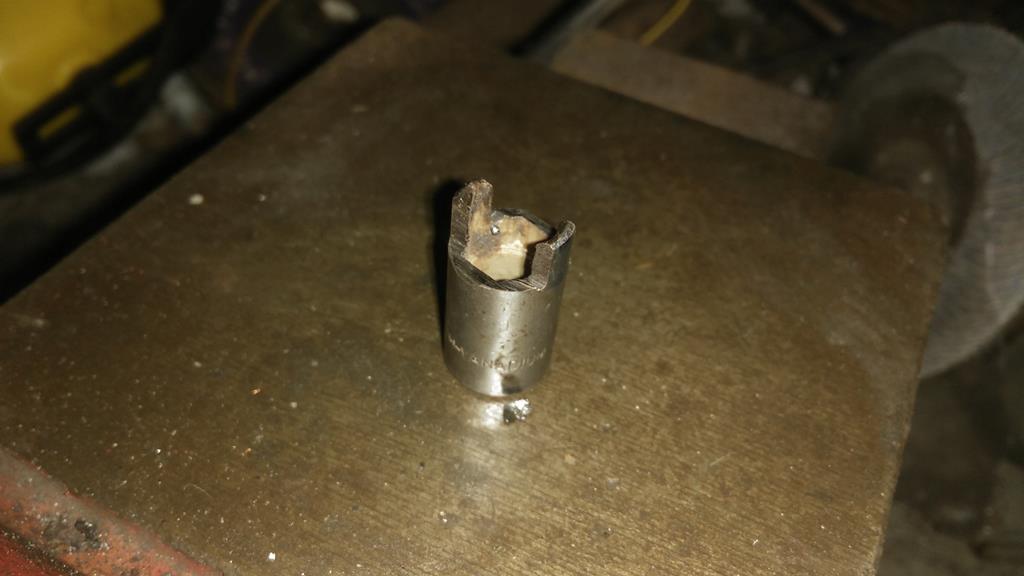

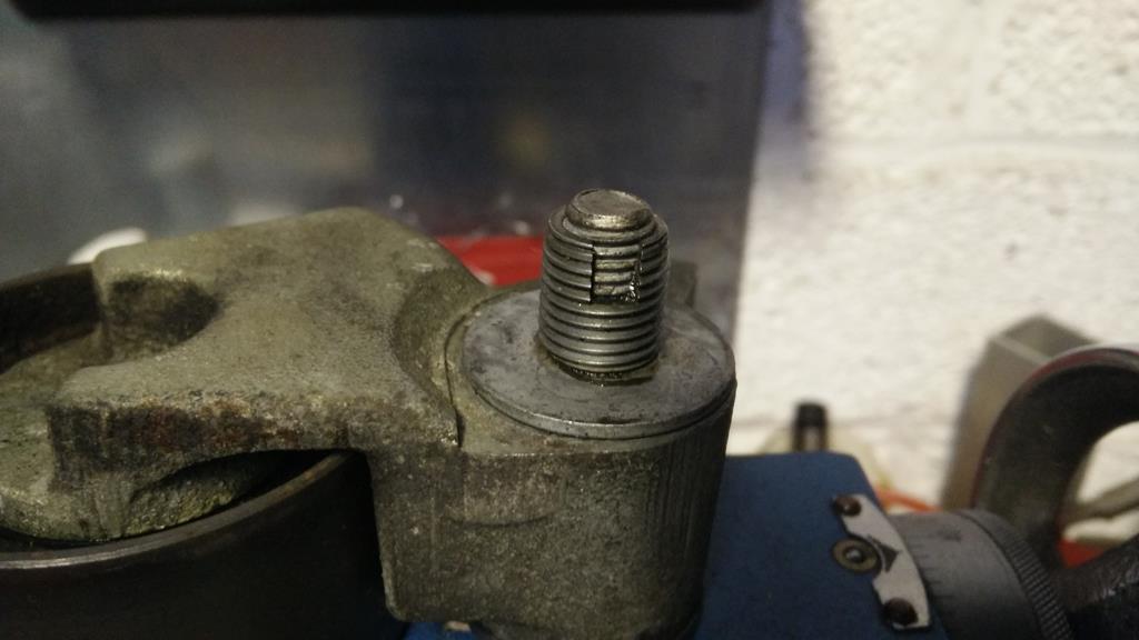

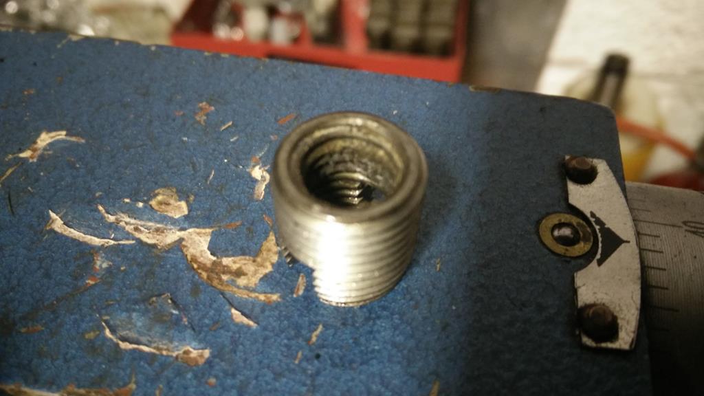

So, this threaded insert for the tensioner roller...
I sacrificed a 10mm socket to make a tool to remove the insert from the thread
It fits like this
The insert came off with a little persuasion

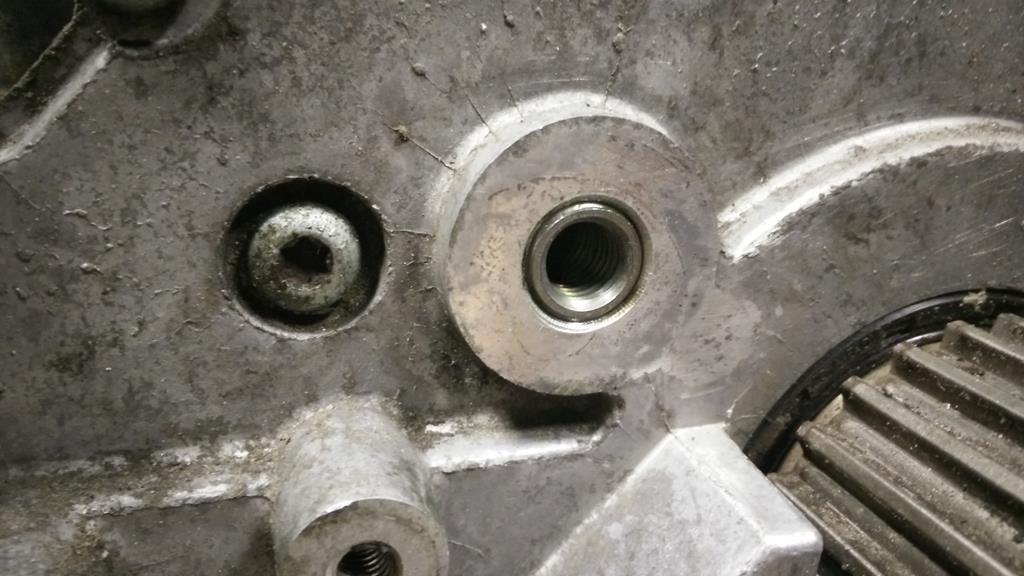

Whoever fitted the last belt didn't bother to clean the schmutz out of the thread. They just gorilla'd the bolt in and it got stuck. There's actually no damage to the thread - it just needed cleaning
Made an assembly tool to put it back in the block. It will be held in with Loctite 638 retaining compound
Screwed in to the block and permanently bonded with Loctite.

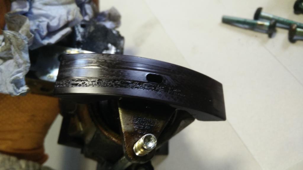

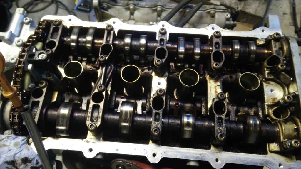

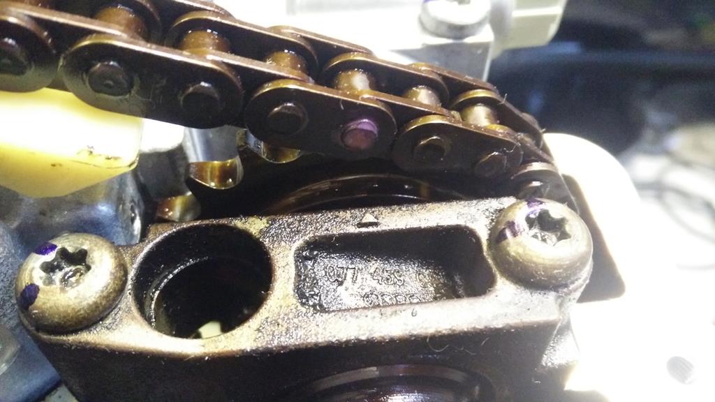

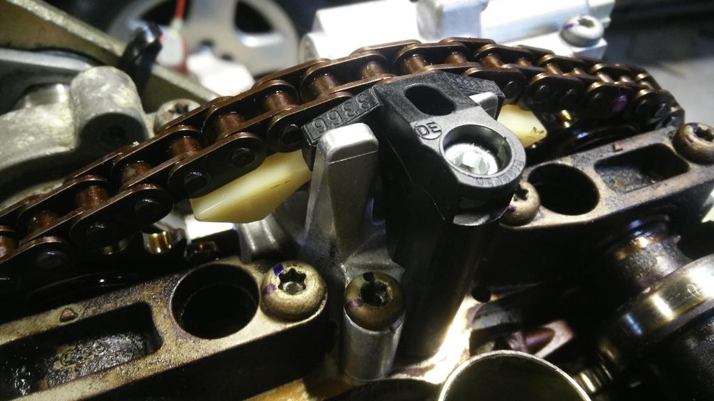

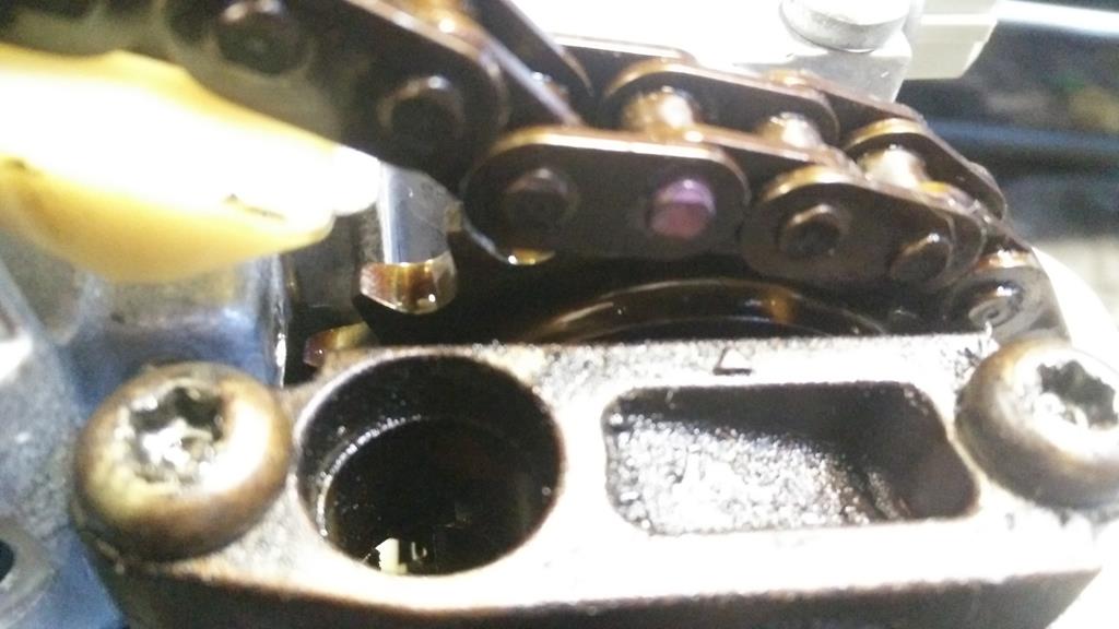

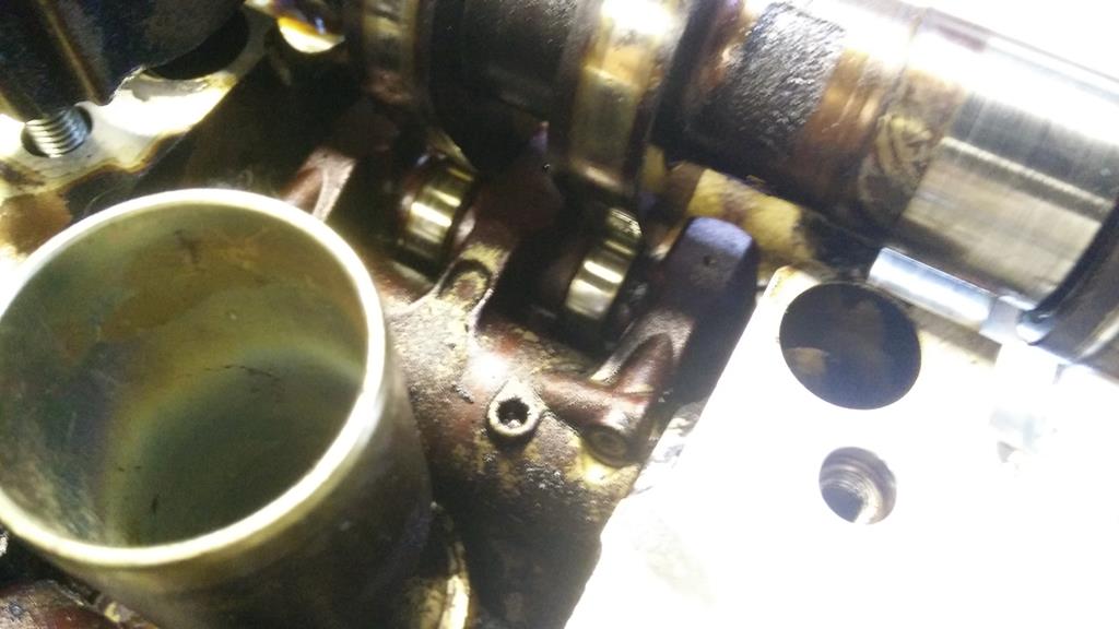

Chain tensioners.

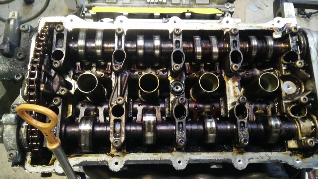

Since the engine is on the stand I can rotate it 45° so the head is level. This makes the tensioner swap an order of magnitude easier than doing it in the car with the head at 45°.

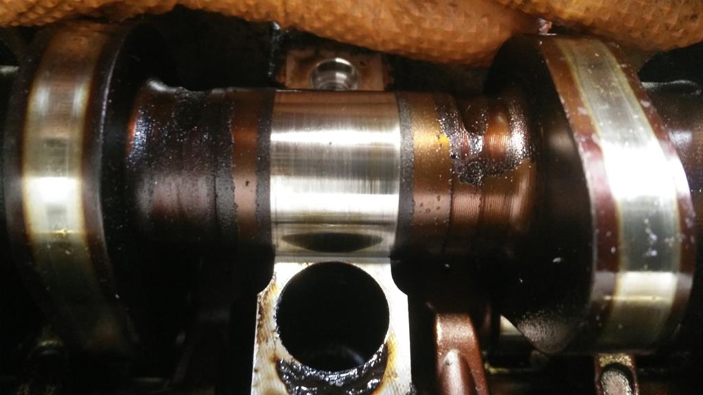

Not quite so spotless inside as Stephens! This is fairly normal for a 185K mile engine.
Removed the first set of cam caps. The bottom left one is removed even though the cam doesn't come out, since this leaves space to swing the tensioner out.
The cam journals are in perfect condition, despite the gunge

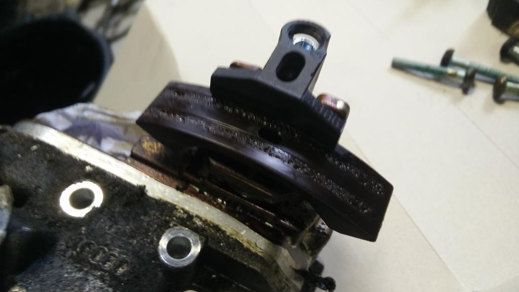

Bizarrely, even though the tensioners rattle on startup, the pads in this one are barely worn

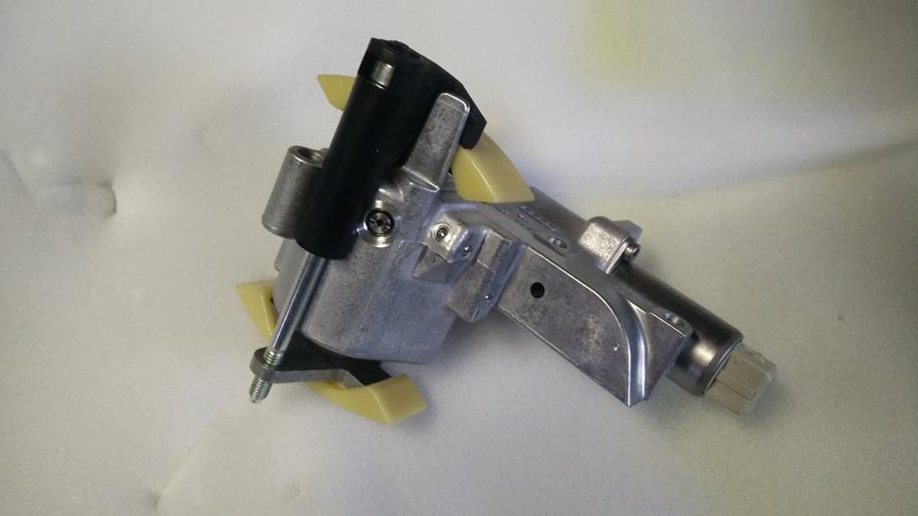

The new tensioner in its box. There really ought to be an angelic choir or fanfare opening this up
Ta dah!

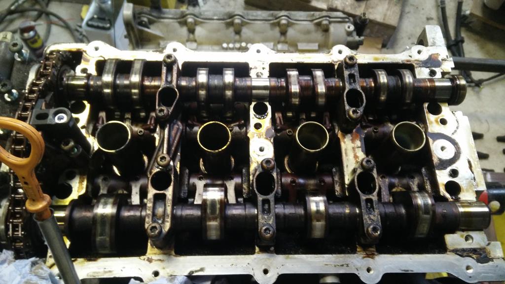

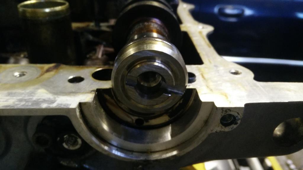

The passenger side cam is a pain because the roller lifters push it off to one side as it's tightened down
This is the culprit
Rather than just using the two main caps to pull it down in to the head, I use all four, plus a technique I've developed which I can't photograph with only two arms!
Back in place
It goes back in with the timing marks slightly off as the lifter pushes it out of position while the tensioner is compressed with its locking tool

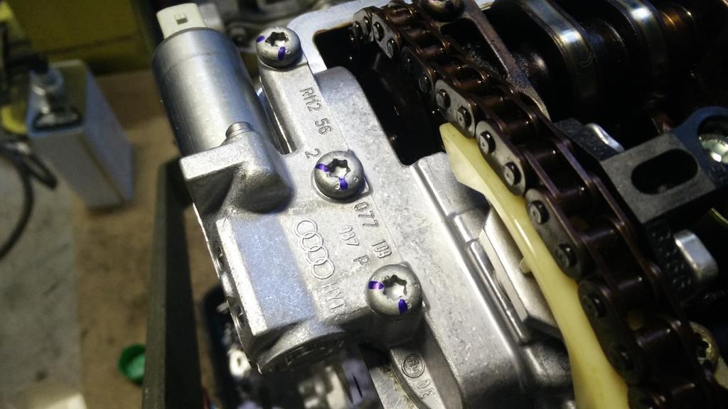

I mark each bolt as I torque it up. 5Nm then 90°, so two marks on each bolt.
New oil seals
A genuine VW special tool 3366! This compresses the tensioner so it can be removed or inserted
With the tensioner locking tool removed the spring pressure pulls the chain tight which pops the cam back in line

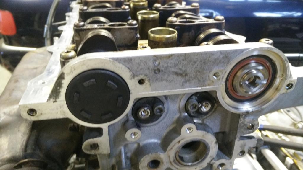

Cover cleaned up and back on with a new gasket
The driver's side is exactly the same procedure but much easier as it isn't trying to open any valves so it just drops back in place.

I notice the new pads are a different colour to the old ones; are they made of a different material or is that just how they look when they are clean!?
