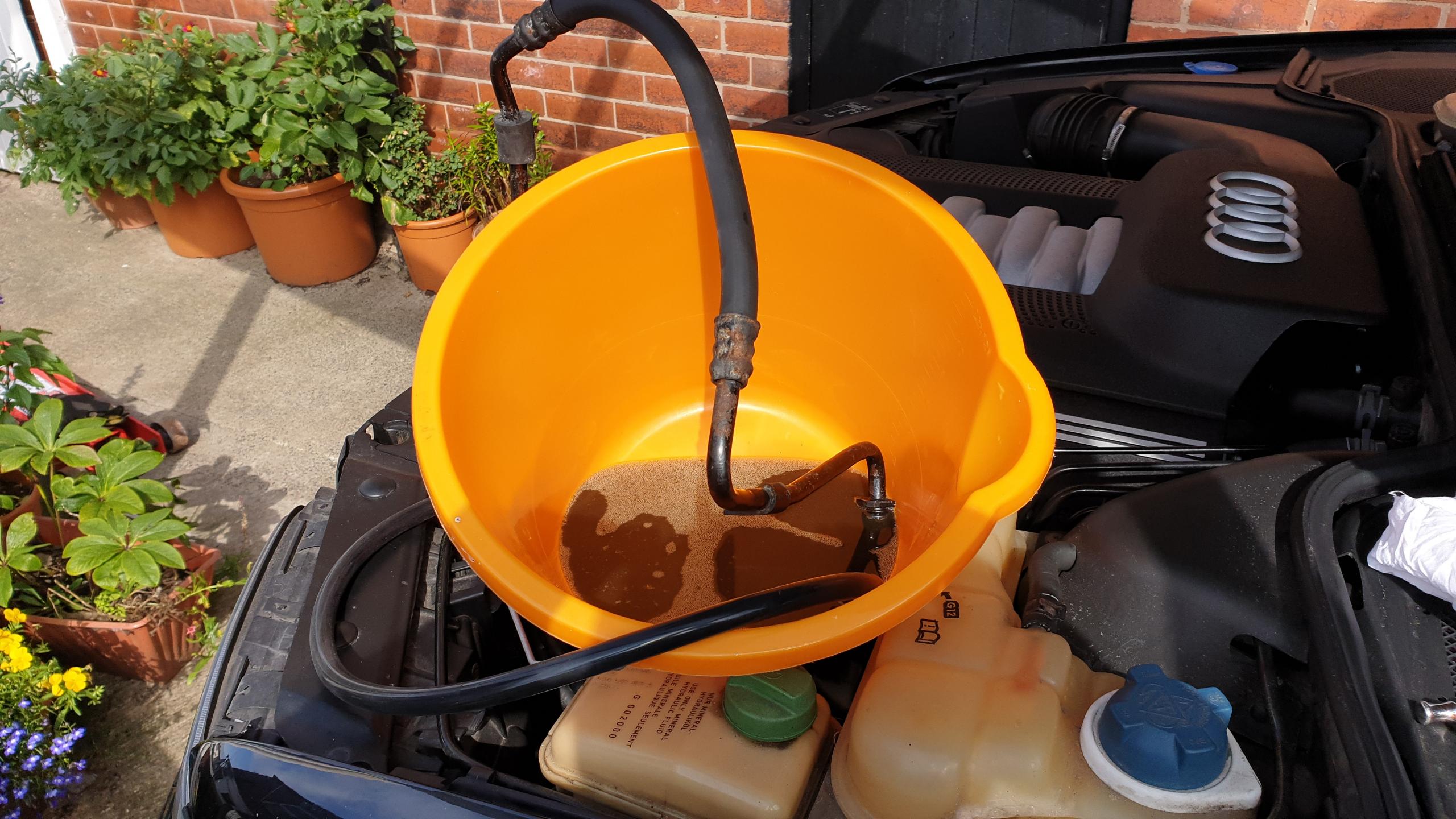

So that all went OK. The flow out of the cooler / radiator is definitely out at the top.
Not fully understanding the oil flow route though the gearbox, I don't know fully how effective this is but I feel I have done the best I can from a DIY point of view to Clear as much old fluid from the system as possible.
I've not finished the refill procedure yet as I had to break off to do some other stuff.

Old 21st August 2019, 02:11 PM
How is the pipe in that orientation?
Have you just pumped everything out of it by running the engine?
Curious to see how much you get out / how much goes back in by doing this.
Old 21st August 2019, 02:33 PM
Join Date: Dec 2016
Posts: 424
The pipe was fine in this orientation and yes I ran the engine to pump it out.
It's a time consuming process though because you don't want to run the pump dry.
I pumped out approx 2 litres and then went back under the car to refill the pan. I repeated the pump and then refill 5 times.
It's very wasteful when it comes to oil and to be fair the color of the first sample taken compared to the last wasn't as dramatic as I expected. That said, the genuine Audi oil seems to loose its clear ish colour very quickly in my experience.
By the time I had finished I pretty much filled the orange bucket you can see.
Audi S8 D2 2002 88k mls
Old 21st August 2019, 02:39 PM
Join Date: Dec 2016
Posts: 424
Just to be clear. I have just replaced the filter and front lower valve body so I am starting with an empty ish system.
I only have 3 litres in the pan plus what's in the rest of the box when I start the above process, thus I only take out 2 litres at any one time.
