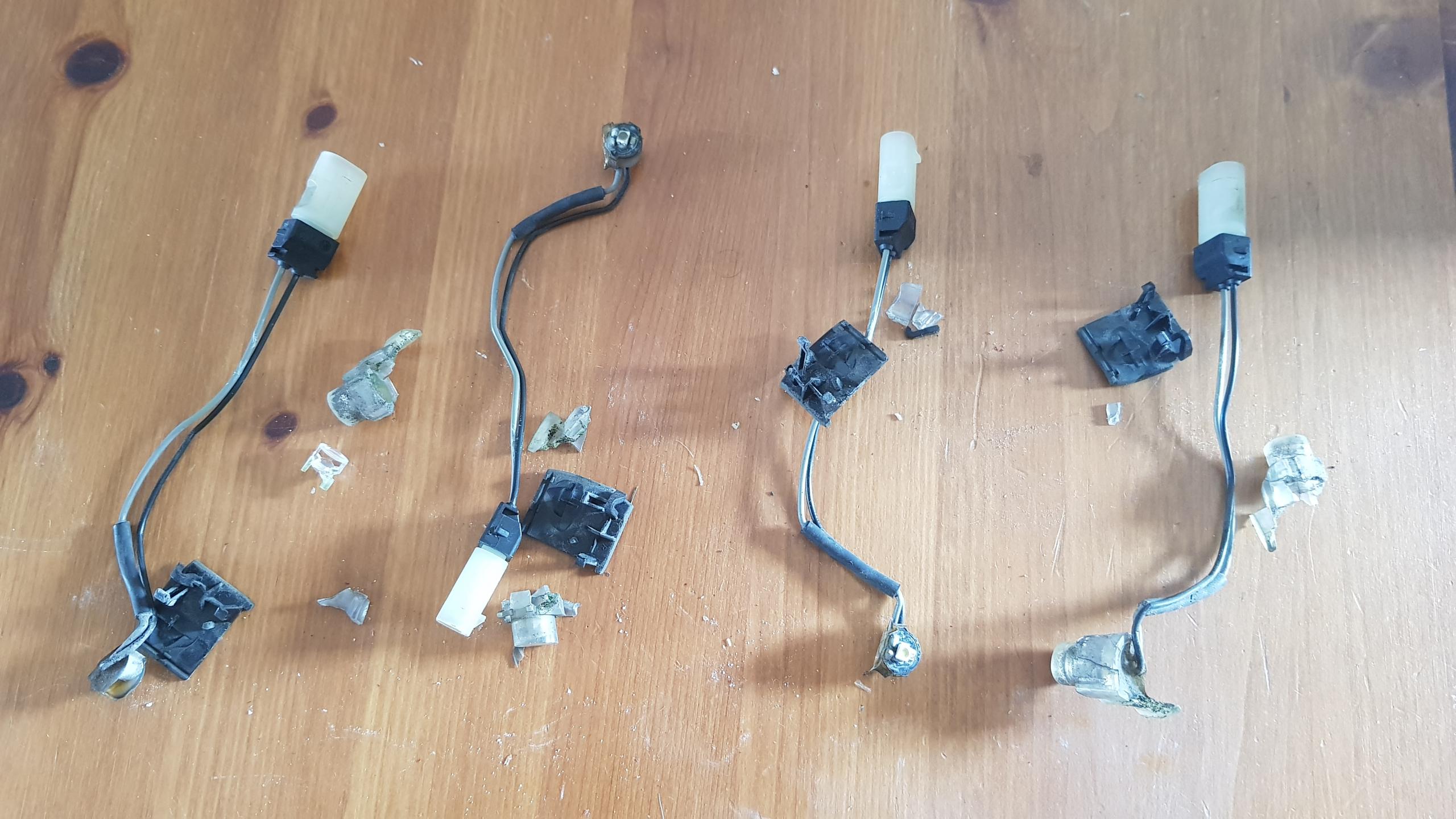

Old 14th March 2021, 05:07 PM
Albert_Swafega Albert_Swafega is offline
Join Date: Mar 2016
Location: Doncaster, South Yorkshire
Posts: 52
Replaced all mine Friday, I can't believe I've had the car all this time and never seen them lit before. So at 4 years old when we bought it, they'd already failed. They fell to bits as I removed them from the handles. All the AliExpress ones work perfectly.
