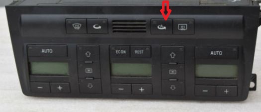

It's the mirror button to the standard recirculation one but has an A on it as well as the looping arrow. Drivers side of the little grille (alarm sensor?).
Press once to engage and leave it on.
The system takes about 30 seconds to warm up from start before becoming active. When it activates by detecting pollution it has a time delay after going "clean" so won't constantly flip-flop between incoming air and recirculation.

Did you find it OK? See attached picture:
I did. I don't know how I missed that button in nearly 10 years of owning the car!
I guess I just saw the recirculate symbol and never really noticed the 'A'.
I tried it briefly last night (on a 1 hour round-trip to see Sandi Toksvig at The Lowry, which was rather funny and enjoyable I must say )
As I set off, I noticed the button wouldn't stay lit/active. It seems that this was because I was using the windscreen demister at the time. Once I turned that off, the auto-recirculate remained active for the whole journey. So I assume it's working as it should, even though there seems to be no indication that it's actually doing anything!
