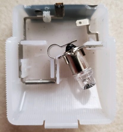

Is there a way to fix this glovebox light assembly by adding some kind of L shape bracket to replicate the original tabs?
That's precisely what I did to fix mine. I took a thin rectangular piece of steel and bent it in the vice at the correct angle, such that it would slip down the back (behind the positive connection) and stick out over the back like one long tab. Then (after taking the glove box out and doing a test fit) I glued the bracket to the back of the lens.

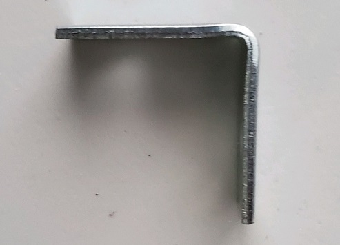

I looked around to see what I have that I could use for a L bracket.
I found a metal L bracket but I have a feeling this might not work?

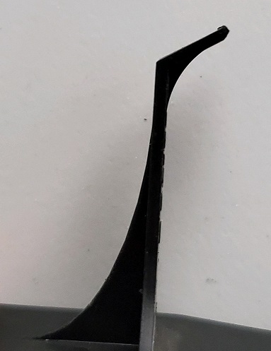

I did find a plastic L bracket that I can cut off and use. Just not sure if this angle will work?

I can't really tell the dimensions from the photo, but that metal bracket looks to be too thick. You need something thick enough to be rigid and hold the lens in place but thin enough to slide down the (inside) back of the lens.
If I remember correctly, the steel I used was from a computer expansion port blanking plate, which was not much thicker than that from a tin can -- in fact a piece of tin can steel might do it. What I did was cut the steel into a rectangle, the full (internal) width of the lens then slid it down the back. I then marked where it needed to bend at the top of the lens and bent it to the required angle (which is probably something like 100-120 degrees) to make the overhang parallel with the top of the lens. Then I just cut the overhang down such that it protruded like a single (full-width) tab. After a test fit (with the glove box out of the car), I glued the bracket to the lens. I'll take a photo sometime when I get chance (my S8 is in storage these days, several miles away).

Sorry I don't have a micrometer on hand to take measurements of the metal bracket. I kinda had a feeling that it was too thick to use.
I cut off part of the plastic L bracket and temporary placed it in the light assembly to get a picture. Ignore the metal bracket in the picture as I just used it to hold up the light assembly so I could take a picture without holding it up. I have a feeling that I need to cut the plastic bracket shorter as seen in this picture?

From memory, the bend needs to be level with the back of the lens (unless yours is different to mine that is), something like this ...
If you haven't done so already, I'd recommend popping the glovebox out. It only takes a few minutes to remove it and it makes it much easier to test-fit the lens and see what you need to fabricate. One thing that becomes apparent with the glove box out is that you don't need to replicate the original 2 tabs. A single full-width tab is a simpler and stronger solution.

Thanks for editing my picture. I will definitely cut down the plastic to get it to the same level of the back of the lens.
