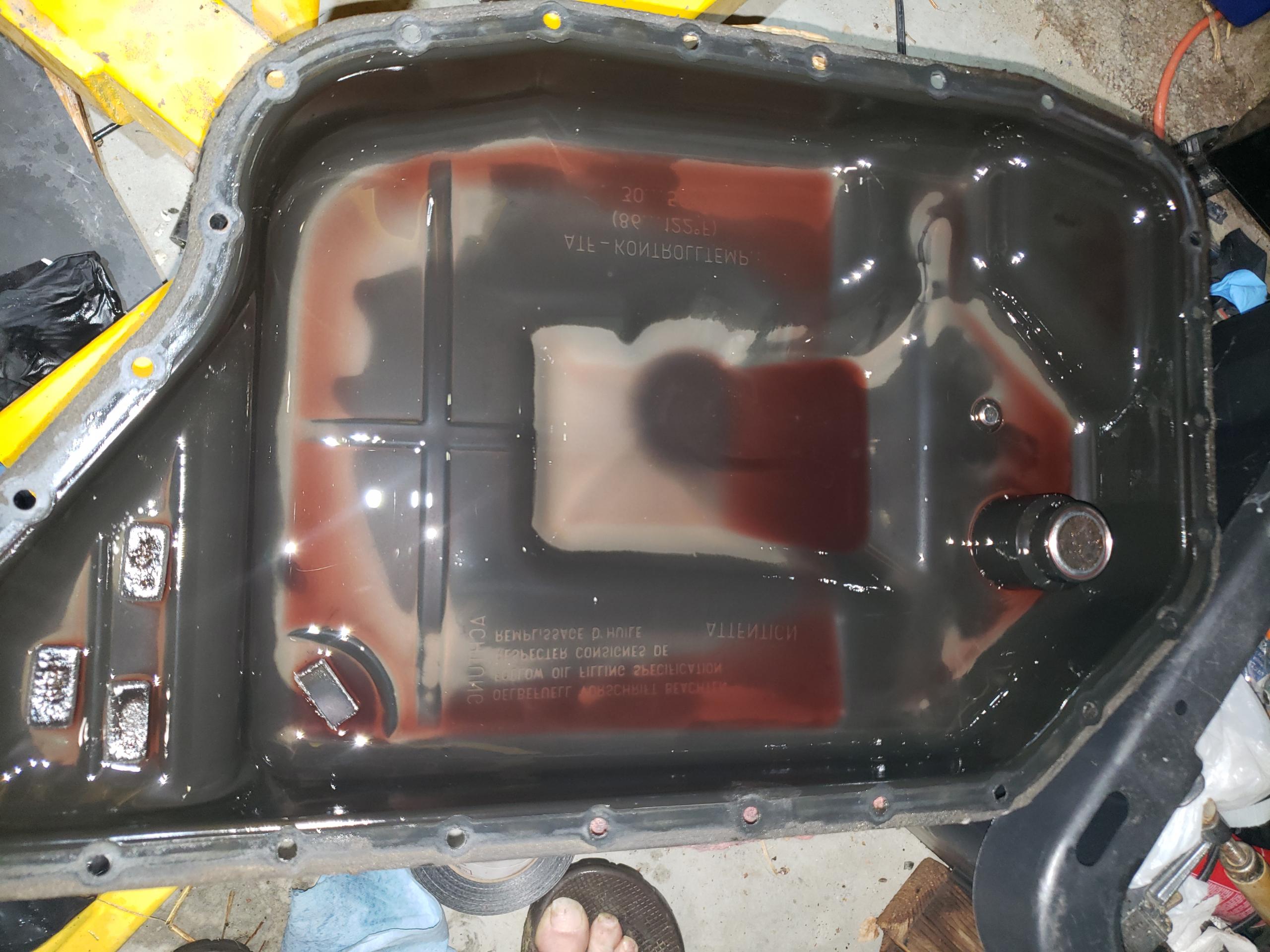

I know this isn't exactly how you're supposed to do this, but I (gently) ran 5 gallons through it before i dropped the pan. Wasn't fond of the idea of running half-dirty fluid through a new filter. Finally got the pan down, was expecting lota whisker shavings on my magnets but they're clean clean clean. Wonder why, maybe it's a newer trans. Will report results tomorrow.

Why is it so red? Are you using correct fluid?
https://sharena21.springcm.com/Publi...2-ac162d889bd1
Old 30th July 2020, 07:53 AM
The attached has the ZF recommendations for ATF. I havent checked it thoroughly but at first glance Im not sure that the Valvoline meets the requirements for the 5HP24.

Thanks, but LT 71141 is BMW's atf spec for that trans, for which this fluid has been actually certified, is that incorrect? This fluid has slightly higher vis. than the maxlife that people have been using with good sucess, not aware of any bad outcomes... Redline D4, a couple anecdotes. I've used the maxlife in the same trans in a mercedes, worked fine, that combined with the fact that I'm not superstitious by nature I'll let you all know tomorrow how it goes, planned to have it done tonight but the filter and meticulously cleaning and painting the pan, affixing the gasket, ate up a lot of time. Oh, and doing the same job getting the fluid clean with Pentosin, about 500$.
