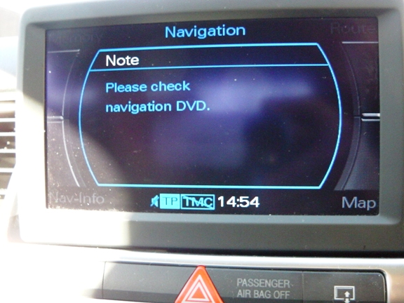

Well, I tried the burned nav disc that Mr Simpson kindly sent me........very nice people on here eh
Unfortunately, it didn't work
Just got the same 'Check navigation DVD' message on the screen.
Put the old DVD back in and everything's fine again.

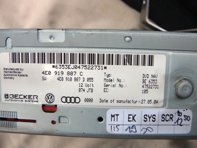

One thing I noticed, on a VCDS scan, it's the only module that doesn't have a coding. Not sure what that means?
Address 37: Navigation Labels: 4E0-910-88x-37.lbl
Part No SW: 4E0 910 887 D HW: 4E0 919 887 C
Component: MNS ECE H43 0550
Revision: 00000000 Serial number: 353EJ047522731
Shop #: WSC 02313 785 00200
VCID: 2E05097BDC17BBEBD1E-807A
No fault code found.
Out of interest, here's the nav player unit details:
What to do next I wonder.

Original discs are pressed not burned and so have more pronounced dips and peaks so even old lasers can pick them up. Sometimes it helps when burning at slower speed as more time is spent for each bit and some drives or media can produce better results.

Also the Nav unit uses Adaptation Channels to set its parameters, rather than using a coding value like other modules. Hence no coding.
You can do a DVD read test by using Channel 065 and value 2 for short test, value 1 for a long test.

. And, does that mean unofficial discs sometimes don't work because they are burned (instead of pressed), and don't get the proper info for the nav player to recognise it, as Ainarsemms mentioned?
Burned discs will contain the same info it's just that old weak(ish) lasers cannot read them reliably.
I might not be 100% corect but original discs are pressed with template to create dips and peaks, then covered with relective layer. When you burn recordable or rewritable discs they are already coated and you create dips and peaks afterwards.
