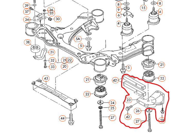

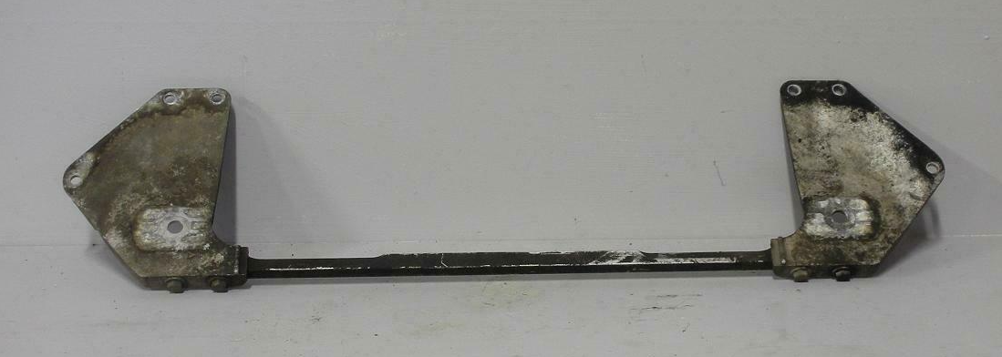

Have done a bit of looking into this. But can't quite picture it all. Is this the brace/support of which you speak?
And in the exploded diagram:
If I am right, I can't picture what holes might be missing on the subframe. Which means I'm looking at it wrong, of course. To me it appears that the rearmost 3 holes must go into the bodyshell/floorpan, the middle large one must be there for the main mounting bolt through the rear bush and the frontmost 2 (bolts #42) are part of the brace itself.
Can you correct my vision, please?

Part 43. The captive nuts are hidden between the gearbox mount (4) and the subframe, in the flange where #5 goes
