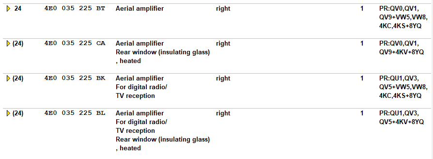

Anyway, back to quattronutter's original query. I've had a look at all the options for the antennae on the A8/S8 and couldn't figure out how to explain the options available, so I cheated and just did screenshots. There are two sets, one for part 23 and one for part 24. Please note that there is nothing to explain exactly what parts you require for each option.
Each set of images has one image showing all the possibilities for that part (23 or 24) and then has a set of images for each of the variations of that part, and the criteria, even down to the type of glass. For those images, the exact part number is reproduced in the blue top border. You may also notice that some of the FZS codes are missing off the top of some of the images. That's because you can't resize the window and since all the FZS codes are the same, I just scrolled down to get the rest in. The filenames for the images match the relevant image for clarity. All this will either help you or put you off!

Cheers! Looks as though i need the extra aerial for tv,i have dab aerial but it only has one spare connection,where are people hooking the optic cable to for the hybrid tuner?

I have everything fitted and have an oem aerial loom and figured which aerials are needed for a retrofit just need to find some as im sure new ones are not cheap

Parts 23 and 24 range from £127 to £270 depending on which variant it is.

4E0 035 225 BL and 4E0 035 225 BQ are needed

Dealer price for each of those is £270. There's a secondhand BQ one on eBay:
https://www.ebay.co.uk/itm/184554884603
