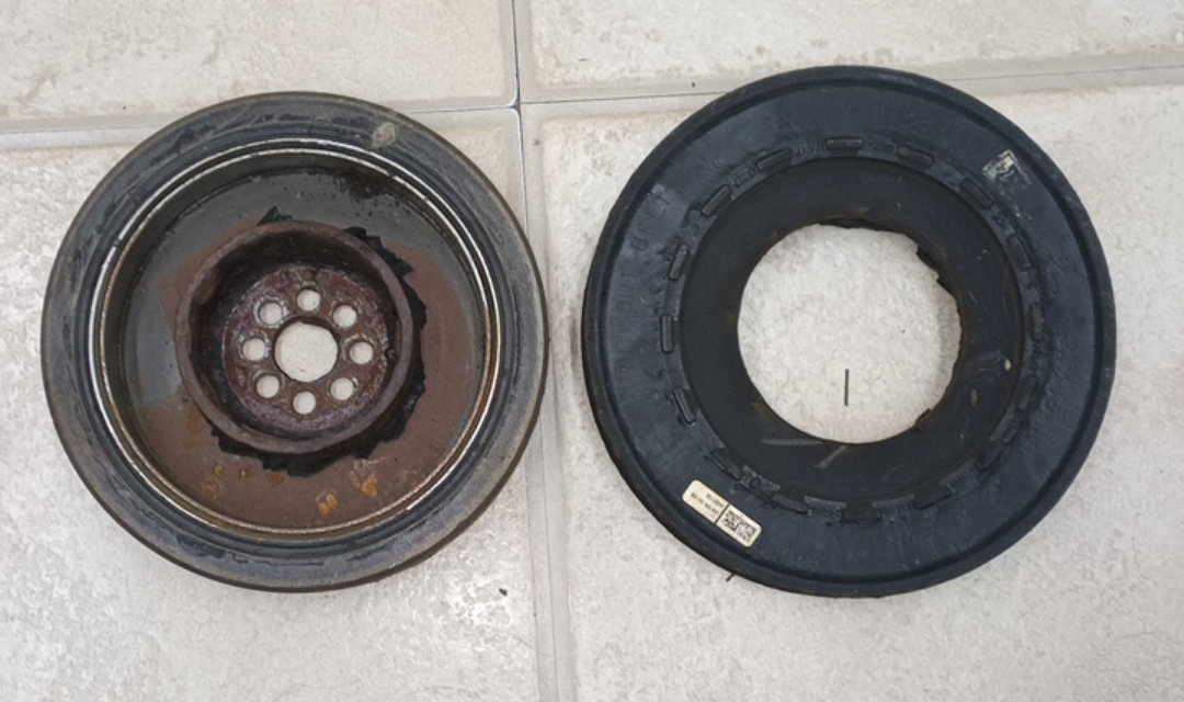

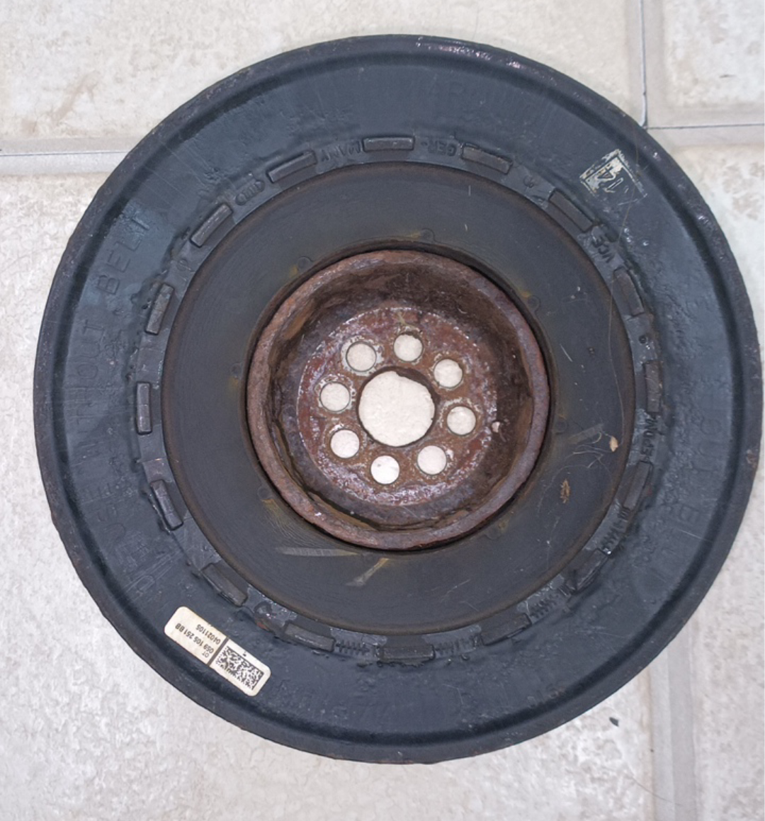

I never seen PS pump fail in such a way. Usually they either become noisy or start leaking. You have several issues that all point to belt drive. You say belt is still in place so maybe it is slipping. Have you or mechanic checked crankshaft pulley? It's 2 parts steel connected by rubber for vibration dampening. It's common failure point not just for Audi but many diesel cars, happened to missis Q7 3.0TDI and also friends A6 3.0TDI. Usually the rubber splits or becomes detached from steel and outer part just falls off but I suppose it might be possible that it stays in place just slips around. When there is little load, low rpm it might be turning belt but as load increases it just slips.
Maybe get another mechanic for second opinion.
Old 26th November 2022, 07:38 PM
I have attached the pictures of failed pulley from Q7. 1 both parts together and then separated

Had a look with the mechanic today and it's the crank pulley that's going in and out and fouling a metal pipe that runs behind the radiator. The belt and all pulleys spin away no problem until the steering wheel is turned and then the belt stops dead.
With these pulleys known for failing, does anyone know of any improved upgrade on the original?
