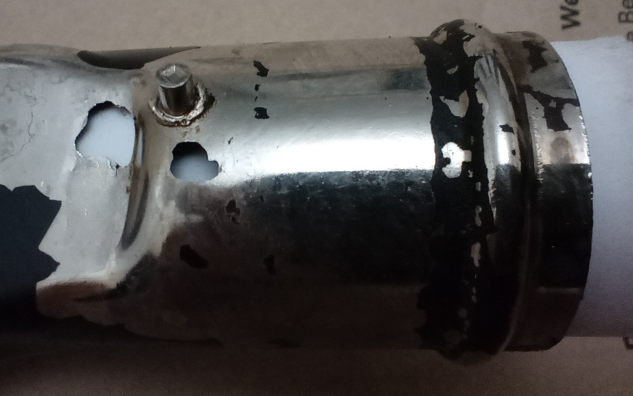

I've attached a couple of photos of the pipe, both from the outside and inside, using some white paper to make the holes, yes plural, stand out. They are about 3x4mm and 5x6mm in size, with the smaller one just covered by the rubber hose. I gave the inside of the pipe a wipe with a rag which explains the colour difference further down.

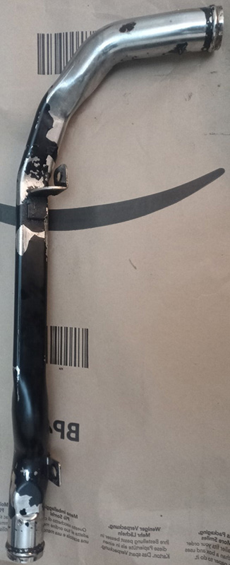

The end you see (with the holes) connects to a rubber hose that attaches to the top of the radiator. It then runs down the left side of the engine, does a 90 degree turn and connects to another rubber pipe at the back of the engine. The pipe is L-shaped, measuring about 46cm x 17cm x 3cm diameter. Looking at the pipe from just below each barcode in the background, the pipe is triangular in shape. I've flipped this image of the entire pipe so that it looks the same way it would sit in the engine bay.

isnt that pite stainnless? how dod it rust?
