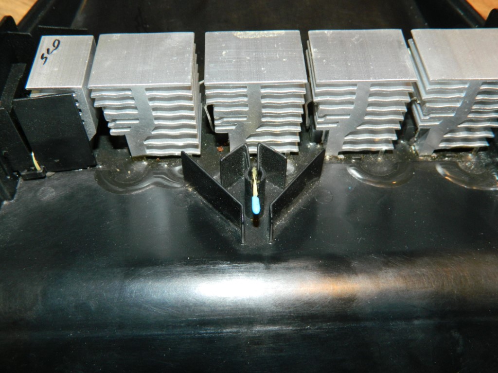

I've only listed the modules with errors and the only non-usual errors listed are Parking Brake and Alarm Horn. I haven't done a physical investigation yet but the rear discs and pads were only done 7k miles ago. The horn error has me baffled also, as car has no problem chirping when locking.
012597 - The following post seems to imply that it's related to wear and tear with the stepper motors, but they also mention how they cleared it (at least on a temporary basis): https://forums.ross-tech.com/index.php?threads/12151/
00065/00066 - Common fault. The 'heaters' are nothing more than a bank of transistors attached to a bank of heatsinks and encased in an epoxy, and they burn out after time. This is what they look like inside:
01134 - Tends to mean that the battery inside the unit is starting to corrode, and you'll eventually be getting the alarm going off by itself for no apparent reason. If you don't already know, the alarm is situated in the plenum chamber on the passenger side, in the very far corner.
02596 - Never experienced this, but since the pads are reasonably new, then the likely cause is the adaptation was either never done or the wrong value entered when the pads were fitted.
Name:	A8D3 Rear Foot Heater.jpg
