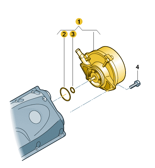

ainarssems back in post #2 hinted at a possible vacuum leak. Do you know if they investigated that possibility?
Looking at the 4.2tdi, there is a vacuum pipe (#2 & 3 in the first image) with a non-return valve from the brake reservoir to the mechanical vacuum pump. Cars that have stop/start have a pressure sensor on them (PR code: 7L8).
There is also the vacuum pump itself (second image), although I can't find a decent image of where it is located on your engine. The following video shows what it looks like, but this was on a FSI engine. It might be worth checking those areas for vacuum leaks.
https://www.youtube.com/watch?v=EvfFk3ZJP6o
