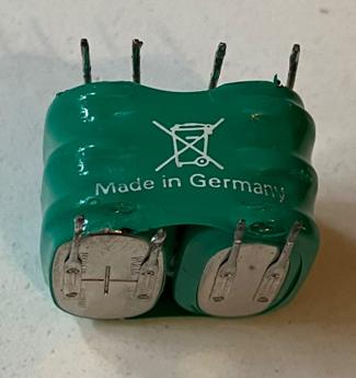

There is Rocking Horse Poo, and I found some! Though I have no recollection of how/when I got it.
Anyone know exactly what this is, I found it today while looking for something completely unrelated!

Old 31st May 2024, 04:12 PM
sarg sarg is offline
Posts: 2,086
Is it a 4-pack of German lager?
2002 Mark's D2 S8 FE
2000 FL D2 4.2 QS - SOLD 2011
Old 31st May 2024, 05:18 PM
It says don't recycle, whereas all beer gets recycled quite quickly!
