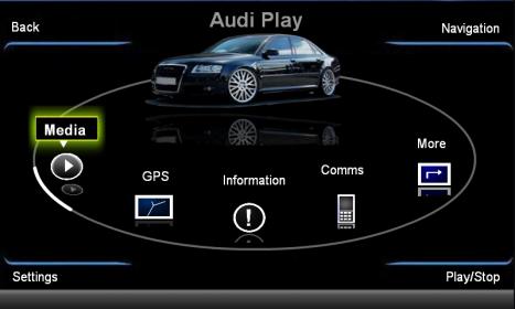

made some changes, it is now a flash version of the skin, still running on riderunner, but is now configurable, and thanks to piccys of MMI , is even closer to the real MMI. added bar at the bottom for indicators, and almost everything you see is configurable
For those with touchscreen, you just add a line to the config file and it will behave slightly differently, and will give an option of more buttons.
