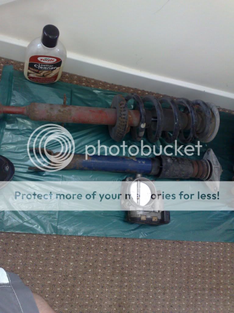

i will investigate now and post a picture but yes they are both Boge and fronts are red rears are blue pic to follow in 5 mins :-)

Front numbers are 4D0 513031 H
rear 4D0 413 031 AR
but there is also a number just above that aswel on both
blue and red see ... strange

My fronts that were taken out were red too Guy, I havnt looked at the rears yet as I've still got them to swap over some time

4D0 513 031 H used on 1994-1999 A8/A8Q with sports suspension and S8 up to chassis no 4D-T-011 000 with engine codes AEW(3.7) and ABZ,AEM,AGH(4.2),and AHC(S8). So basically they are from PF S8 or A8 with sports suspension.
4D0 413 031 AR used on 1994-1999 A8/A8Q with sports suspension and S8 engine codes AEW,AKJ(3.7),AFB(2.8),ABZ,AEM,AGH,AKG(4.2),and AHC,AKH(S8). Says marked red so should be all red or with a red mark somewhere.
I can see there are 1 white and 2 (4D0 411 105 BD) or 3 (4D0 411 105 BE) silver dots on springs which could be on variety of combinations with sports suspension with or without aircon, only with auto gearboxes and depending on chassis number and with front axle weight category 10 or 11 which depends on optional equipment fitted.

I think they will fit physically but they were not designed for FL car so probably will be different spring rate and shock bound/rebound rate might be different, could be better or worse also depending on what you were trying to achieve, I guess better handling.
For better handling I would start with stiffest rear anti-roll bar and poly bushes for it to reduce understeer, then front arb with poly bushes, then rest of bushes changed to poly and last fully adjustable coilovers. If I understand correctly you already had sports suspension in which case it does not make much sense to change it for another OEM suspension.
