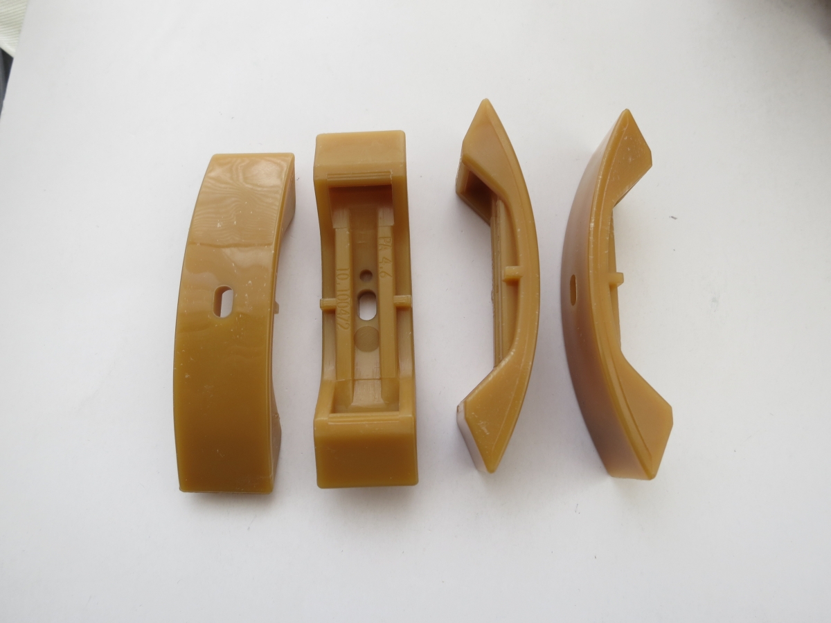

I caved in and ordered these pads. There is no way I was going to give Audi another £950 for 2 chain tensioner units when my old ones appear to be working just fine.
http://www.cs-parts.de/index.php?a=237
They are going into my car shortly, I plan to open up cam covers in around 1 years time to check how they are doing.
If anyone else is contemplating changing their pads, and is determined to have original Audi pads, there is a middle way. Ask your Audi dealer for part no. 058109217B or 058109217D, the price of each unit is £140 + Vat, if they can do you a discount it may be possible for around £300 for the pair. You could then try to sell the units on ebay to anyone who wants a discounted genuine unit but is happy to risk aftermarket pads.
Picture of cs-parts.de pads

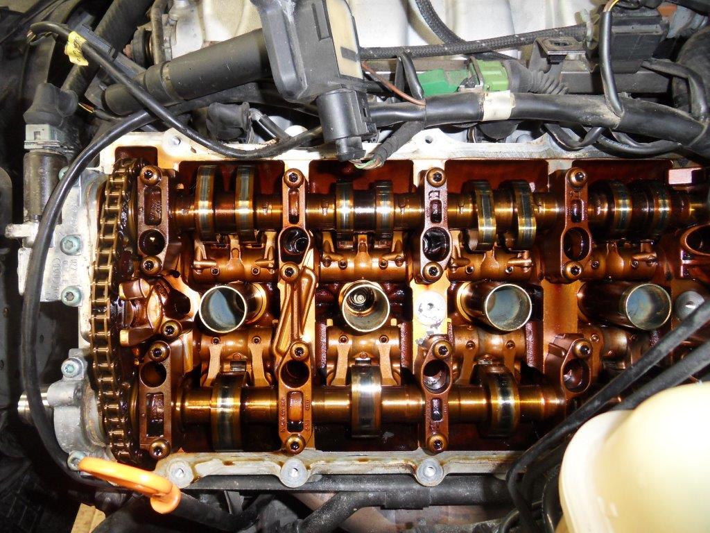

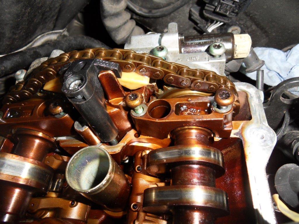

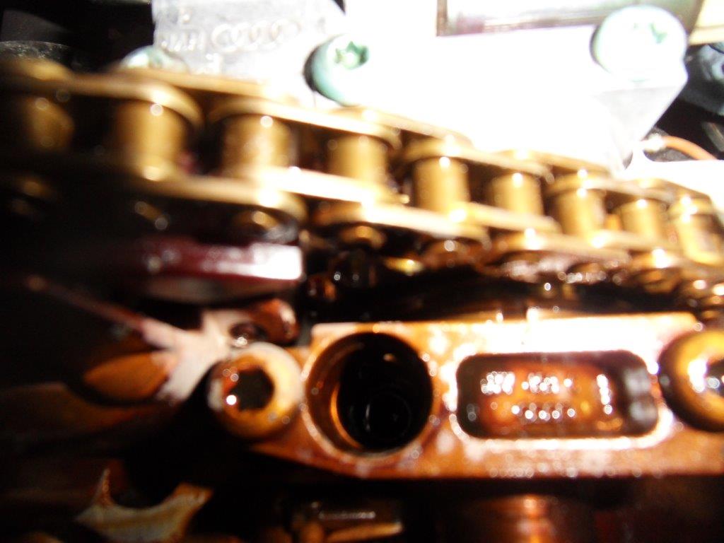

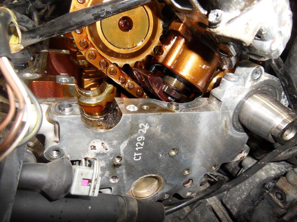

Old 21st April 2014, 05:37 PM

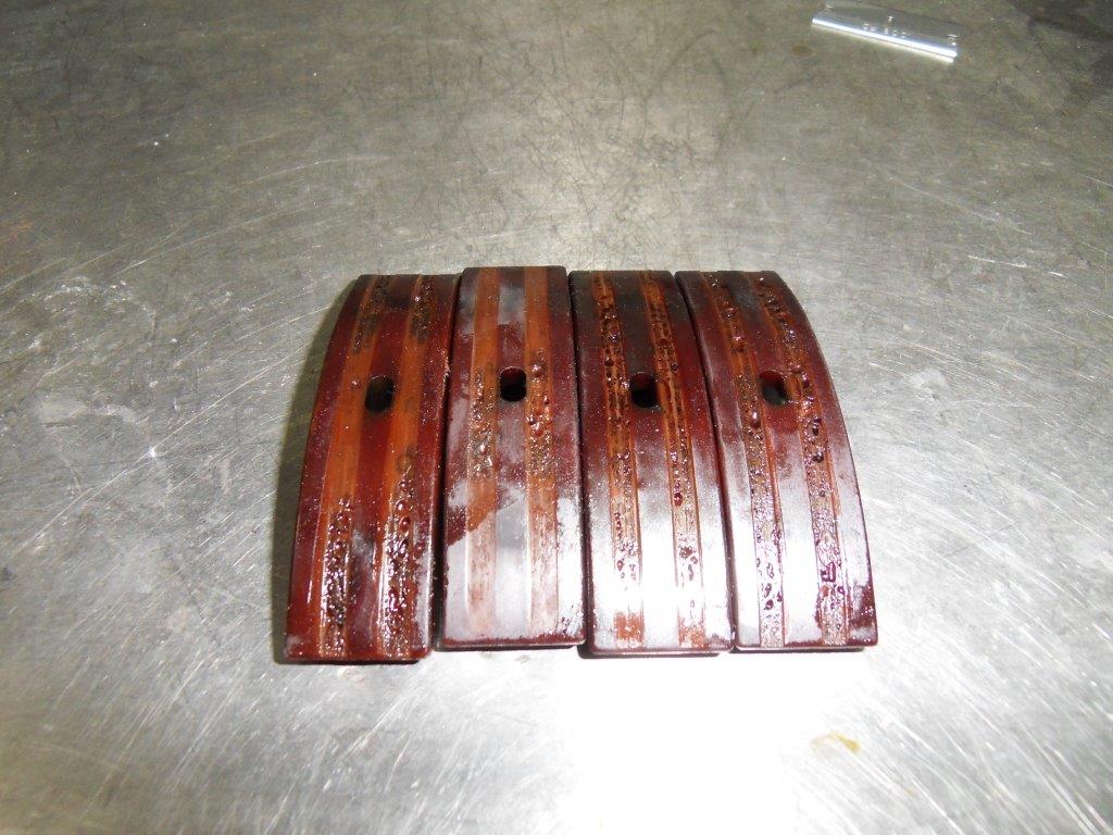

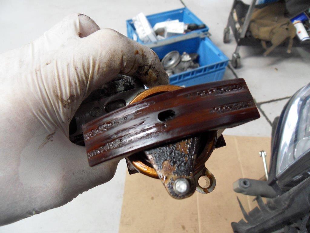

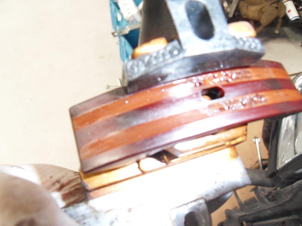

I have had my pads changed at MRC. Surprisingly it only took them 4 hours, for both banks, I was expecting it to take longer considering the complexity.
So total cost was 4 x £68 x 1.2 = £326 plus 20 euro for 4 pads.
Here are some pictures, these pads taken out at 120k look a little better than from my other S8, those were pitted at the top too and one had a large crack developing.
I am a engine hypochondriac, so for me this preventative maintenance was worth it for the peace of mind.
I would still like to try removing the pads without unbolting cams. If someone has a old or damaged head, either side, I dont mind driving over to try this procedure. I have 2 old tensioner units and the tensioner tool.
