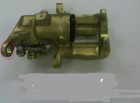

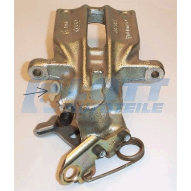

Well they don't fit, and the handbrake cable connection is in a different place.
I'll happily send them on to you if you want it'll save me sending them back
Sorry,I though we have moved on to talk about the http://www.ebay.co.uk/itm/AUDI-100-A...#ht_978wt_1163 link showing caliper carrier. My bad
Old 1st November 2011, 10:34 AM
I know it's hard to see from the pic's but if you look at the jaw opening, 2 pads and a vented disc to go in there. They would be fully rewound wouldn't they???
