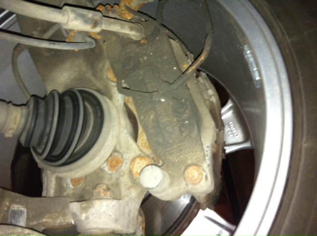

Sorry, they're 18"s. I was quickly trying to answer on my iPhone at work
Got underneath tonight and it looks like the hub is different as the calliper and carrier are bolted on from the side, not the back like the brembo. I've taken a picture. So, next question... will the newer Brembo compatable hub swap over?
Cheers for the replies.

take a look at THIS thread from when Oli upgraded his brakes and had to change hub carriers - sounds like you may have the same issue?

I read that earlier actually and I think you're right. I've enquired about a price for the callipers, rotors and hubs. From reading a few other things, it would appear that the hubs are the same apart from calliper mount so should swap straight over.
Old 2nd December 2011, 08:21 AM
As Neil says, looks like you need to follow the same route as Oli, good thing is it's all 'plug and play' under there for the repacements
