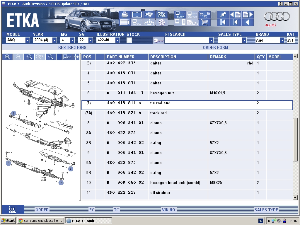

Well after finding that the Track rod end on the near side has warn out and split we think that is whats making the squeaking noise so now i have a question
witch track rod end will fit ?
are the W12 track rod ends any different or are they standard D3 items

Their reference number 4D0419811G does not come up in ETKA. Also strange years listed 1984, 1984, 1985, 1986, 1987, 1988, 1989, 1990, 1991

No reference numbers in their listing. It looks like there are 2 possibilities depending on chassis number. Which year was yours?

2004 looks like there is only one version, I must have been looking at different year or something.

very helpful thanks for that i can just phone them up i think and make sure its that part number
