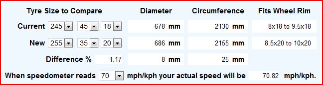

In that case I would keep the new tyres to 255 35 20's that way you'll reduce risk of a wider tyre catching and as you see below the difference between those and the 18" sport wheels is minimal and within tolerances -
In that case I will go with some illegal spacers instead... donīt really have a budget for another Ģ1200 for tyres this summer
