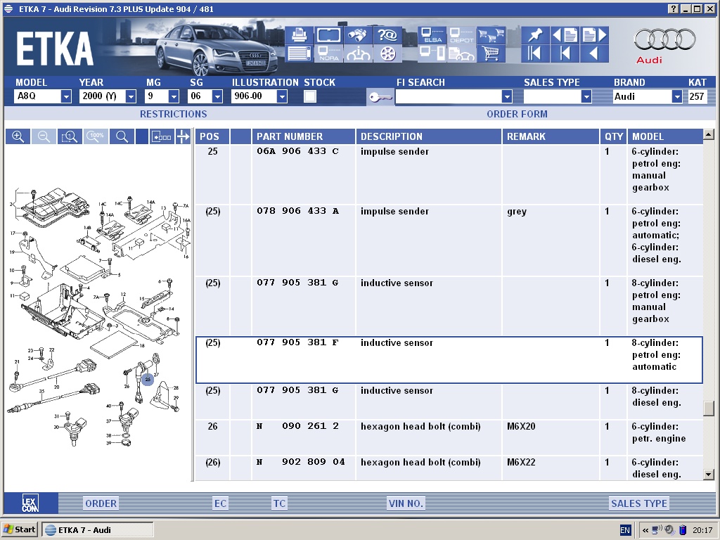

The one Neil posted is camshaft position sensor. It could be causing the problem as well. I would not be throwing money around before diagnosing the exact fault. Anyway crank sensor would be this one:
I've taken your advice and booked it in with Unit 20. The probability is the crank sensor but just to be sure.
Thanks for placing that seed of doubt ainarssems
