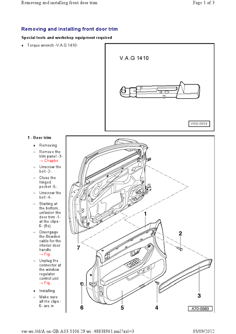

Really sorry guys for taking so much space, but I'm using iPad for Internet and it doesn't allows you to attach the files as a attachments, I can only upload them directly so they can be seen in full size in the actual post.
This is all I found, removing the mirror including all the steps such as door trim etc.
Hope that really helps as I've got little time to look into it in more detail, will speak to you later

So, I had a go at this today and I had my driver's door completely in pieces. I can't believe how well built and sturdy the D3 is...it does make this job quite a bit more difficult.
I got stuck unfortunately.... I got the interior trim, door card, B&O speaker and exterior mirror housing off but I could not for the life of me work out how to pull the mirror wire (#4 below)through the door to take it off....
Would anyone know?
Guy, did you take off the entire mirror assembly or just swap covers?
