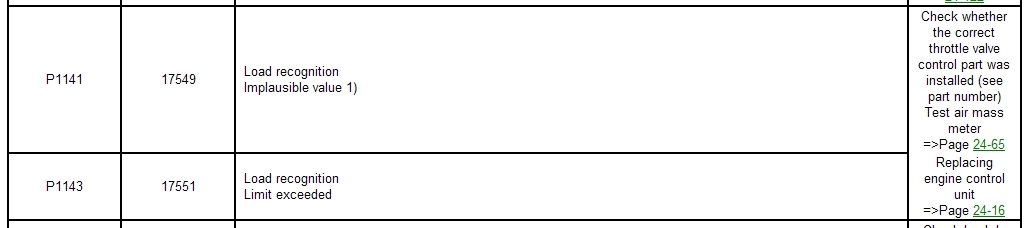

The values are a bit on the high side, it might be just on borderline to cause error.
More on the error code
and some pdf's that might help you
