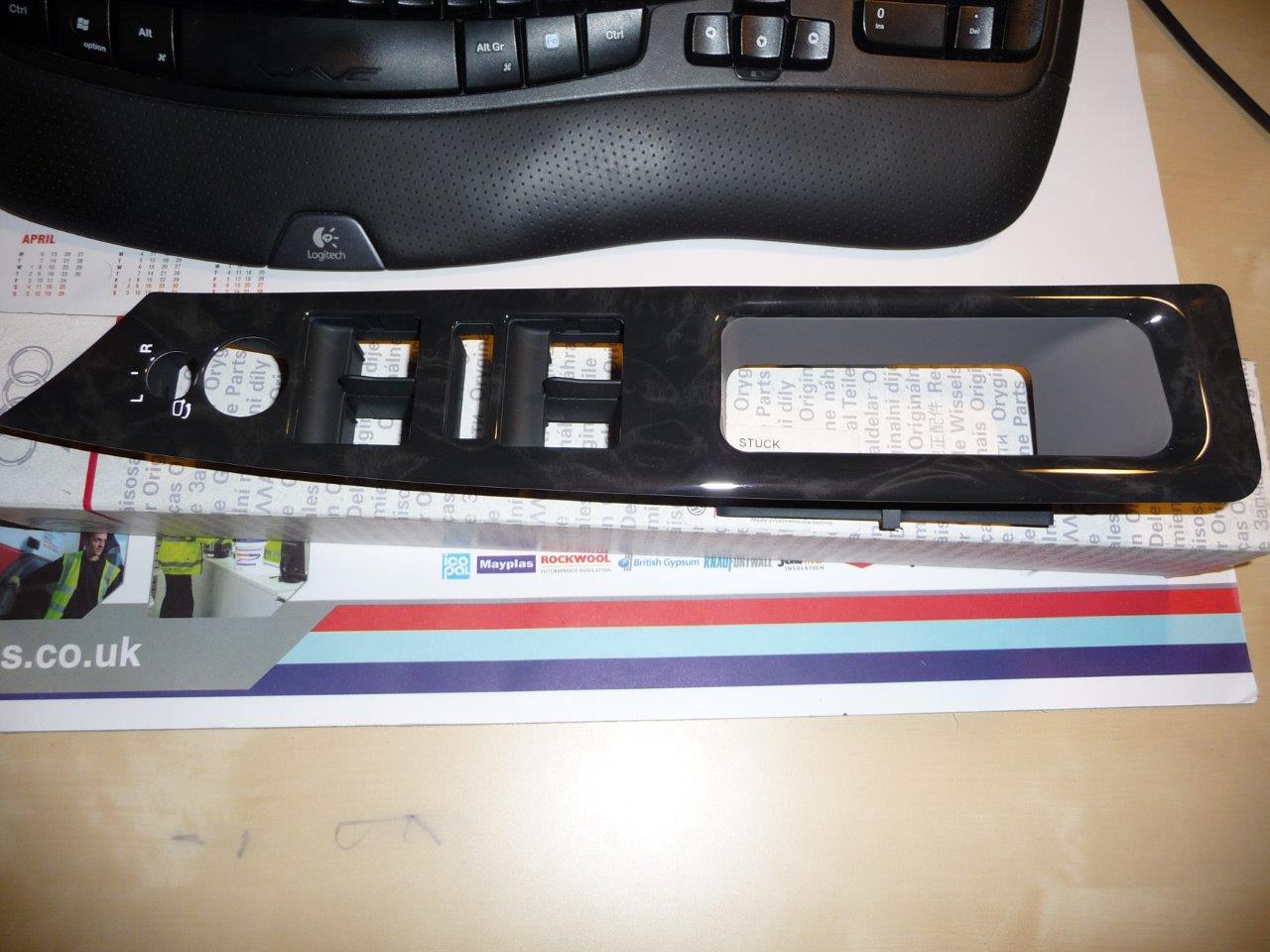

Have finally bitten the bullet and ordered the brand new wood trim for the driver's door - worked out about £6 more expensive to order through the Audi Tradition shop than it would've been to get it from TPS, but given delivery is 25 Euros the part itself is actually cheaper.
Hopefully have it by the weekend (I expect it to be delivered by Certified virginal maiden given the wretched cost!) and can get it fitted
Old 15th October 2013, 01:12 PM
Interesting. Let us know experience with audi tradition shop when the item arrives.
Old 21st October 2013, 10:44 PM
Well the new trim finally arrived today
If you order anything from Audi Tradition assume the status of your order won't change before it arrives on your doorstep!
Looks spot on and very happy with it - just need the lower trim to match but will fit this next weekend and put the purple one back for now.

Finally changed the driver's door trim today, dodging heavy showers while I did it....
Glad I left it till last as you've obviously got 6 different connections to remove and a lot less wiggle room for getting all the electrics out of the aperture. Unplugging everything is easy enough once you've taken a pic of which window plug goes where. Did the rest on the bench as I knew there'd be some effort to get the switches out.
Worst one to remove is the rear window lock out - fiddly as it's got clips holding the loom to the switch when you remove it and also tricky to release the tabs holding the switch in place. Ended up needing screwdriver up the short edge of the switch and you can do one side at a time to release it.
Cleaned all the switches before putting them back. Getting the panel back in was tricky with the extended leather as it makes it a tighter fit. Finally managed it and got the lower shell (still purple for now) back in place easily now I know how to do it!
Pics below
