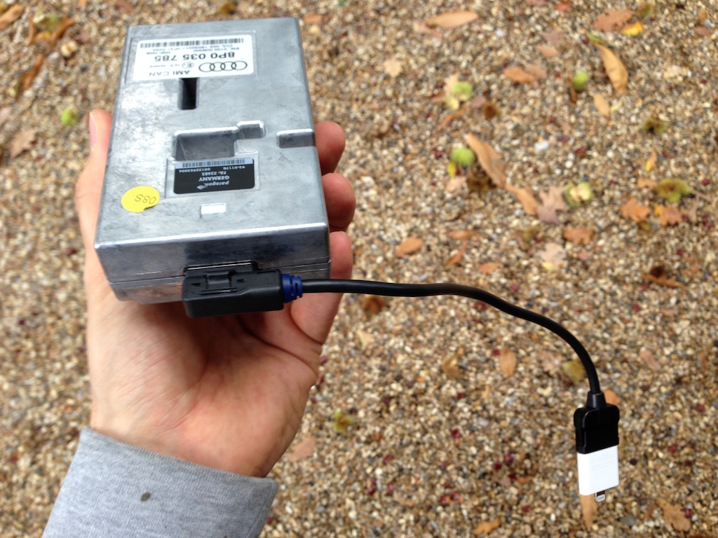

It's very high quality stuff. It's made in Germany. And it's quite modern.
Old 26th October 2013, 08:03 AM
Looks like some sort of AMI cable, but I'm not familiar with those systems.
Old 26th October 2013, 08:20 AM
Well, it's time to get familiar with AMI

Old 26th October 2013, 08:42 AM
Nice one is the hdd inside that enclosure too?
Do Audi make a 5/5s cable? I bought one of those adaptors (genuine apple) and you can't use it with a bumper on the phone - even Apple's own one!

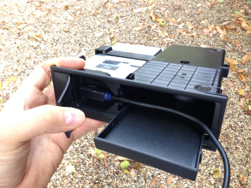

Old 26th October 2013, 09:02 AM
AMI is essentially a media player with beautiful integration with mobile phones, hard drives etc. It has Line-Out that can be connected to anywhere you want. But if we connect it to RNS-E 2010+ with a couple of CAN bus wires we get perfect integration.
There is no hdd inside, but you can connect hdd full of WMA or MP3 files with another cable. And three's plenty of space for hdds and stuff in that D2 driver side shelf! I like that shelf much more convenient than glove box, as it's for the driver
There's even a solution for A2DP bluetooth streaming -- p/n 4F0 051 510 J.
I haven't seen one. How about lighting extension lead?
Bumper with iPhone -- this is such a bad taste -- I don't get it
