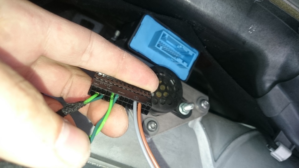

You need to get back to the headlight connectors again as there are extra 4 wires to be run per headlight:
- 1x earth
- 1x live feed
- 2x CAN BUS wires

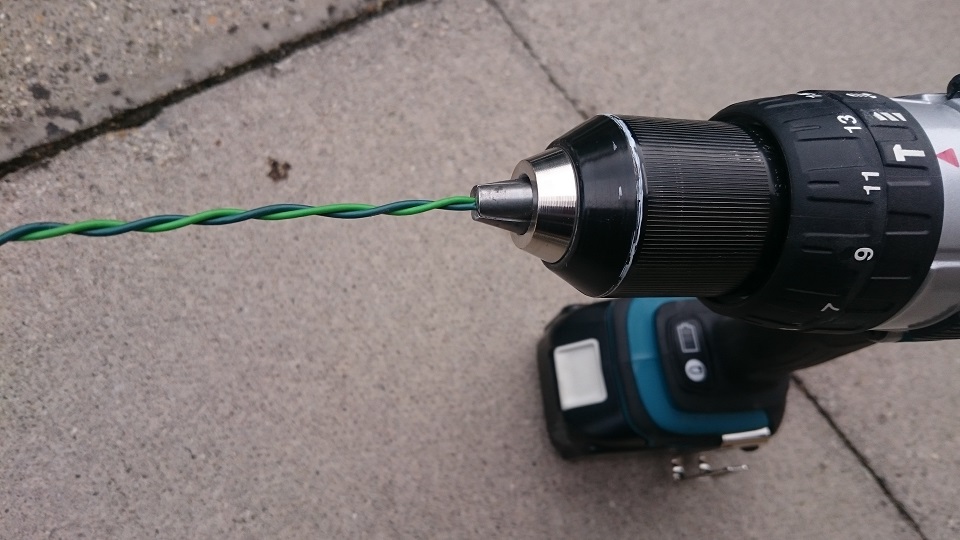

Earth and live feed are just straight runs, but CAN wires MUST BE TWISTED together before taping them together with live and earth using cloth tape.

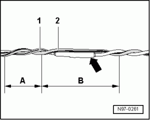

Quick guide to CAN wiring.
Each complete twist cannot be longer than 20mm (A) picture below.
Make sure you have someone to help you if you will be using drill like I did so you don't end up having half of the run having more compact twists then the other end. Be very careful not to over do it/damage the cable, TAKE YOUR TIME.

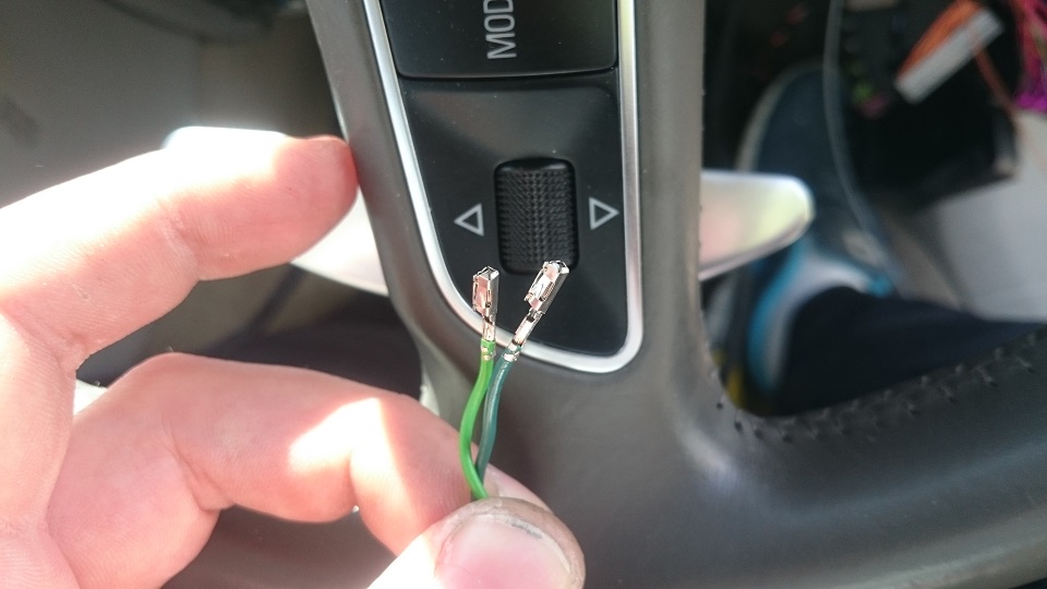

For can wires you must use either 0.35mm2 or 0.5mm2 cable, I've used 0.5mm2
All can wires on the D3 have two colours no matter what component they go to, one is CAN Low and one CAN high, if I remember correctly they are Orange/Black and Orange/Brown.
I've used Bright Green an Dark Green wires.
For Earth I've used 1.0mm2 Brown wire (both headlights).
For Live I've used 1.0mm2 Grey and Black wires (Grey for left and Black for Right headlight for easier identification as they need separate fuse on the fuse box). They got to fuse slot 43 and 44 (see chart on the inside of the fuse box cover), but thats on LHD car, not sure if RHD cars have them fuses on the same side.
You will have to join CAN wires from left and right headlight somewhere, I did it behind the glove box, but you also must ensure that each untwisted section/joint is no longer than 50mm (B) picture below.
There is only one pair of CAN wires going to the Headlight Range Module, left and right do the same thing so module only needs one CAN Low and one CAN High signal even if a pair from each headlight is required.
So pin 1 and 2 are your CAN wires 0.5mm2
Pin 4 is Live 1.0mm2
Pin 14 is Earth 1.0mm2

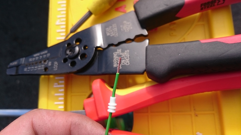

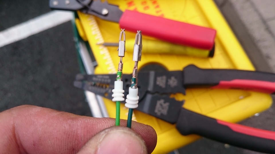

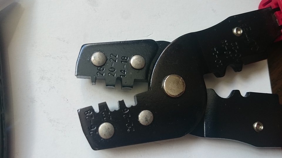

Make sure you have selection of terminal connectors as per original post (grey case with all the connectors). A lot of them look the same but they are for different thickness wires - you will same type but different version for CAN and live/earth wires which are 1.0mm2, CAN 0.5mm2 as mentioned earlier.
Make sure you have correct crimping tool for JPT terminals and waterproof seals for wires for the headlight connectors.
Tool

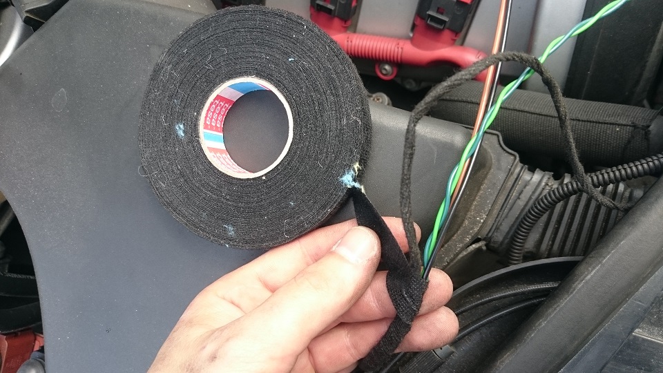

Seal first then strip approx. 10mm of insulation and crimp very well terminal connector.

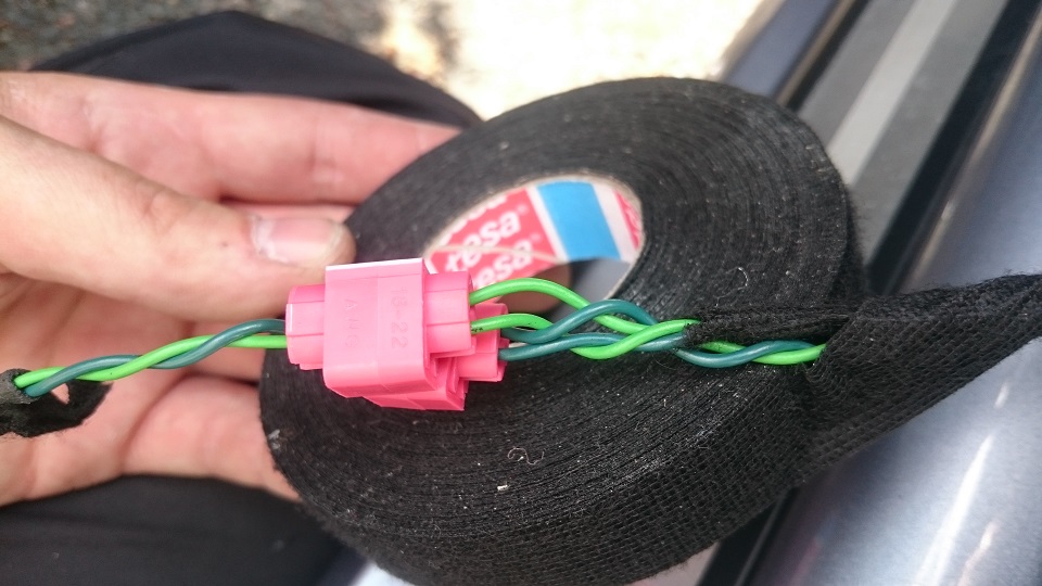

Twist can wires and tape them together.
Note that CAN wires go to range module behind the cluster where live goes to fuse box to the side of the dashboard and brown earth to the inside of the pillar on the passenger side near the door hinges (both earth and both live).
So its a good idea to keep them all taped together inside the engine bay, where its not best to tape the entire length of all wires. You can see I ended up with tapped bunch of CAN wires inside the car and a separate bunch of live and earth.

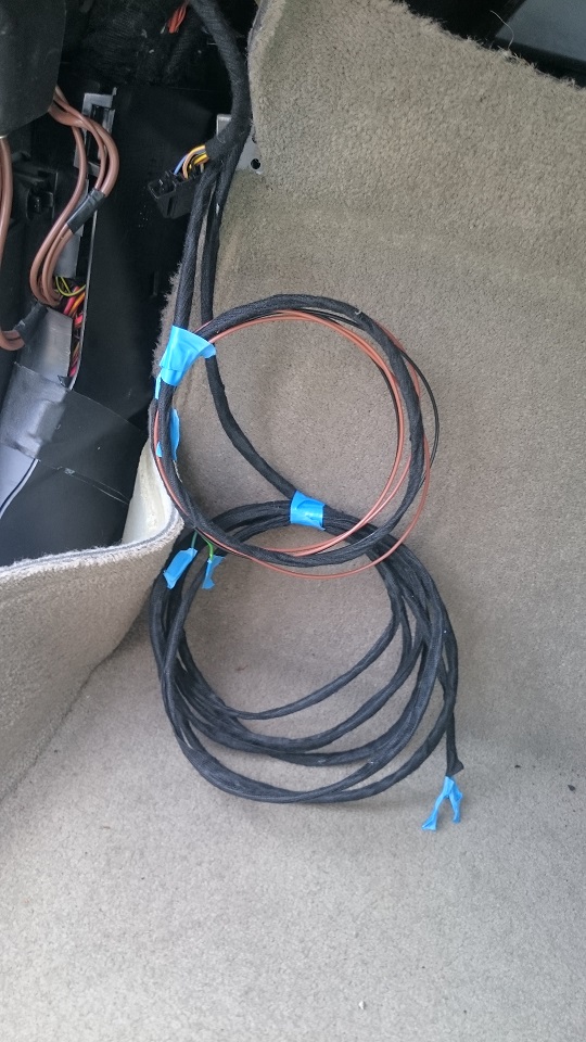

Length of wires.
Allow 6m each CAN pair per headlight
Allow 4m each Earth and Live pair per headlight.
Note, this are the lengths for LHD cars !!!

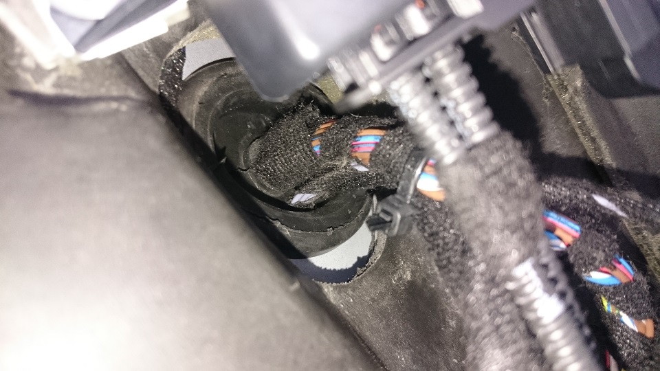

- entry point from engine bay will be on the opposite side and if so CAN harness can be reduced to 4m and if fuses for Live wires and opposite entry point are on the right side not left as on LHD cars then Live and Earth hrness can be reduced to 4m from 6m.
You get me, don't you??
Use the same entry point on passenger side under the windscreen behind the alarm siren making sure when all cables are thru a water tight seal done. I've used all weather black flexible sealant for outdoor use (not silicon) on the silicon gun and nozzle, enough so you see it coming thru on the inside of the car, pic 2.
Cable tie new wires to existing harness.
That is all done inside the engine bay.

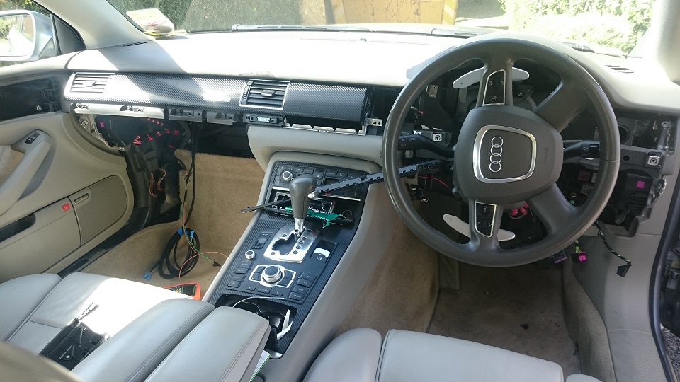

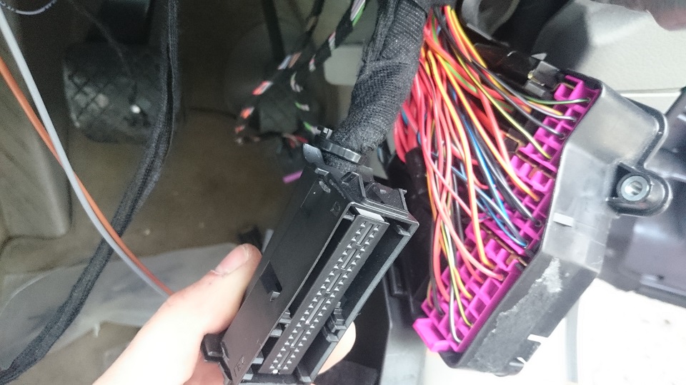

Remove the glove box, trim under the steering wheel and remove cluster.
Fit Headlight Range module if you haven't yet.
If you have one and upgrading from AFS I to AFS II you will still need access to it/need one.
Note, you dont need the mounting bracket for the Range Module even if you havent got one as standard as there will be one already with the buzzer fitted.

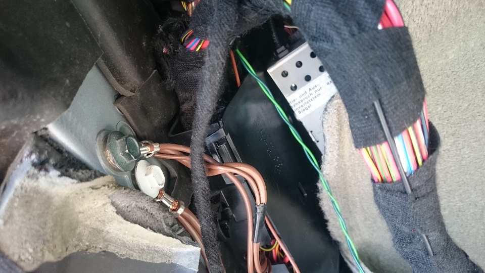

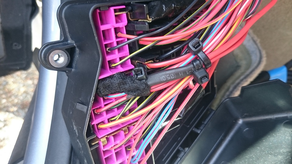

Live and earth first.

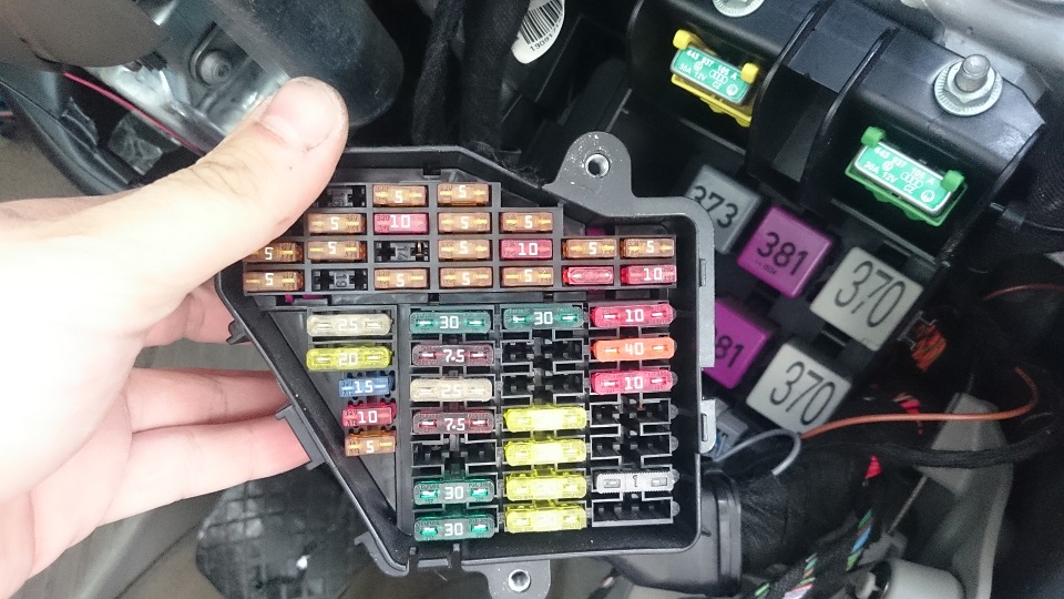

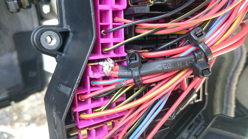

On the A pillar there are earth points, thats where both (left and right headlight) brown wires go.

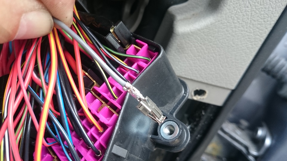

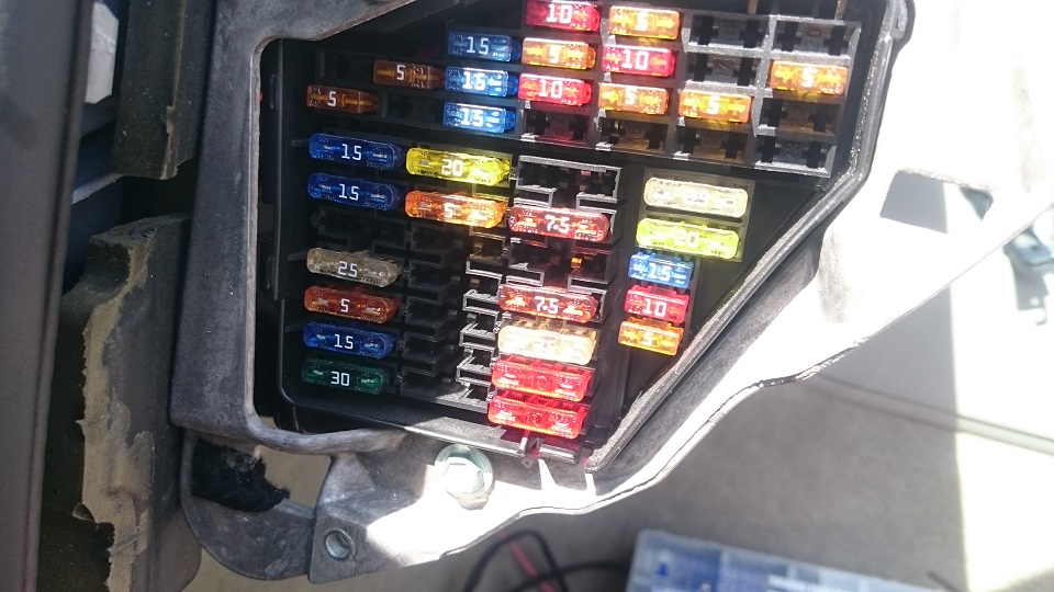

The fuses (live supply) are located on the passenger side fuse box. See chart on the back of the fuse box cover, fuse 43 and 44 if I remember correctly.
You will need to locate a Live supply bar on the back of the fuse box with CONSTANT LIVE not ignition live.
If you use ignition live dont worry too much (of course its not like it should be by OEM standards), but you will get Adaptive Headlights Malfunction warning light if you turn the ignition and headlights, but DON'T start the engine, as there won't be live supply to AFS modules until engine is running.
But as soon you start the engine the fault will disappear and it won't be even recorded in the module. So in case of using ignition live if you start the engine before switching the headlight on there wont be such a issue.
Don't get to confused about it, just use constant live feed instead of ignition live feed.

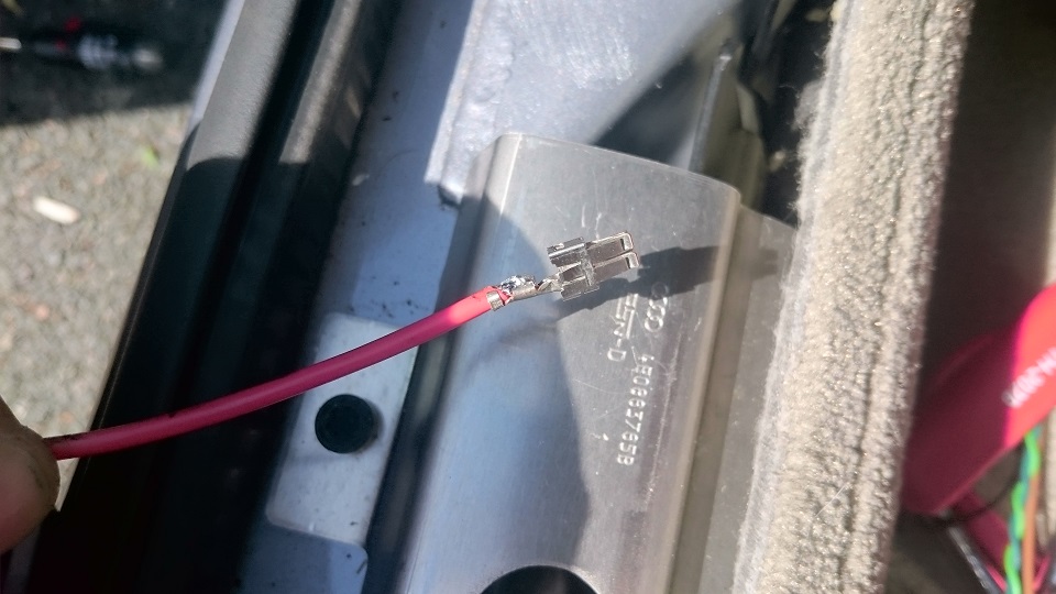

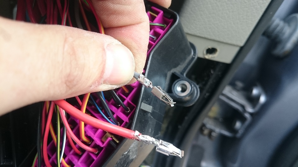

I've used heat shrink wrap and cable ties before soldering on both Live feeds onto the Live plate on the back of the fuse box and then wrap it up nicely with the cloth tape.
Then crimp on double female terminal connector onto each live red wire.
I've used here 2.5mm2 red wire if I remember correctly, both about 20cm long.
Then placed each wire in slot for fuse 43 and 44 on one side, thats the supply.
Black and Grey wire from each headlight will go to the other side (other leg of each fuse) for each fuse slot.
Bottom right corner is where the both fuses are prepared.
Bottom right corner again, 10A red fuse for each headlight.

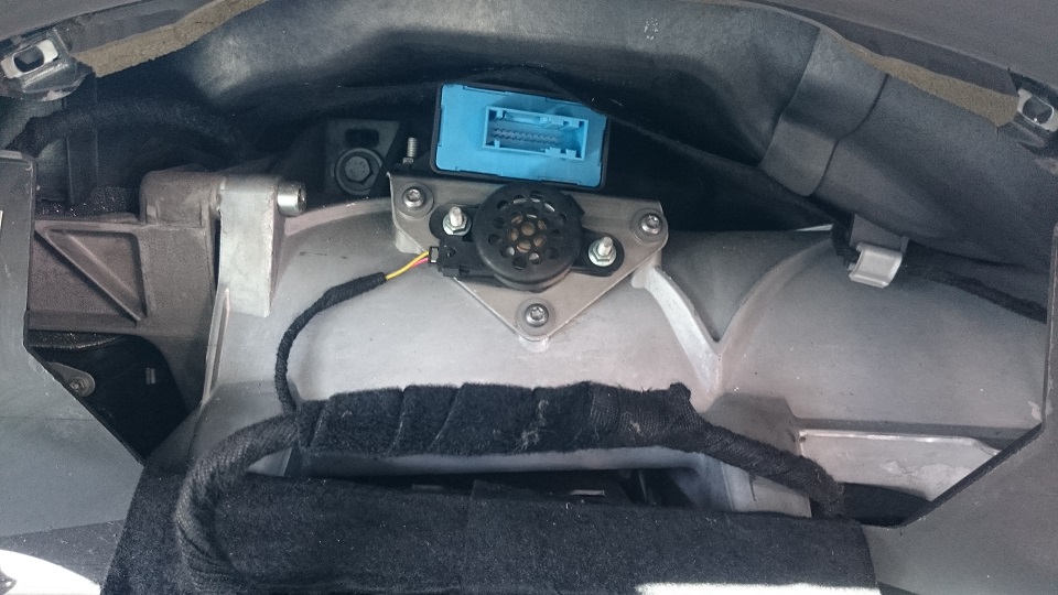

Now to the wiring of Xenon Range Module
Your choice on the location, I did it behind the glove box while its removed, cut short one pair of CAN wires and join it with the other pair so you will end up only with one pair full length going to the module behind the cluster.
Solder, scotch lock or any other solid connection will do.
Don't strip the insulation on the main run, twist only and wrap with tape, that won't be good enough.
Wrap it all up in cloth tape after.

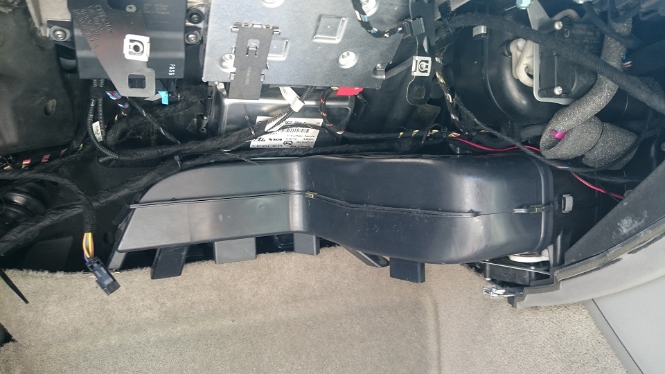

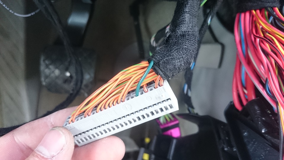

Harness sits on top of the air duct with the joint to the right of the red connector on the MMI head unit.
Headlight Range module connector
You will have here:
- two CAN wires from the headlights go to pin 18 and 19 (top middle row)
- two CAN wires coming out of the connector (bottom row to the left pin 2-CAN High and pin 3-CAN Low, Low and High rows are marked on the CAN separating connector by letters H and L) go to the CAN separating connector which is located above the driver side fuse box (LHD car), purple/black big connector.
- two wires going to the fuse box on the driver side (power supply for the Headlight Range module):
*Grey 1.0mm2 wire is the live
*Brown 1.0mm2 wire is the earth (any earth point on the right hand side on the chassis)

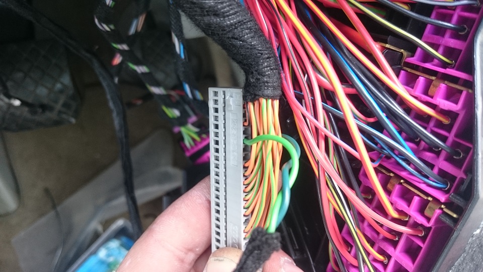

CAN wiring
pin 2 goes to pin 6 on the High side (6H) on the CAN connector
pin 3 goes to pin 6 on the Low side (6L) on the CAN connector
These are the terminal connectors you have to use for the range module and CAN separating connector
This is the CAN separating connector
That is CAN wiring done
Now the supply for the Range module.
Same principle and size of wires like for the right hand side fuses, but this module requires a small size fuse so single female terminal connectors must be used, not double width.
Fuse number 4 from what I remember, see chart on the back of the fuse box cover.
Top right red fuse with no white writing on the face.

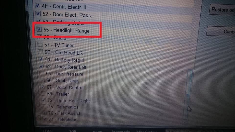

Plug VCDS in.
Go to CAN Gateway > Installation List > Tick Headlight Range
Then Code the headlights as per first post if you haven't yet.
