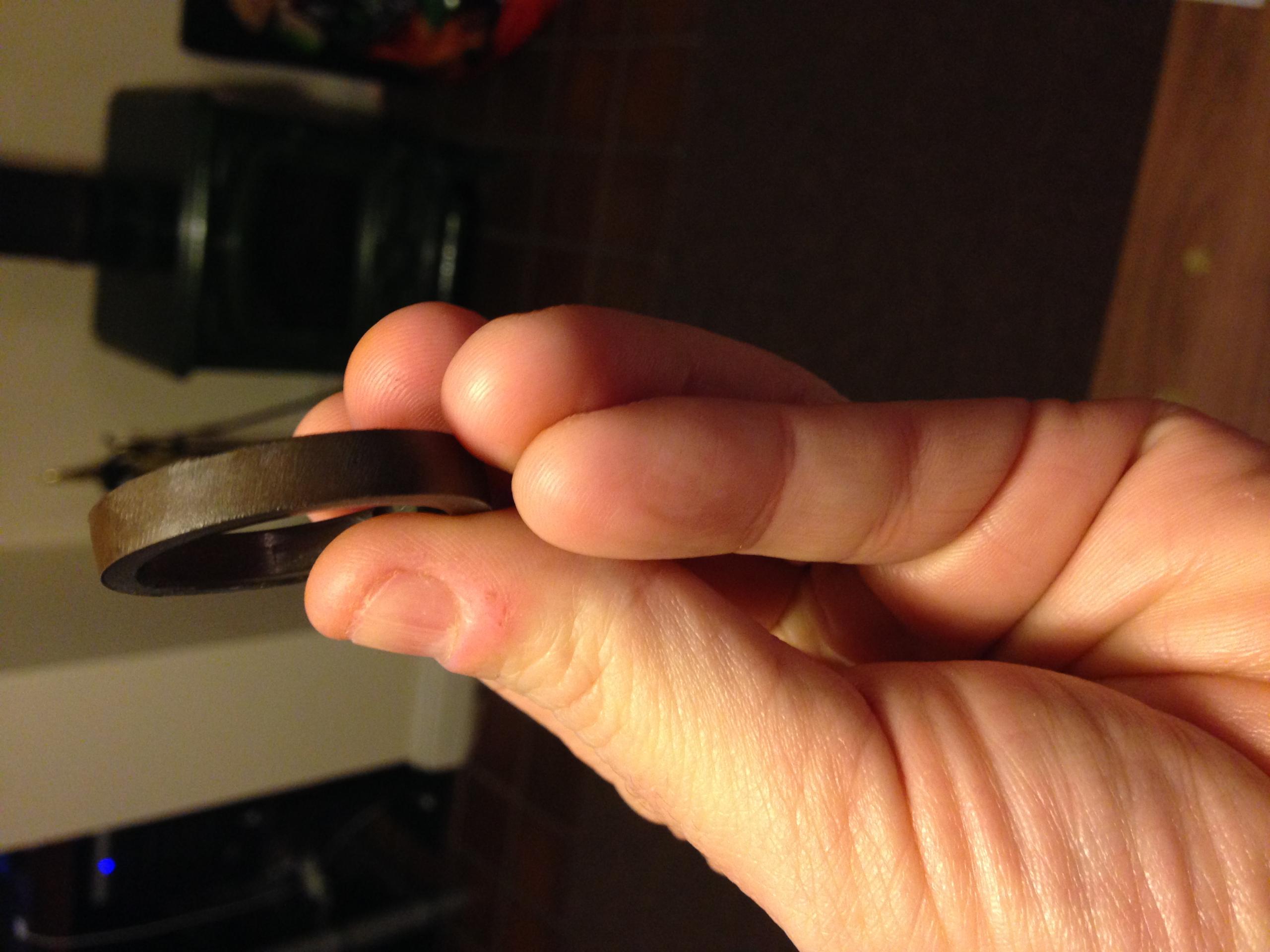

Spoke to the mechanic earlier, he has fitted the kit and the suspension is back to full working order. The car now raises and lowers correctly, I'll test it myself when they deliver the car back.
He is bringing the old parts back to show me how bad it was, apparently air was escaping around the compressor piston because of damage to the old part and that is why the pressure was low. I'll post a picture of the old part when I get it back later.

Here are the pictures of the old compressor part. You can see the damage, it should be smooth all the way round and mine had some nicks from the outside and quiet bad scoring. Air was escaping round the edge of the part as a result of the damage.
I was charged 3 hours labour, Rick had to spend sometime cleaning up the piston cylinder as it was in quiet a state inside. Suspension is now working great which is a relief until something else breaks.
