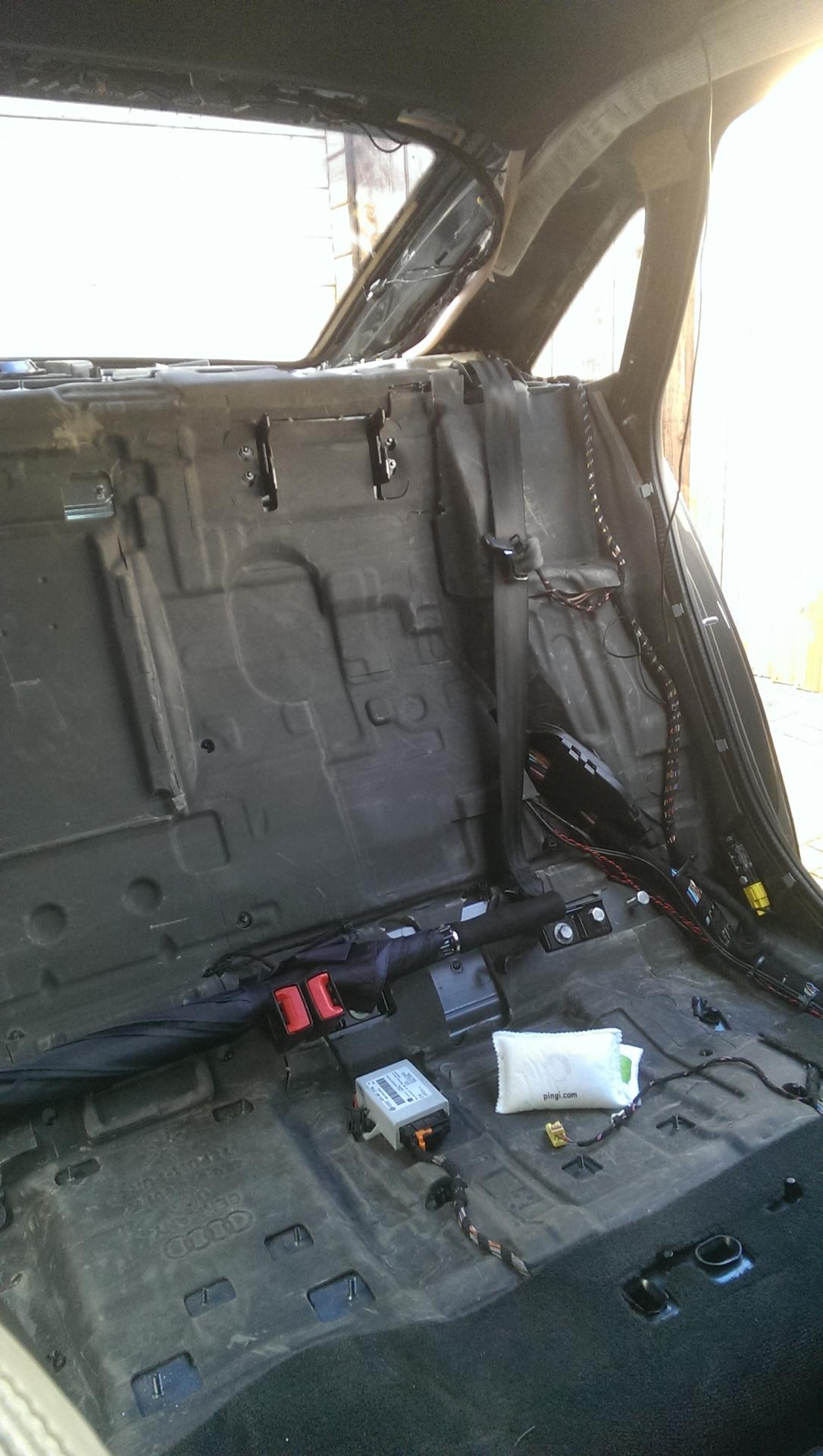

Old 16th May 2014, 10:39 AM
Did you add TPMS or repair fault units?
What was the fix for the rear screen misting up?
What's involved in a rear blind service?
I need to get my compressor done, Its kicking out 9bar.
My TPMS sensors had run out of battery as they only last about 6 years.
So had to replace all the sensors, at great expense.
The rear screen was leaking in through the sikaflex bonding and showing as condensation in the back window.
It was repaired by National windscreens but it meant stripping all the rear seats and trim out for access.
The rear blind had a habit of popping up when it felt like it and it turned out to be missing fastenings, as I replaced them and its fine now.

Old 16th May 2014, 07:20 PM
Good you sorted that before any serious damage becasue as most things (just not the dolphins ) these cars and electronics don't deal well with water inside the car.
