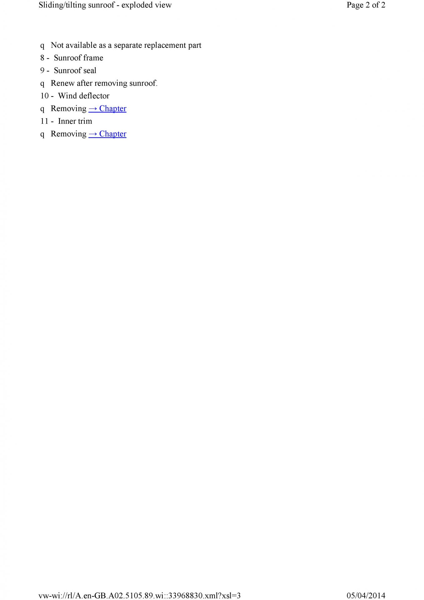

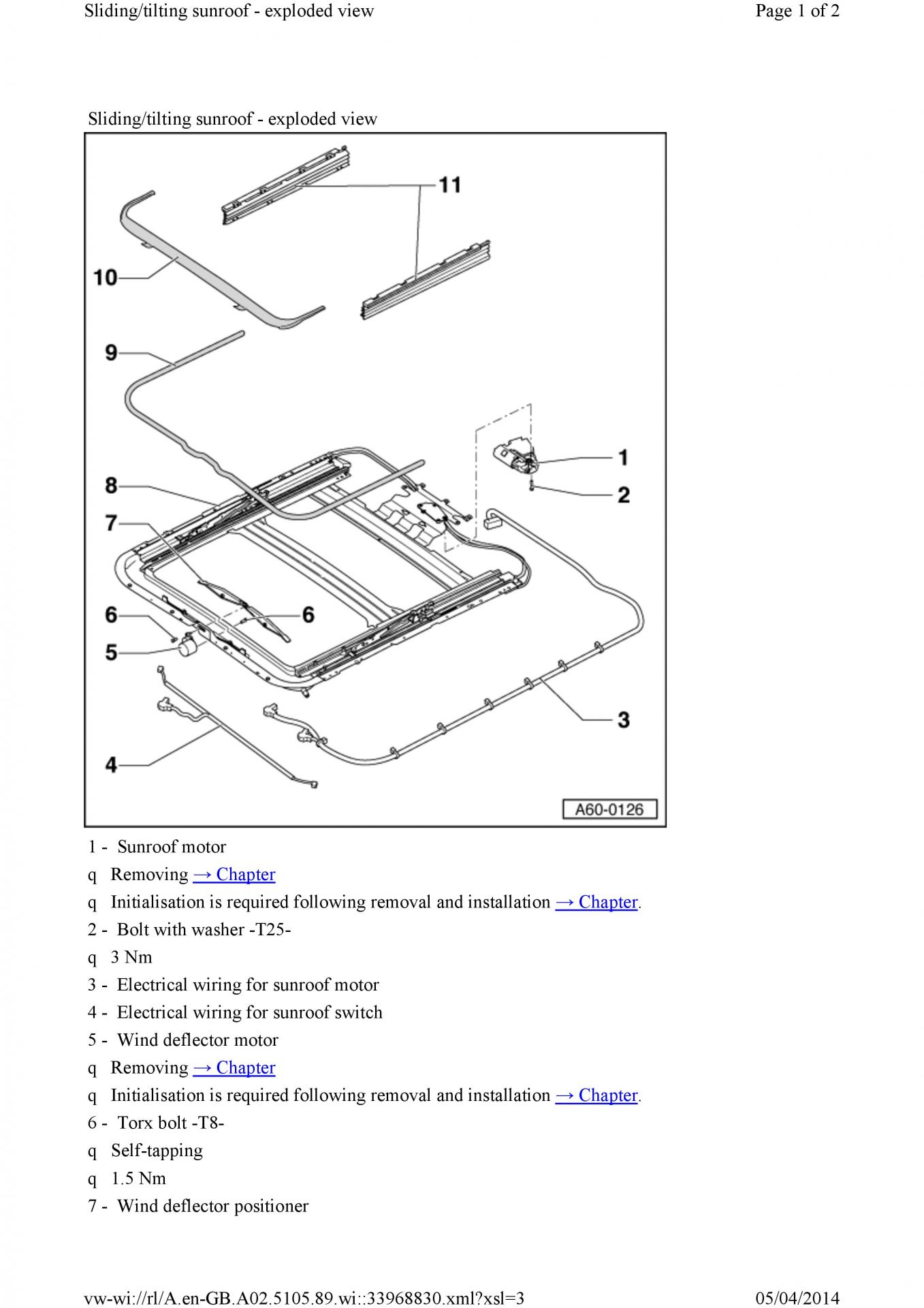

XPS files can be a pain to view.
Here's the JPG version (I'll stick with them in future).
ID:	7706   Click image for larger version
