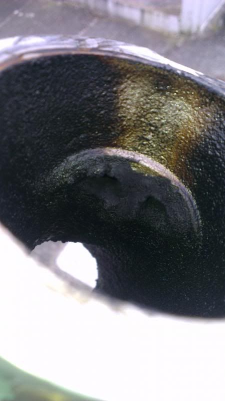

Gearbox oil was changed on the friday and I thought I'd spend the day trying to clear the EGR fault.
Removed this pipe.
Its dirty but it don't think it looks to bad.
The two holes for where the EGR gases come from looks bad but the air still flows through.
The throttle don't looks to clogged up.

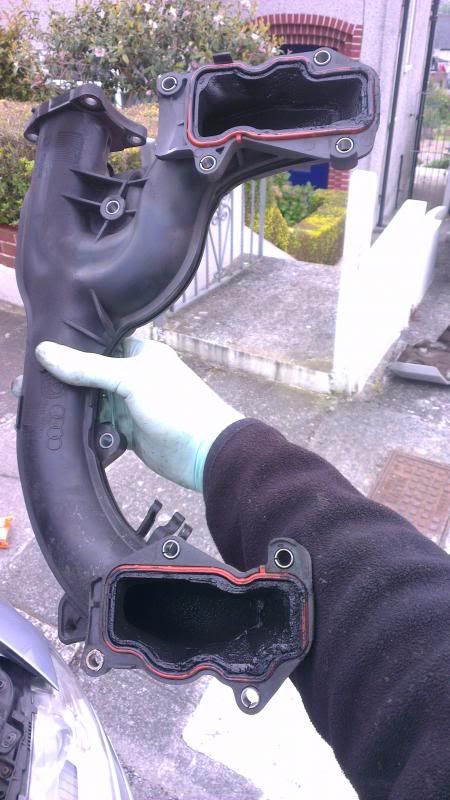

With that side looking semi ok, I thought I'll remove the EGR valve and check on that.
Removed the inlet pipes which looks ok. This all based on other pictures I've seen off other inlets that looked worse.

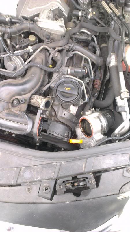

I then gave up at that point cause I broke this pipe.
Before I broke the pipe I could not see any way to remove the EGR pipe work or the valve to check it.
Anyone removed theses before?
I've been unable to get any tools into position to remove the bolts holding it together.
I might have to get some more Star and Torx bits to try again.
