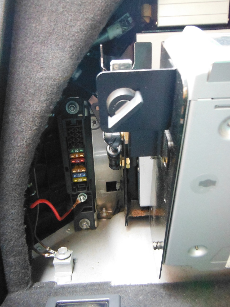

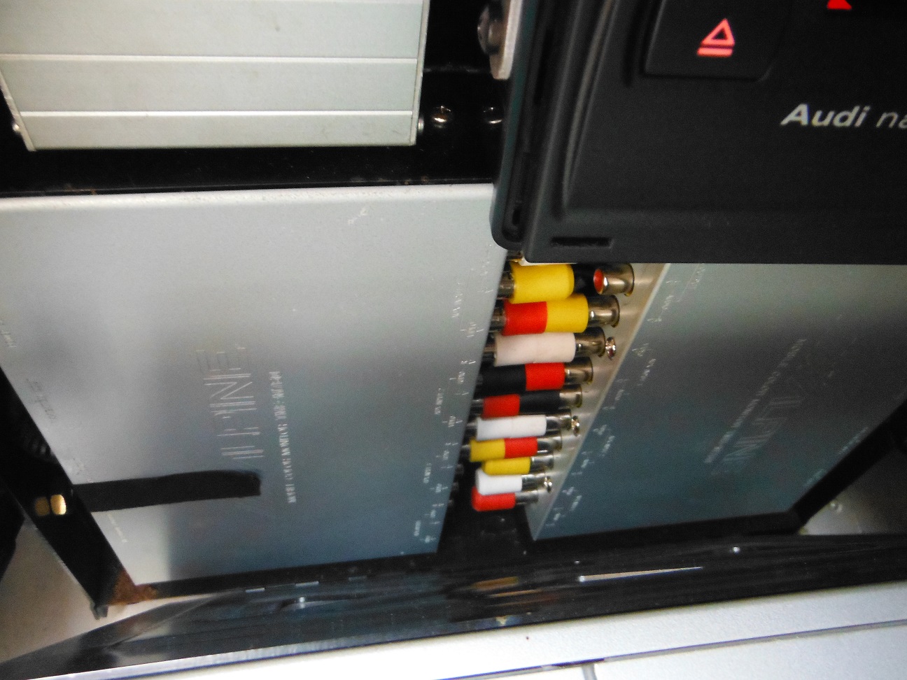

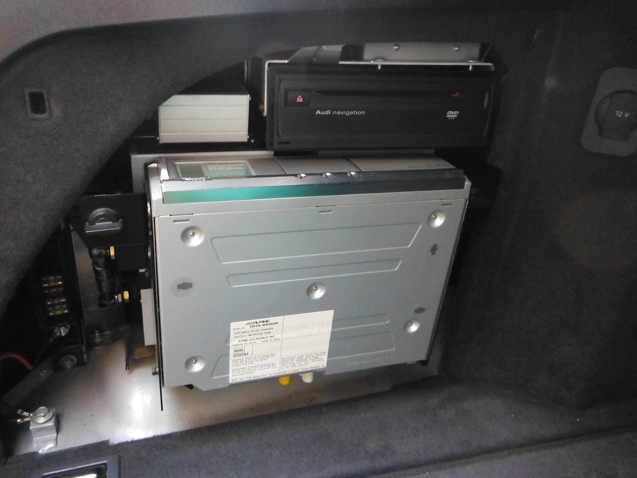

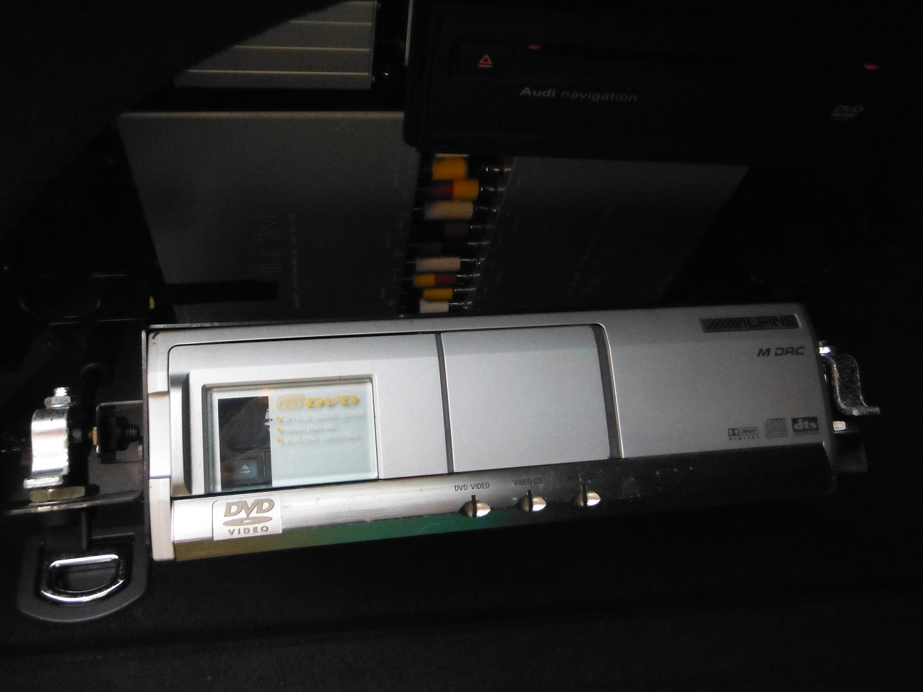

Are these photos any good Guy ?

Perfect !! I can see what I am missing it seems to be the small silver box to the left of the navigation unit I do have a small brown connector that is missing something to connect to and it looks like that is the missing piece of the puzzle
Question is what is it ? ....and its missing from the donor car ? Hmmm
