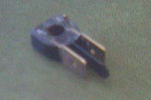

Old 10th May 2014, 04:36 PM
I'll try fishing it out to remove the exposed broken bits of the switch.
Got it!
No idea how this fixes to the main part of the switch though.

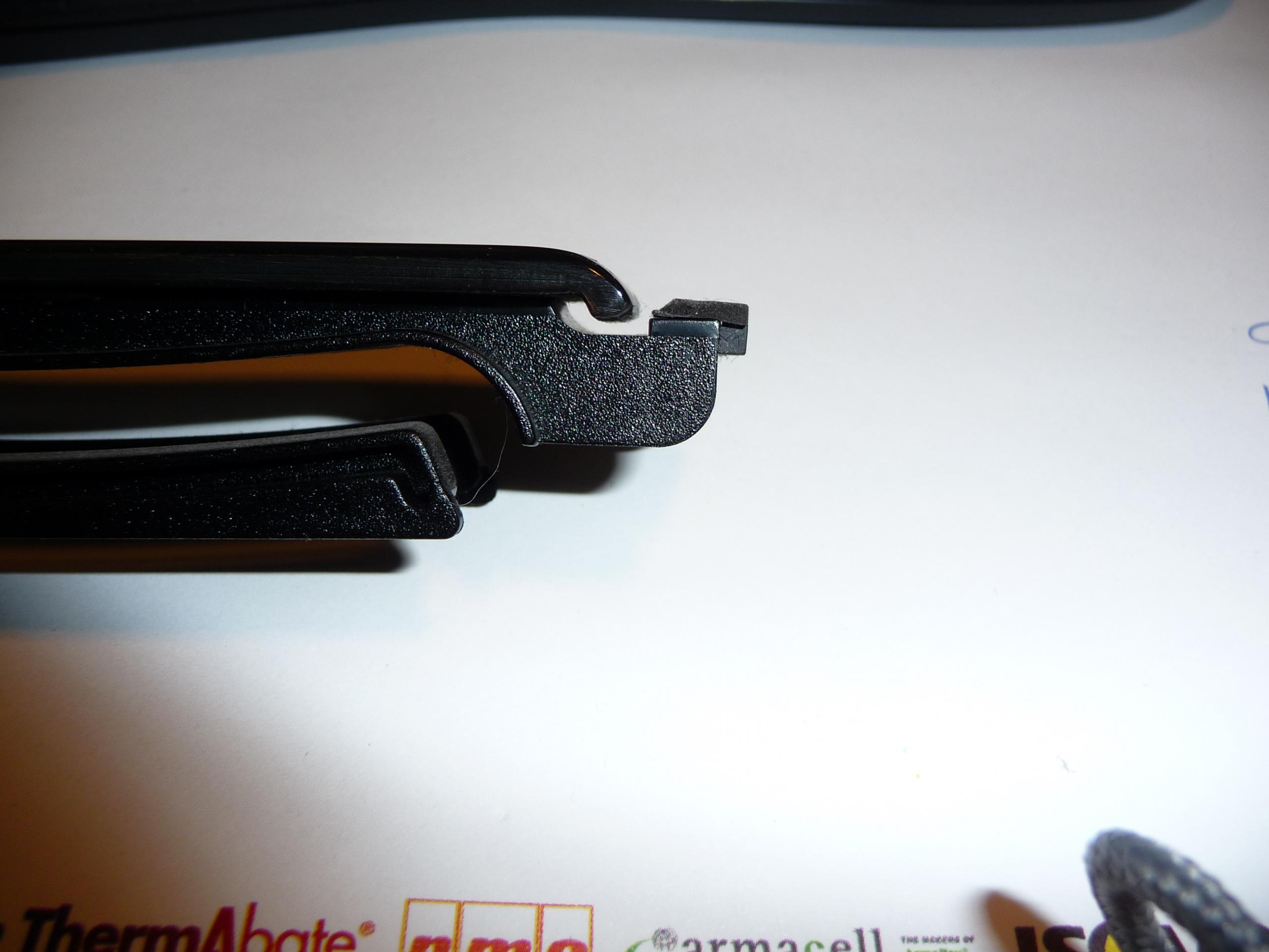

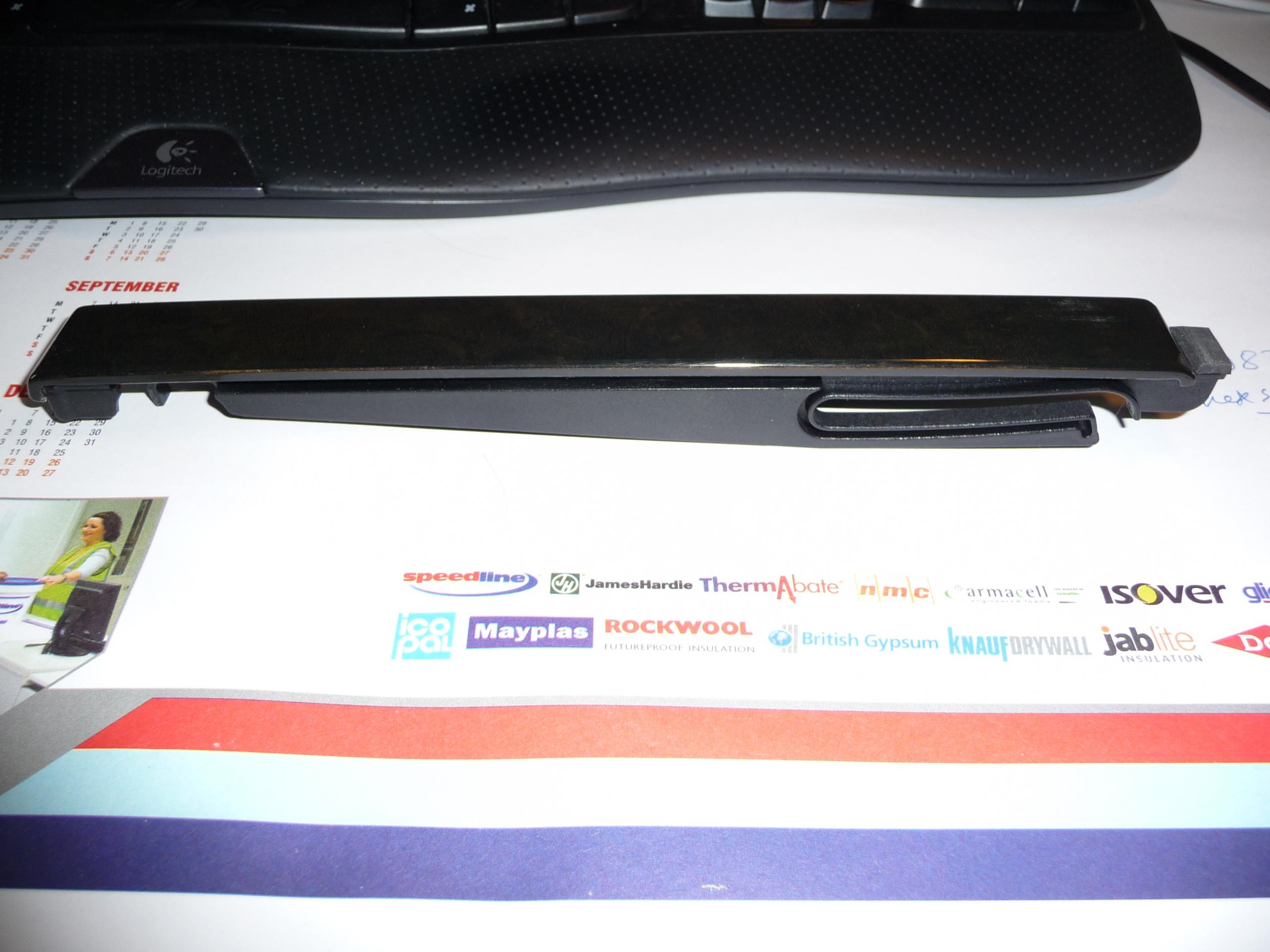

Old 11th May 2014, 09:28 AM
I've attached some pics of the brand new handbrake trim I've got here so you can compare and see if there's bits missing or not
ID:	8032   Click image for larger version
ID:	8033   Click image for larger version
Old 11th May 2014, 09:43 AM
Thanks Adrian, nothing missing, just extra duct tape "padding" inside the "cup" of that strange downwards protruberance at the front end that gets gripped using the pinch bolt.
As noted, I'm going to "improve" mine by adding a thin piece of rubber instead.
