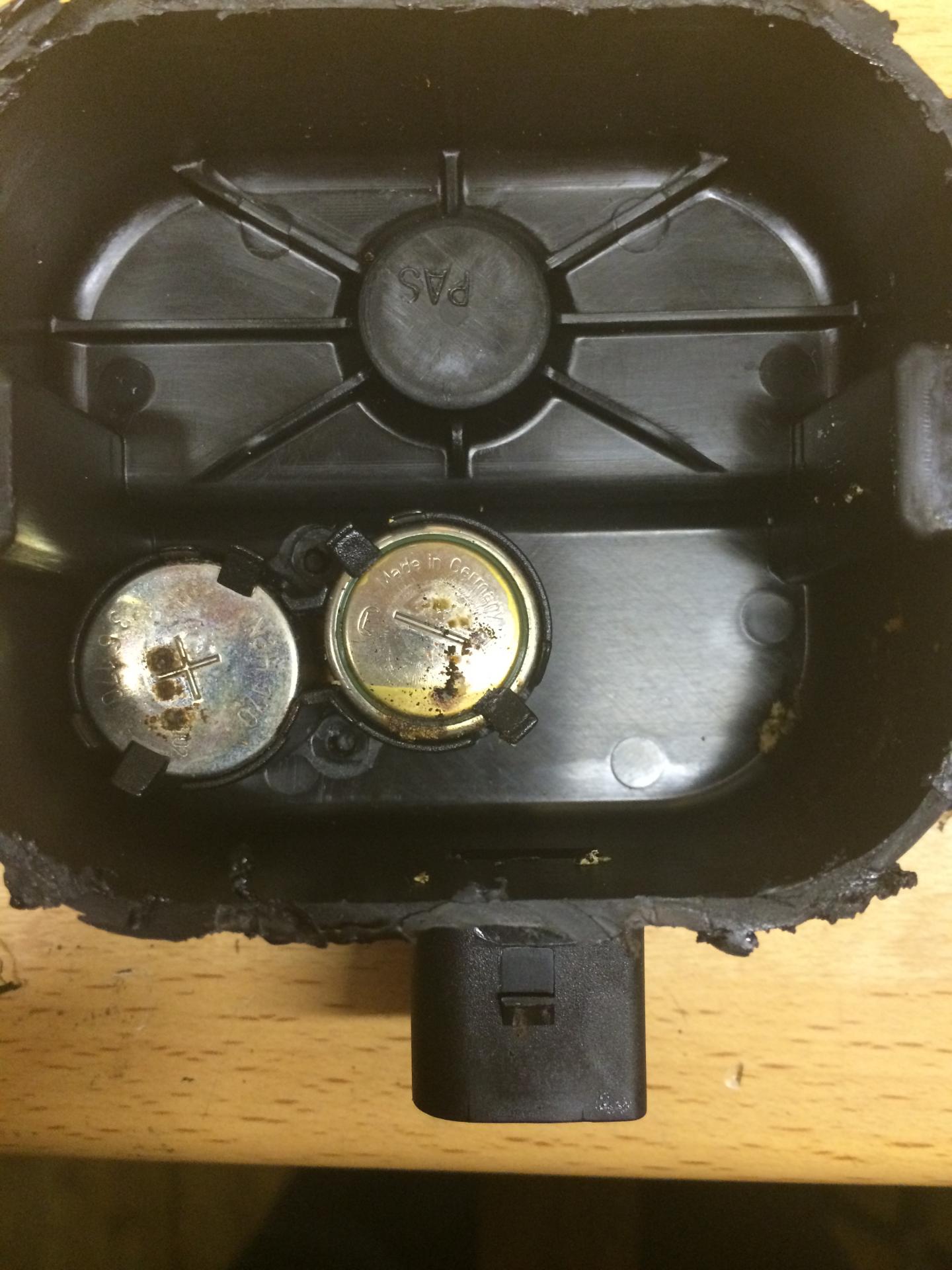

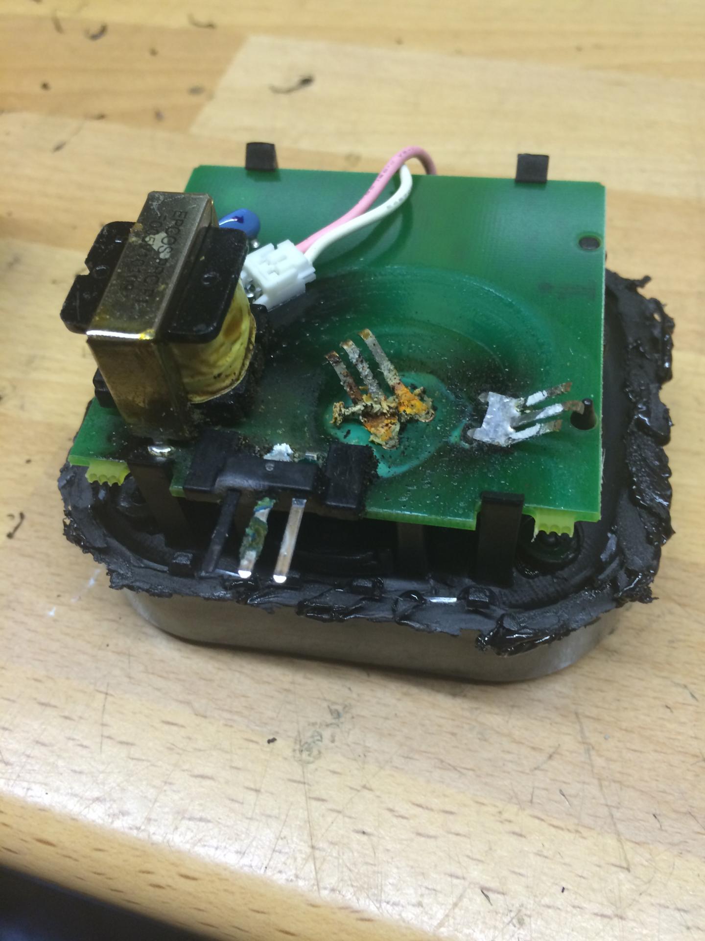

Cut the case open on the old module, just to see what state it was in and this is what I found - basically 1 leaking cell has done a fair bit of damage for a relatively small leak. Cell seems to have swelled as well.

Thanks guys. I removed mine and fixed it. It did't leak well enough to damage the board seriously. I will now need to buy batteries and a laquer to spray on board to brotect it again, which I washed with white spirit to remove the leakage, which damaged original laquer. I'm going to drive without batteries. I'm thinking to extend wires out of the siren and have battery in another place which is easier to control. It will also give me a bigger choice of shapes and sizes of NiMh batteries.
