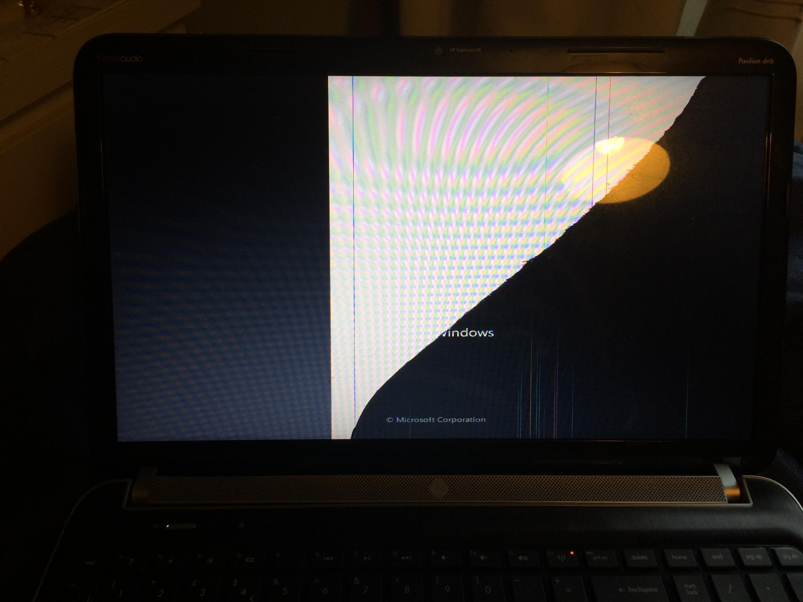

Thanks for all the advice gents - I knew there'd be plenty of experience on here! This is only the 2nd laptop I've ever owned for personal use - my old Vaio lasted 10 years and this one I've had for 4 years or so. I'm generally pretty gentle with my stuff!
My mate who sat on it some time ago weighed North of 100kg at the time and didn't even notice he'd done it till I asked him where he'd moved the laptop to when he sat on the chair.....answer 'nowhere'
Have attached a couple of pics - I couldn't get it to show, but with the screen off you can see a line diagonally across the screen so it's defo cracked. Have connected it to an external screen and it works through that.

Old 13th October 2014, 08:52 AM
I just had a quick scan of that video and note that the guy says for earlier models you had to take the laptop apart significantly just to get at the screws retaining the bezel at the bottom.
So I guess that's why you thought you needed to do all that work, but it looks like you're lucky and won't need to.

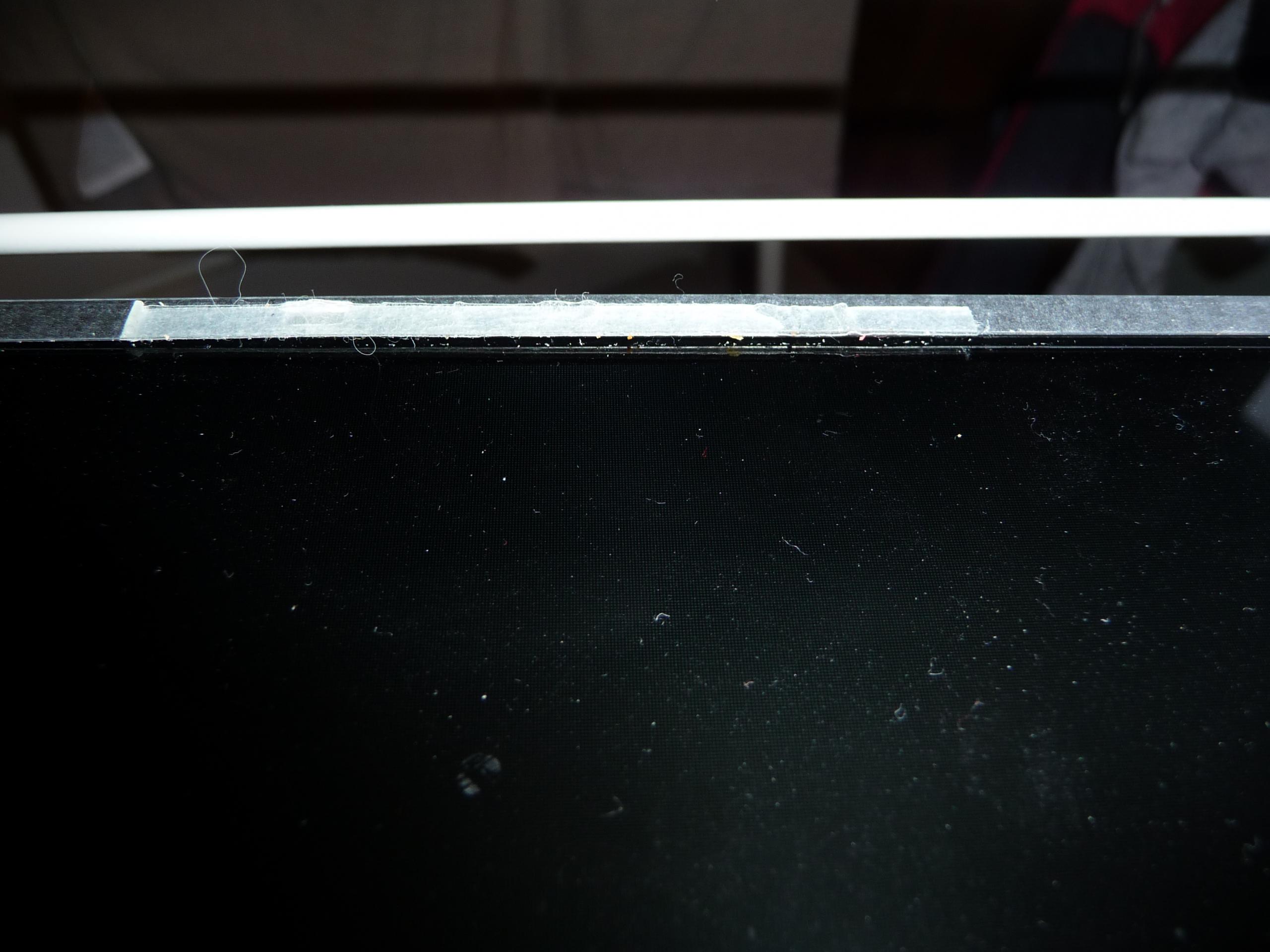

Does anyone know what the really sticky narrow double sided tape, that feels a lot like the stuff they use to seal junk mail or attach bank cards to letters with, is called?
In the pic attached it's the translucent stuff on the metal frame of the screen.
I've tried removing it from the old screen to re-use but it's just falling apart. Given I've broken a clip or 2 I'm keen to make sure there's enough on there to keep the bezel fully home, otherwise my OCD will get the better of me!

Old 15th October 2014, 08:30 AM
Use this Adrian
http://www.ebay.co.uk/itm/5mm-Double...item3ce3eac732
They do 1mm, 2mm, 5mm and 10mm as well, but yours looks like 5mm.

Old 15th October 2014, 08:51 AM
Cheers bud - have ordered some of the 5mm stuff from the ebay link
The side of the screen is 5mm wide so that's perfect. I can use a bit more than was on there to make sure the bezel stays in place where the clips have broken!
I fitted the new screen last night - it turned up earlier than expected - and it's working perfectly but have left the bezel off for now as don't want to keep trying to prize it off the new screen!
It's definitely darker on full brightness than the old one, but ran a few tests and there's no dead pixels on delivery and the picture quality is good so I'm happy
