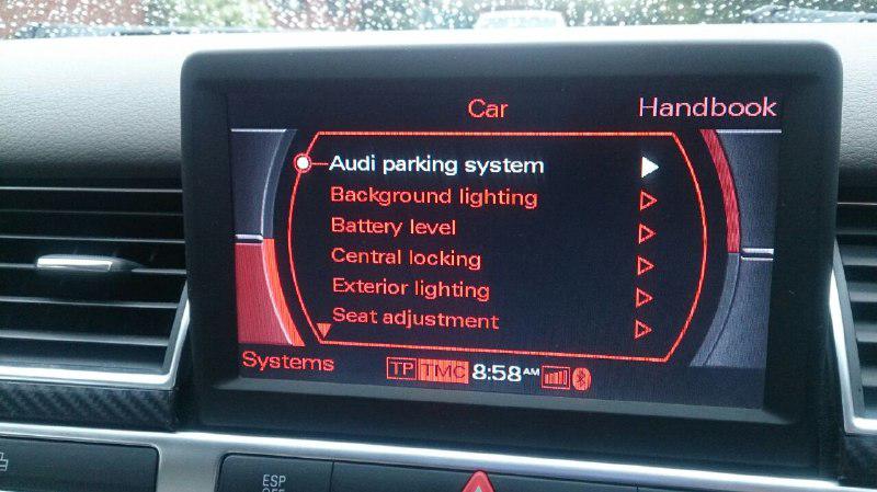

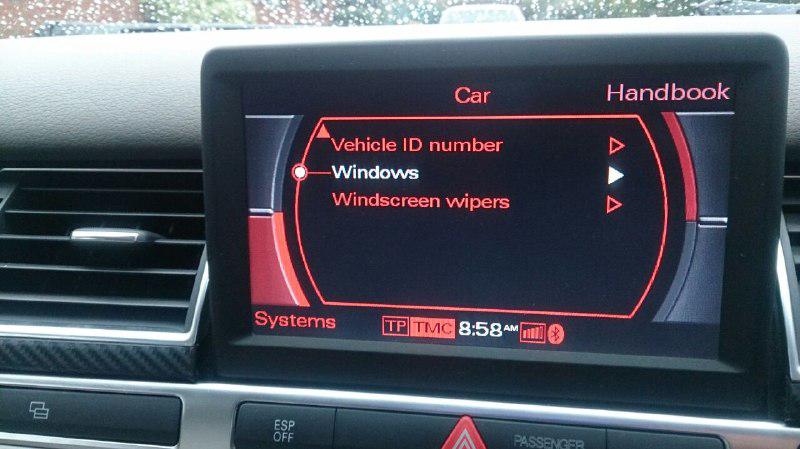

As above, USER option is available only in cars with finger print recognition
On my 06 2G MMI ver.5570 I have Audi parking system and interior lighting

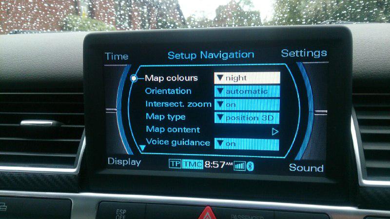

3D maps very available from early years, but this option is available only in later versions of MMI
To switch to 3D press NAV and then SETUP button on the MMI console
You will see option of MAP TYPE
MMI 5570 (CAR and then SYSTEMS)

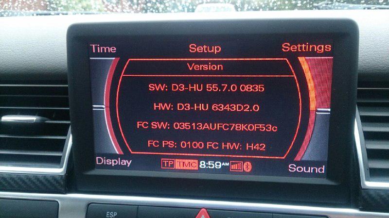

It would appear I have 21.2.0.
Time for a update I think.

Originally Posted by mannyo View Post
Chris
I assume the parking sensors are working ok.
If the car does not have keyless ignition then there is no user menu, instead it uses a combination of the keys and the memory buttons in the fold out door storage.
There is a hidden menu where you can add and remove options from the car menu, however it is possible to break the MMI altogether if you select the wrong thing. From the car menu, press and hold car and setup at the same time and a menu should appear.
http://car-tutorials.blogspot.co.uk/...reen-menu.html
Do not select anything in the menu to do with bootloader, it will end in tears.
Cheers Manny.
Yes - the car has fingerprint recognition and the parking sensors do work.
I'll give that hidden menu fix a try .....sometime soon.
