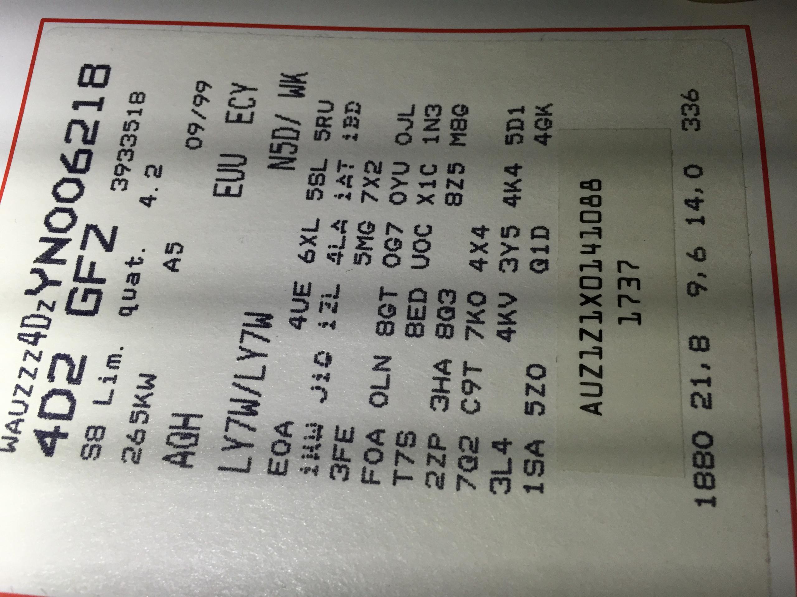

So according to service plan my cars weight is 1880 kgs?
If so, then the government surely lost quite alot of money when this came to Norway and taxes where paid of 1750 kgs

Yup, sorry to dissapoint you. Audi's service book weight is always without driver, with all fluids. I tested mine on a local weighbridge for trucks, and at a race shop on digital corner scales. It is quite correct I'm afraid.
European governments happily under report weight. On the previous forum one of our famous members from the Netherlands, Sven, had his auto S8 registered at a very low 1725kg. But the Audi service book weight was much more.
I don't know why they do this.
If you can find a friend that will corner weigh it for you for free/cheap it would be interesting to confirm. Alternatively, go to your local waste disposal site, they should have a weighbridge for trucks, and will charge you £5 to weigh your car. Accuracy probably wont be great, +/-10kg?

Maybe the government weights are without fluids or at least an empty tank.
90 litres of petrol, an engine full of oil and a full washer fluid bottle and cooling system adds up to a fair old bit.
