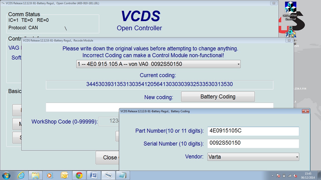

Back on it today
Checked all fuses ,all ok
Recoded battery double checking my bat control module part no ,see attached pic,
Part No.4E0 910 181 C
Bat Serial- 0092S50150 ( BOSCH S5 110AH )
Selected Varta as manufacturer as Bosch wasnt listed
Then done auto scan (unticked use CAN Only)and cleared codes , tried starting , just turning over ,nothing ,allthough cranking healthily
Run auto scan again (unticked use CAN Only) and it looks like it has cleared the old codes that were on the last read.

Also checked fuel supply to injectors and there is fuel while engine is cranking.
Dont know whether recoding the battery or unticking use CAN only sorted out clearing the error codes??
Still not sure if i have coded the battery properly , never done it before ,can anyone comment on how i have done it.
Thanks in advance

pic
Name:	Bat Coding.jpg
