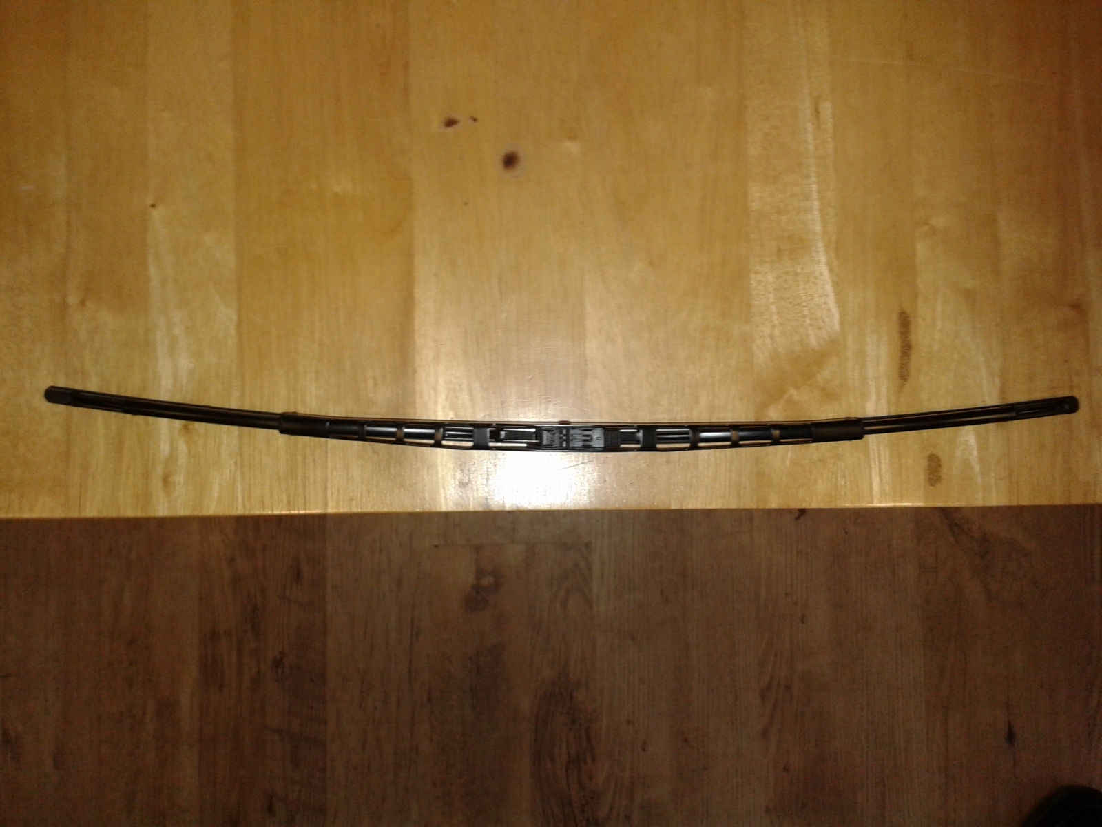

Old 18th December 2014, 10:32 AM
It's curved when you look at it from the top.
Edit
Here is the picture of curved Bosch blade for D2 & C5

Old 18th December 2014, 10:52 AM
Well, that's something new I've learned!
I don't think I've ever seen a wiper blade curved that way before. I always assumed people were referring to a curve that curves with the surface of the windscreen.
Why would you need one that curves like that? All my D2s have always had straight blades.
I presently have a pair of these on my D2 S8 (one 21" and one 22"), and they work great:
http://www.amazon.co.uk/gp/product/B00CXJZ330
Better picture of one: http://i.imgur.com/aOjZnNC.jpg
