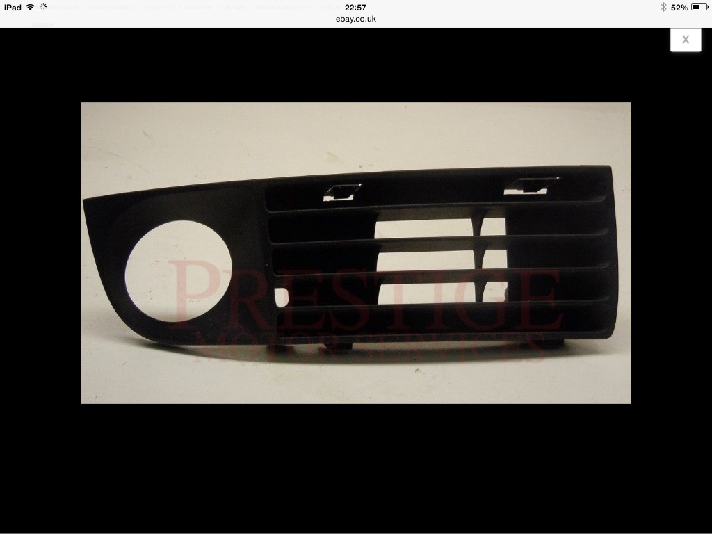

I think most at that time were one piece they look very different so you can see the vertical line to the inboard side of the fog light where the 2 pieces join up if you have earlier ones whereas the later ones are obviously all one piece. I'll try and get a pic of my earlier ones and post it for you. I would be pretty sure you must have the later one piece grilles as they changed about year 2000. If that is the case the part numbers you need to search for on ebay etc are -
Audi Part Number: 4D0 853 636 For the RH Grille
Audi Part Number: 4D0 853 635 B For the LH Grille
This is the later grille -

The fog lights are actually made by VALEO and I found a pair on ebay by searching for the part codes which are -
LH FOG LIGHT. VALEO Part 89395129 Audi Code 4D0 941 699B
RH FOG LIGHT VALEO Part 89395130 Audi Code 4D0 941 700B
If the brackets have broken tHen there's a good chance that someone has clobbered the front bumper on a low kerb at some time which tends to break them, if that is the case then they may also have damaged the large side bumper mounts which look like black plastic plates, in which case the front bumper may not pull in correctly to the arch to line up nicely
