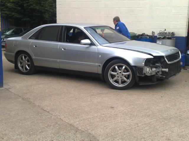

Yes, I did drive it the 11 miles to the air con specialist looking like that, I did reattach the bonnet though.
Getting degassed

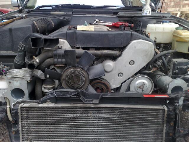

Radiators off in this picture, its just leaning up against the car
On the weekend I rekon it will be treated to a full paintwork correction detail as a treat, expect to see this little monster at the next annual meet, complete with its new S8 front grill

Going along nicely. Just in case you missed it in this picture
you can see that the engine needs a damn good detail and it's a great opportunity to do it!!
