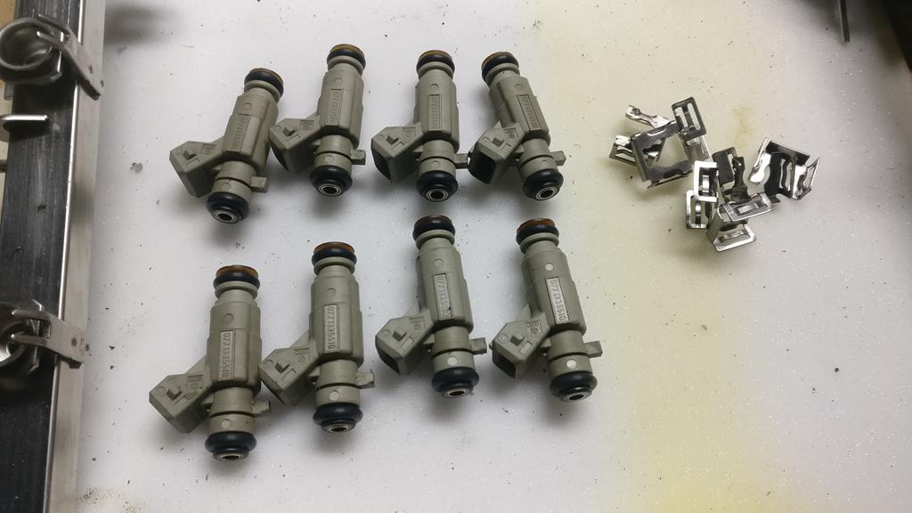

Master Injector confirmed I had the right parts for the injectors and the different filters are just a later revision so I was able to finish them off

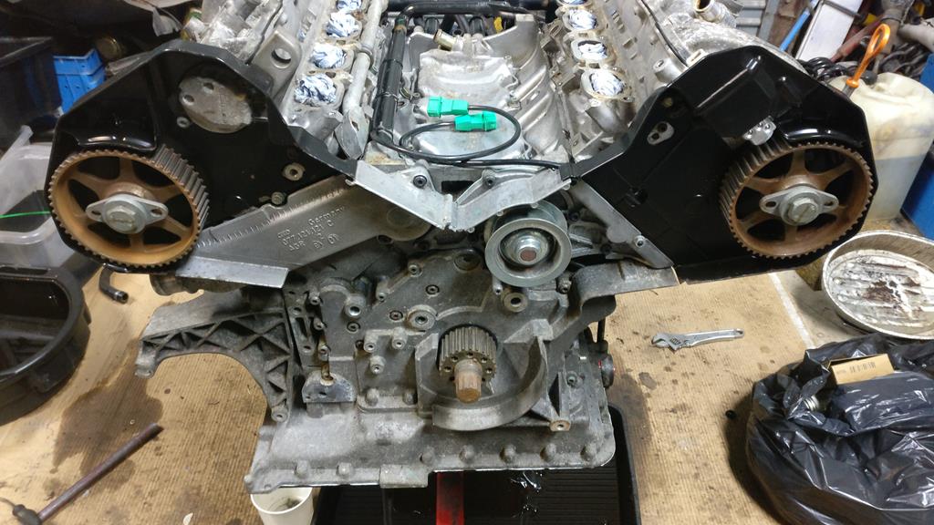

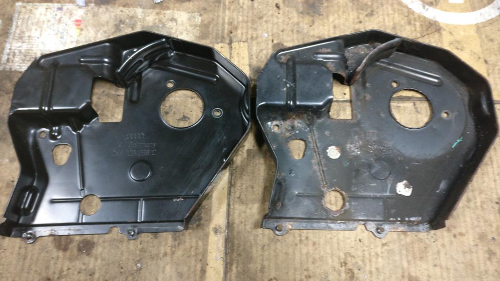

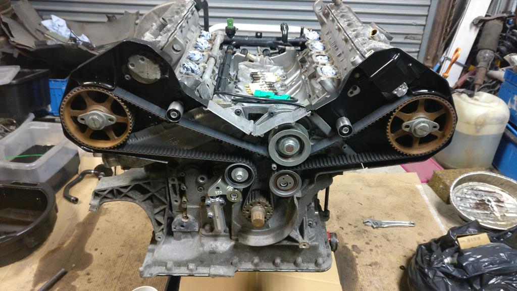

Original belt back plate on the right. I'll replace them with a better pair, and recover the old ones when the weather is better
Ready for the belt
Belt fitted

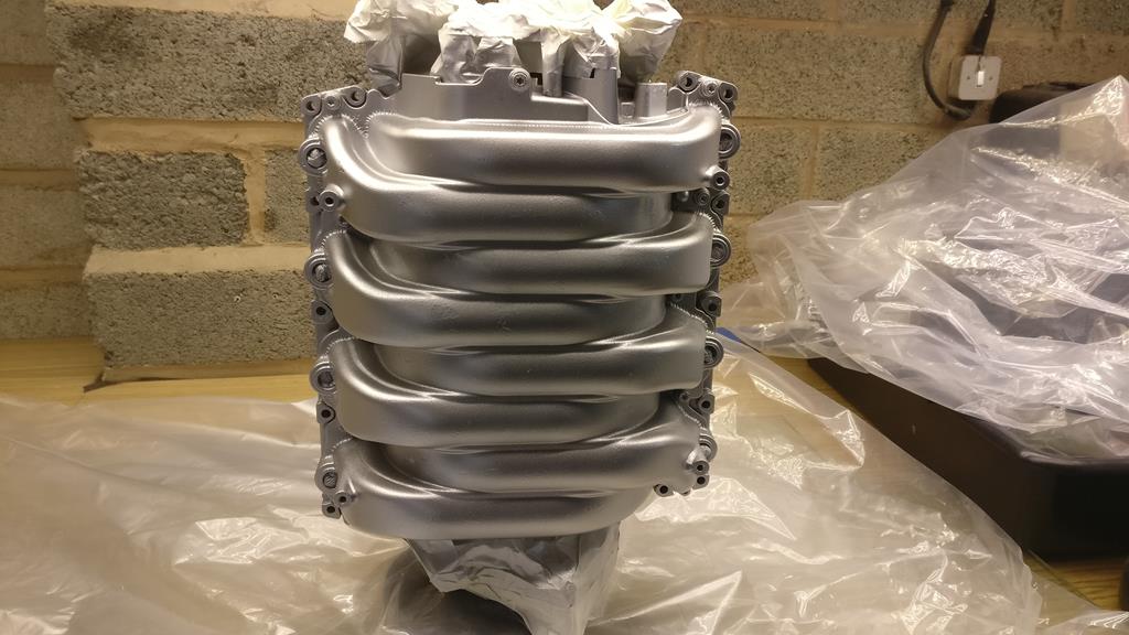

I got the inlet manifold painted while doing the belt

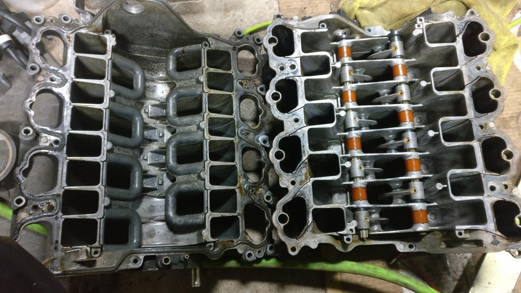

Took the old one to bits, just to see what's going on in there. I've seen pictures of this before but never had hands-on one. Its insanely complicated, made of six different castings all nested together, with the two halves ineffectively sealed together with a weird moulded silicone gaskety thing. The castings are also glued together with silicone so its tricky to get it apart any further than this by hand...
Looks good, next you will be painting uprights and shocks!!
Ineffectively? I wonder how the design engineer managed to describe the process to the accounts department who had to sign this off
Paul

Hans, you have requested 1 million Deutschmarks for pressure die cast tooling for production of a <squints at paperwork> an inlet manifold?! Explain yourself!
Well sir, we noticed the inlet manifold on the 32V V8 is a simple sand casting, which is easy to make, and never fails. We suspect they will still be working decades after the warranty expires.
<general muttering of discontent>
So, we have devised a new inlet manifold of such awesome cunning that we can claim it is progress, but at the same time introducing many new failure modes such as unexplained air leaks, flaps seizing up, and paint peeling off which will start just after the warranty runs out, thus causing the owners many wasted hours of fault finding and unnecessary maintenance.
<applause breaks out>
Well done Hans, its not quite as fiendish as Simon's cam chain tensioners, but funding approved!

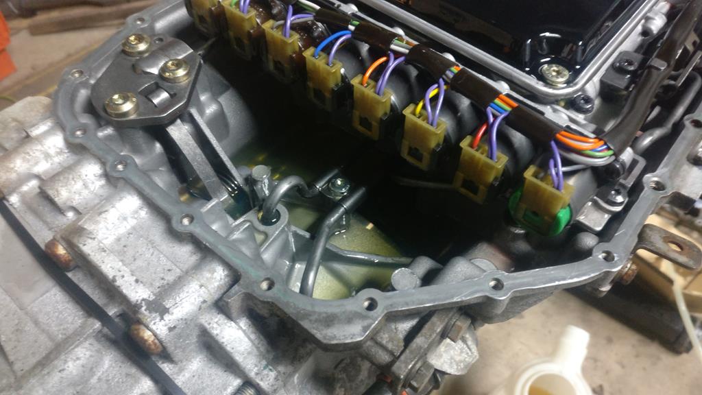

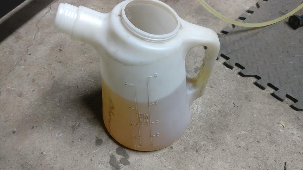

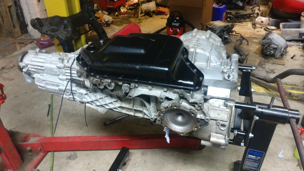

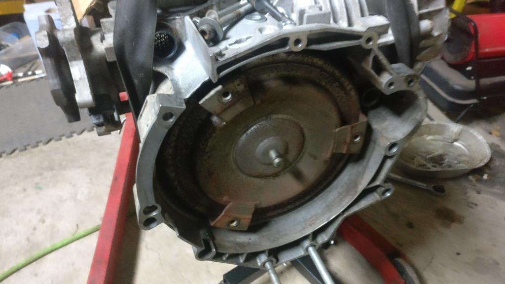

Gearbox this evening. I've taken as much red ATF out of the torque converter as possible (2.2L) so put it back in the gearbox so I can refill it.

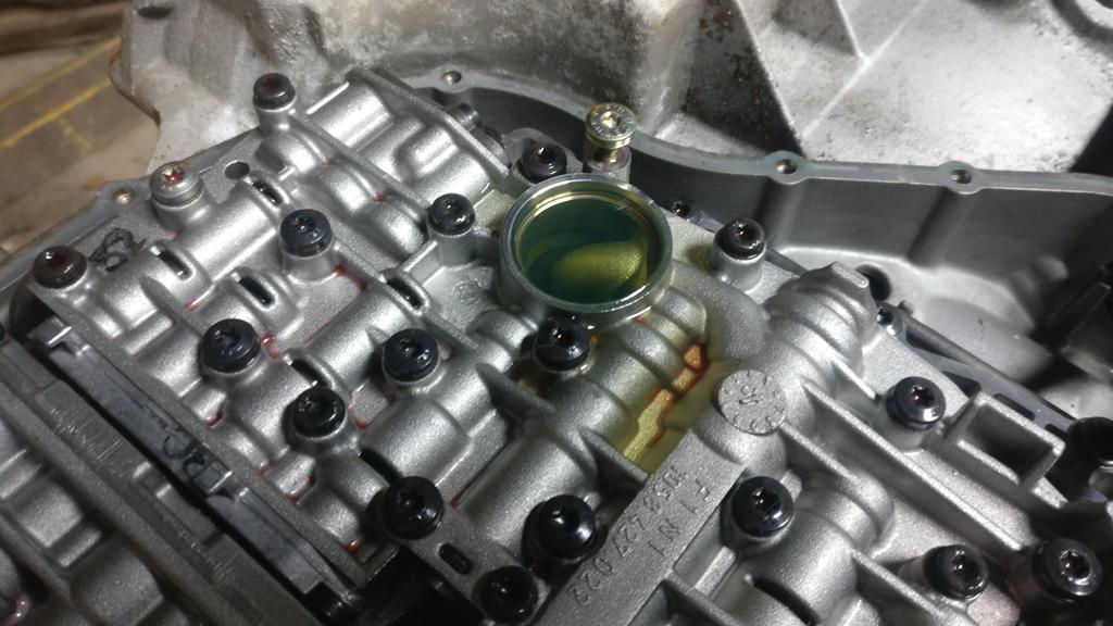

Primed the pump

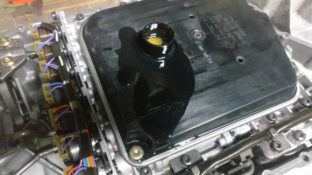

then primed the filter
Then I had a great idea! Since I have all the breather ports bunged up, I could put 8 litres of oil in it while it's upside down, put the sump back on, and flip it over. That will save ages compared to pumping it in through the oil cooler ports
I put a cable tie and a support round the bung just in case
There we go - 8 litres of oil, plus one in the converter. That should be enough so that on first start it is slightly over filled and I can pop the fill plug out and let it drain to level.

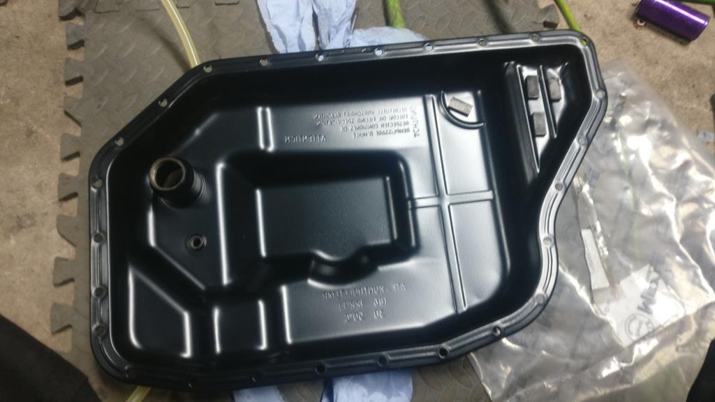

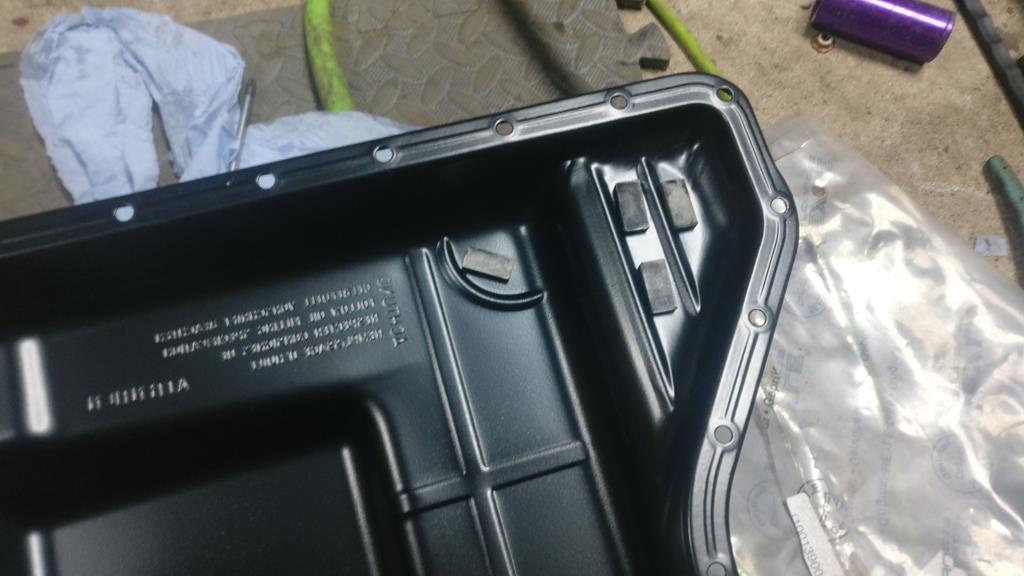

Freshly powdercoated sump
Magnets back in the correct places
Installed
Its not leaking so it can sit upside down overnight while the solvent flashes off in the sump sealant, and I will flip it back over tomorrow.
